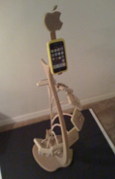

Don't leave it flat. Helps with dissipating the heat. You don't have too, but keeping the phone cool is a good idea if possible.
Ok, now i see what you are saying, expose the most surface area for better cooling. I have laid it in front of a fan at times. I was literally thinking you meant a change in elevation, height from ground. My bad, LOL 🙂
[doublepost=1486218579][/doublepost]
Is that like a prayer stand? New type of golden calf.
