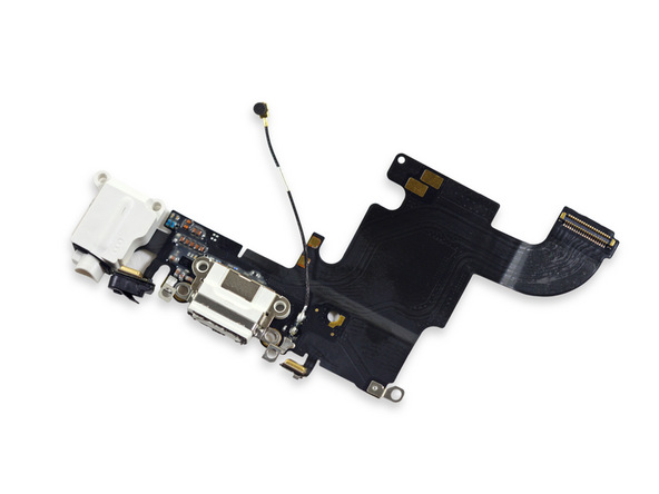

Right, because in a brand new form factor they can't move internal components around? And there's no chance they will engineer a custom battery like the one introduced with the retina MacBook (below)? But moreover, you do realize the headphone jack sticks up several millimeters above the Lightning port. At a minimum, the exact same battery in the 6s can be pushed down a few mm into the space the 3.5mm hardware is currently, without touching the Lightning hardware, and opening up an equivalent space above it to accommodate something else.

Dx5cSswRDaQAW3L2.medium
6s Headphone jack sticking above the Lightning port.
