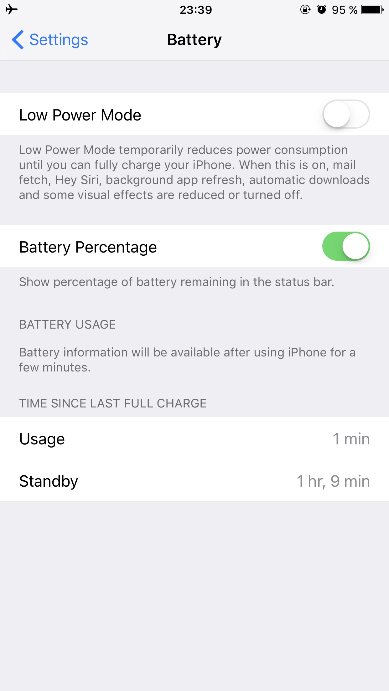

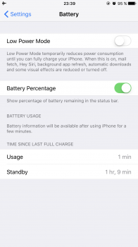

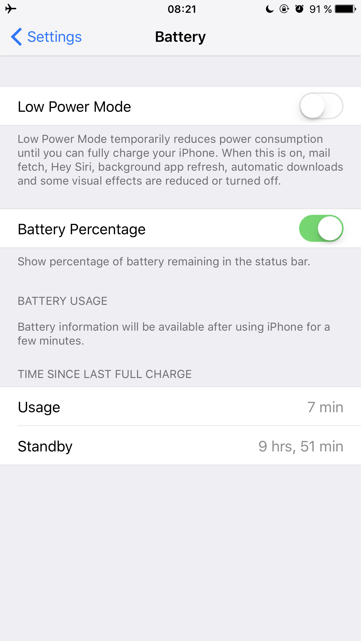

Well, I've DFU restored, only turned Battery percentage on, didn't log into iCloud or download any apps, set my phone to Airplane mode and left it unplugged overnight.
Here are the results. I think 1-2% would've been reasonable, 4% seems a bit too much IMO, especially when Apple is advertising 16 days of Standby!(4%/8hours -> 12%/day, which means it would last more like 8 days, so about half of what Apple says it should)

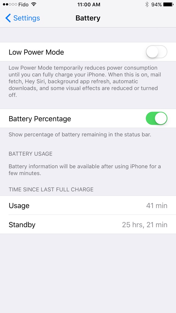

For info, my battery data suggests my usage since last fill charge has been 1 hour 4 minutes, and 12 hours 31 minutes on standby.

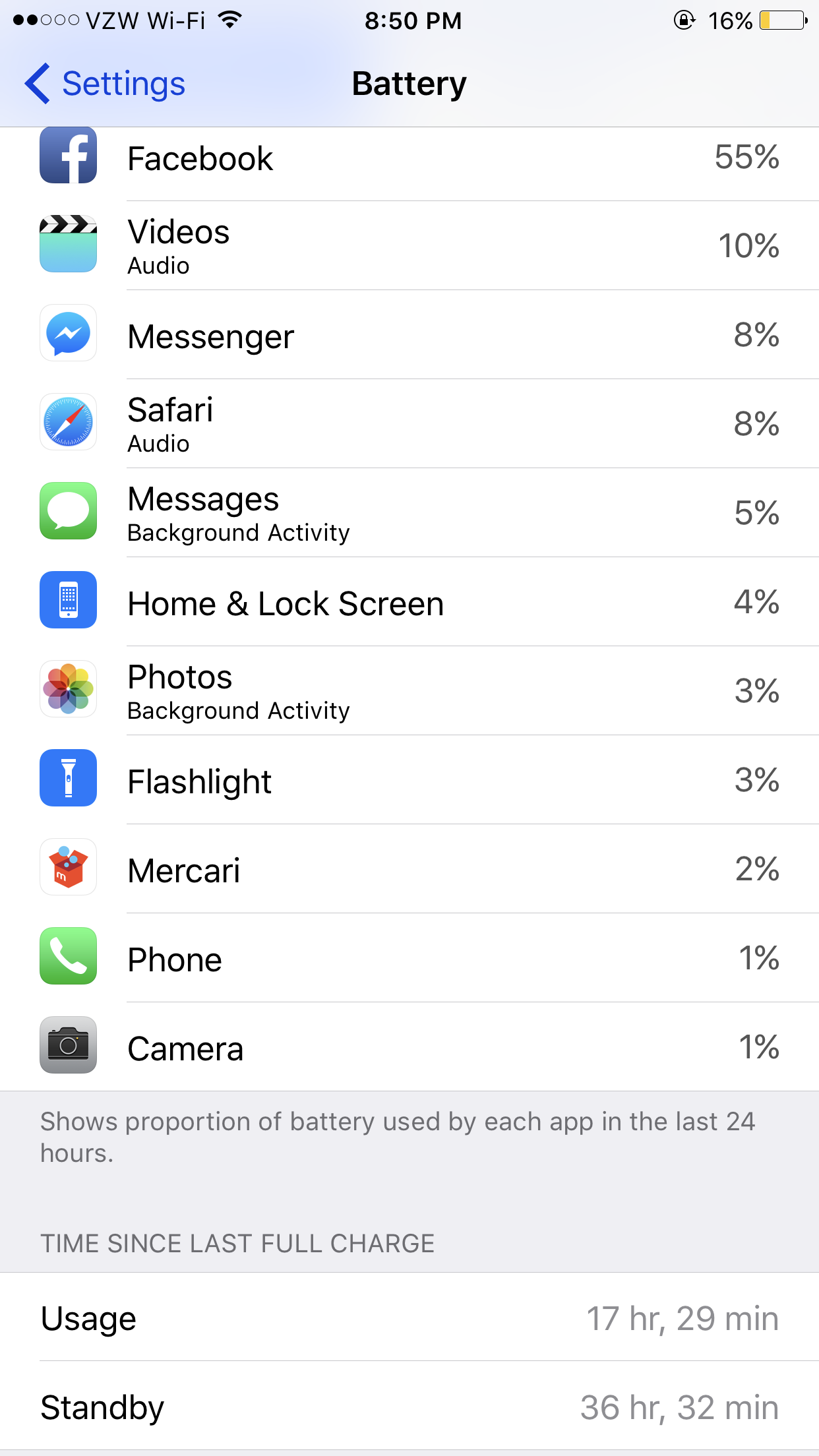

I'm having a similar problem with my 4.7" iPhone 7. I felt the battery was draining suspiciously fast while in standby although I can get through a day on one charge fairly easily. I tested it twice overnight and it drops around 2% per hour which seems a little unusual. So an average night I sleep about 7 hours. About 14% will be drained from the phone doing nothing by the time I wake up. I scheduled an appointment with the Genius Bar next week.
Thats not right, my iphone 7 plus - Verizon - Matt Black - 256 gb model goes from 10 PM to 7 AM with 0 battery drain.
Its fantastic, no battery drain at all. This is every night. I love this phone. 100% at 10 PM and 100% at 7 AM.
