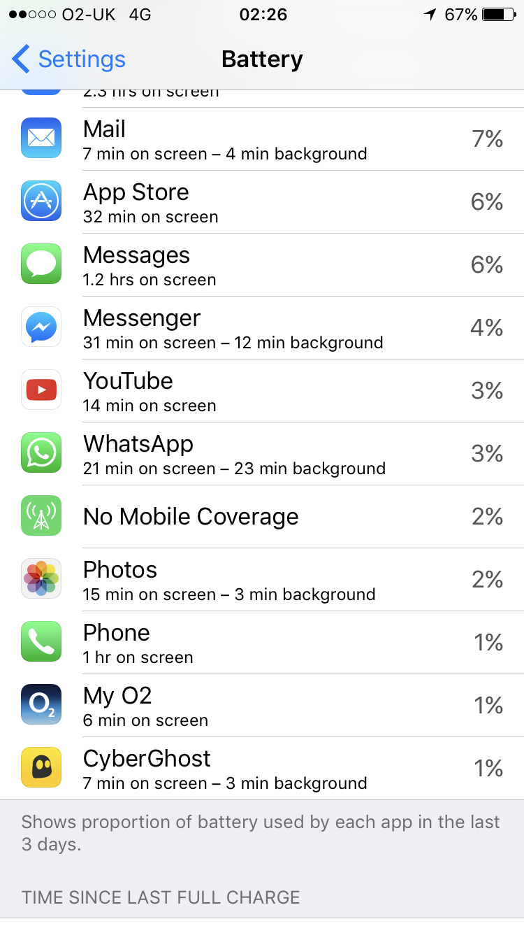

Under Settings - Battery: If you click on Messages to get the time, you will see that there is a Background time, even if you don't open the app at all. Over 24 hours I had 4 hours of background usage from Messenger without opening it once.
Yeah mine doesn't really use much background time maybe 15 minutes over 24 hours if I don't close it in the app switcher 😉
I find WhatsApp uses a little more though if I don't close it after use
Last 3 days..
Last 3 days..
You are lucky! Seriously. I've tried downloading the app every week or so for the last year and after 2-3 days I end up deleting it because it just drains.
Strange! I will try deleting it for a few days though to compare battery life as a test
