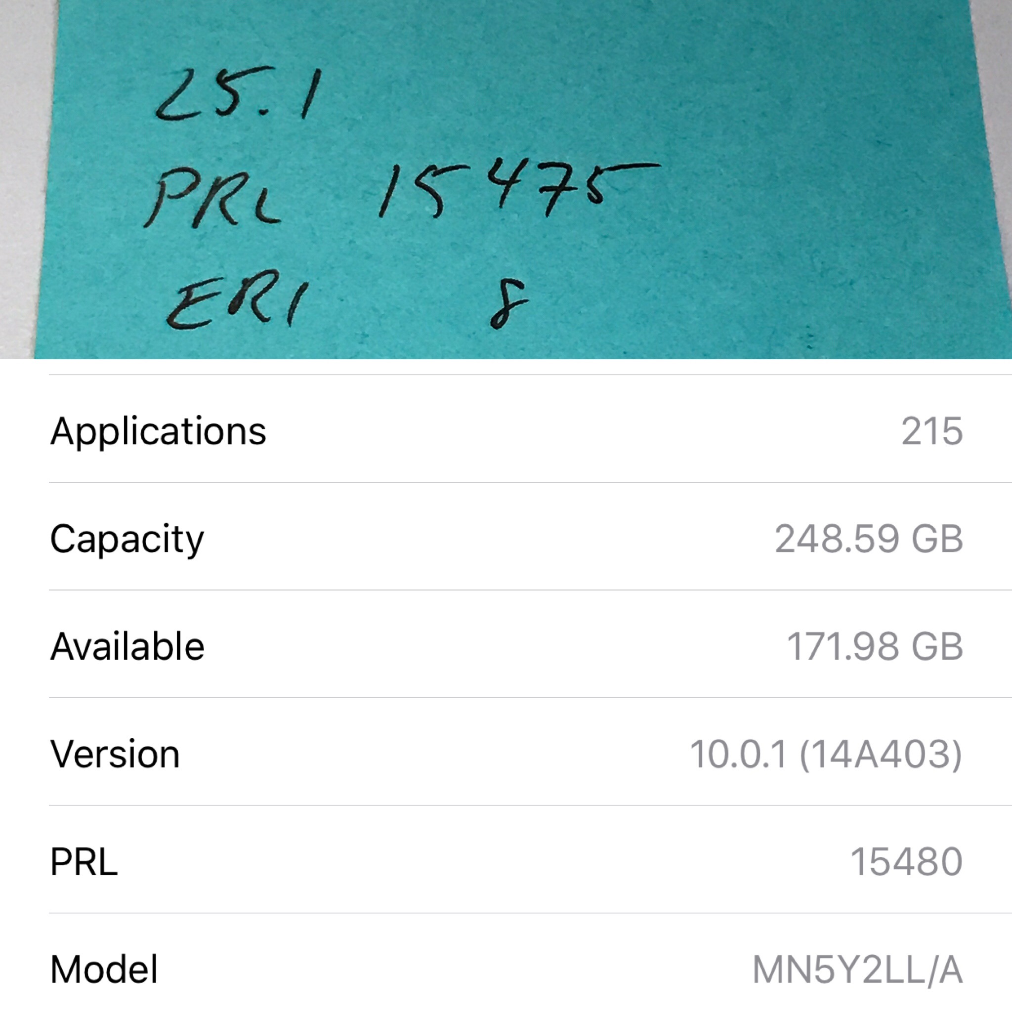

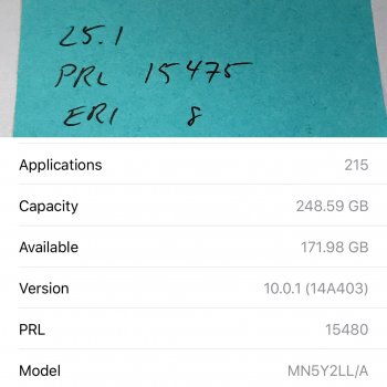

My Verizon PRL updated last night. Doubt it's the fix, but been keeping tabs on carrier updates.
