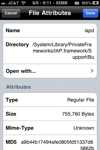

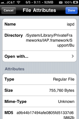

Fix Accessory not optimized etc..
I just updated my OS on my 3GS to 4.3.3, and some of my Energizer battery pack/cases started to give this error along with no soound etc..
This happened before with the 3.1.3 OS, and this fix (or similar) also worked there..
my file was in the location
/Library/PrivateFrameworks/IAP.framework/Support/
all my accessories seem to work OK...
So I think it depends on WHY you get this message... if your device has an issue (dirty/wet etc..) then this "fix" will only stop the error from popping up...
It will not make external devices work, if there is a real issue with your device.. then it needs to be repaired.. but in my case the power pack thinkgy is what has an issue, so this fix allows it to still be used with my phone without any issue, and that popup stops popping up
I made BU dir, and moved the file in there (see picture)
Hope that help someone with their issue!
