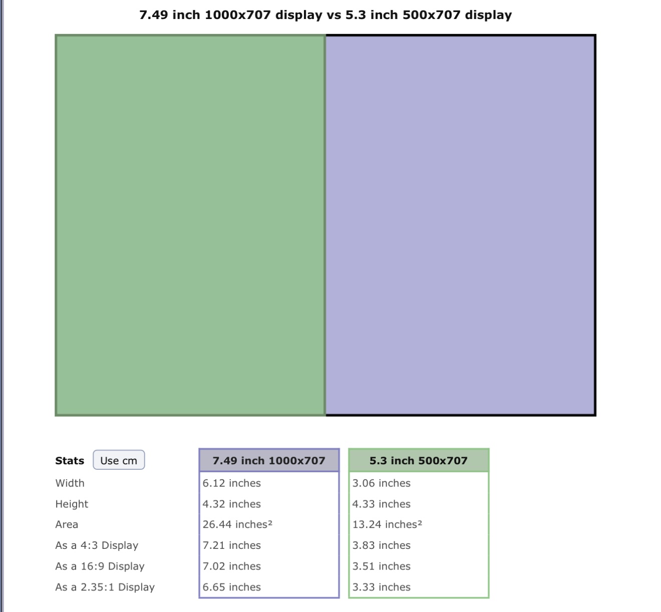

If we had a 1000 x 707 pixel display, with an aspect ratio of 1000/707 = 1.414, and folded that to 500x707 its aspect ratio would remain the same but rotated at 707/500 = 1.414. Here’s that example visualized from DisplayWars:
That’s it! And for a 3 panel fold the repeating aspect ratio would be 1:√3, for a 4 panel fold 1:√4, and so forth.

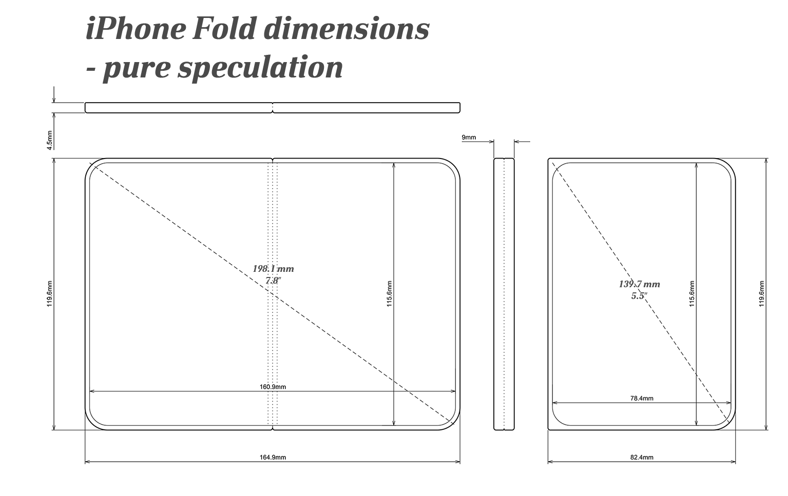

@iZac put together a great visualization of what the screens might look like with the rumored aspect ratios and sizes, quoted below:
OK, I'm sure I'll post this again on some other folding iPhone news article (This is MacRumours, I'm certain there'll be plenty!)
This is my complete speculation based on the rumoured screen sizes (5.5" internal, 7.8" external) lined up so the screen heights correspond, with a simple 2mm bezel around them to arrive at an approximate size. *sigh* It's sad to see this is not going to be good for us mini users!
(click to embiggen)
Reactions: subjonas and iZac
Cheers for the shout out! I actually went down a rabbit hole fiddling with it to make the internal screen explicitly 4:3 and then because I was bored of CAD, quickly modelled it up.
Forcing the internal screen to be exactly 4:3 does make the device a bit wider taller though. I could re-pdf the CAD of my version 2 but ah - looking at renders is more fun:
Forcing the internal screen to be exactly 4:3 does make the device a fair bit wider though. I could re-pdf the CAD of my version 2 but ah - looking at renders is more fun:

Curious though- you listed the diagonals as still being 5.5” and 7.8” after you adjusted the interior screen to be 4:3. It’s a tiny discrepancy, but at least one of the diagonals should have changed to compensate for the new ratio. Not by much, like only .1” or .2” or so. Is that what you measure in your model?
Since the report says “roughly 4:3” and the diagonals are very specific, I’m more inclined to believe the diagonals are correct resulting in a 4.29:3 aspect ratio, slightly longer than 4:3.
Also what did you mean by “make the device a fair bit wider”? Do you mean the unfolded 4:3 aspect ratio makes the folded phone in portrait orientation wider? It shouldn’t, it should make it taller. Or did you mean something else?
Awesome work!
Yup, you're right sorry I did mean 'make the device taller' in the 2nd version - just to specifically hit the 4:3 aspect ratio on the inner display.
Version 1 is somewhere in-between 4:3 and and 3:2. The inner and outer aren't exactly the same, just to accommodate matching bezels.
Ah, my sketches are probably not logically sound - just my obsessiveness has been to see how this thing will compare to my iPhone mini ;) I hope it helps people extrapolate their own answers at least!
Reactions: subjonas
Ah I forgot the bezels might mess with the numbers a little bit.
Your sketches and renders were helpful to many people, I’m sure. It was to me!
