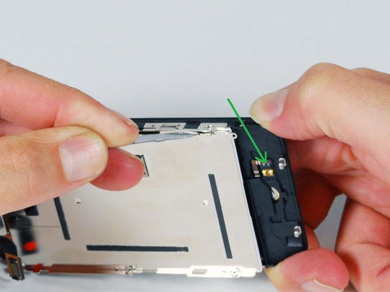

If your home button is unresponsive or you have to press it really hard to get it to work, then the connectors to the home button are pressed to close to the motherboard. You need to open your phone and lift those two very small metal connectors up, very gently or you might break them. If you end up breaking them, just put a drop of solder on it, it will be fine.
