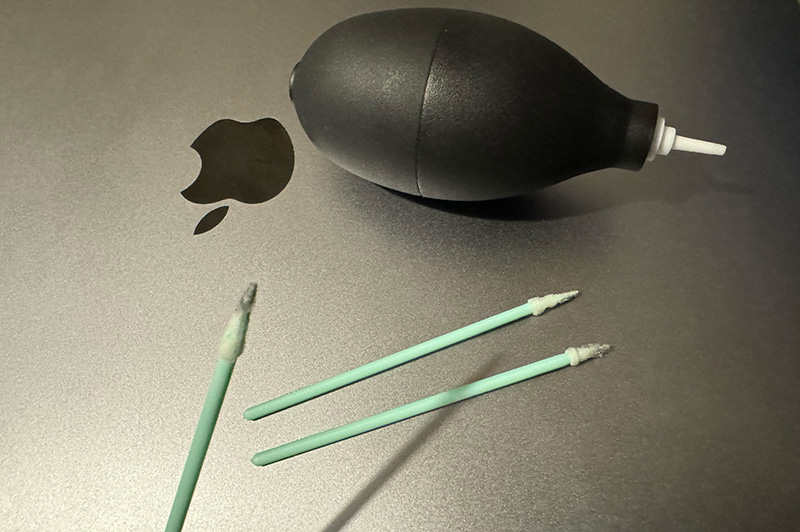

I've had the same issue with an iPhone 15 PM for a few weeks now, and a similar issue with an M1 MacBook Air. I had initially presumed the MacBook charging port was starting to go as the issue continued with brand new cables.
For anyone experiencing any of the following issues:
- Device charging icon goes off and on almost at random, sometimes rapidly and sometimes intermittently
- Moving a device while its charging will stop the device from charging
- Charging cable only works on 1 side rather than either side
- USB-C devices not recognised when plugged in to Mac / iPad / iPhone
- USB-C devices randomly disconnecting from Mac / iPad / iPhone
- Multi cables, new/old, official/non-official all having the same problem
- Liquid / Humidity warning when inserting the cable, preventing you from charging your phone
The solution that worked for me:
- Clean your USB-C ports!
- Turn off your device
- Use a small Dust Blower / Air Blower to gently and repeatedly blow compressed air into the port.
- Use 'Foam Swabs', a small wooden toothpick or something non-metallic such as a small Spudger Tool to clean inside the USB-C port around the connection.
Be gentle and take your time. Don't use anything too heavy such as a can of compressed air.
You can see from the image below that my Foam Swabs are covered in dirt. The issue is now fixed on my iPhone and MacBook.
