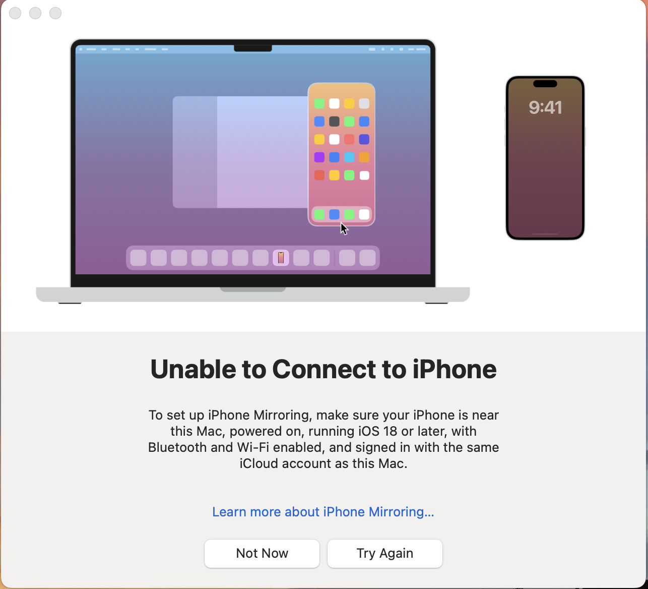

This is what I am getting. I've tried signing out and in of my Apple ID on both devices. I restarted both devices. Bluetooth and Wifi are working on both devices. Any ideas?

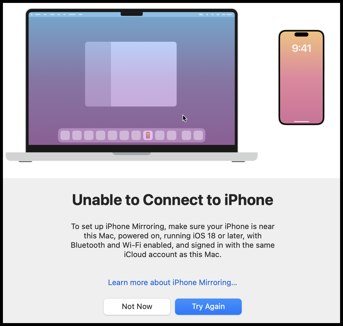

Not working for me either. I have a M1 Mini and iPhone 14 Pro Max. Both with latest updates (today). The Mac doesn't even see the phone literally 3" away. Rebooted both. Logged in and out of Apple on the mini. Nada.

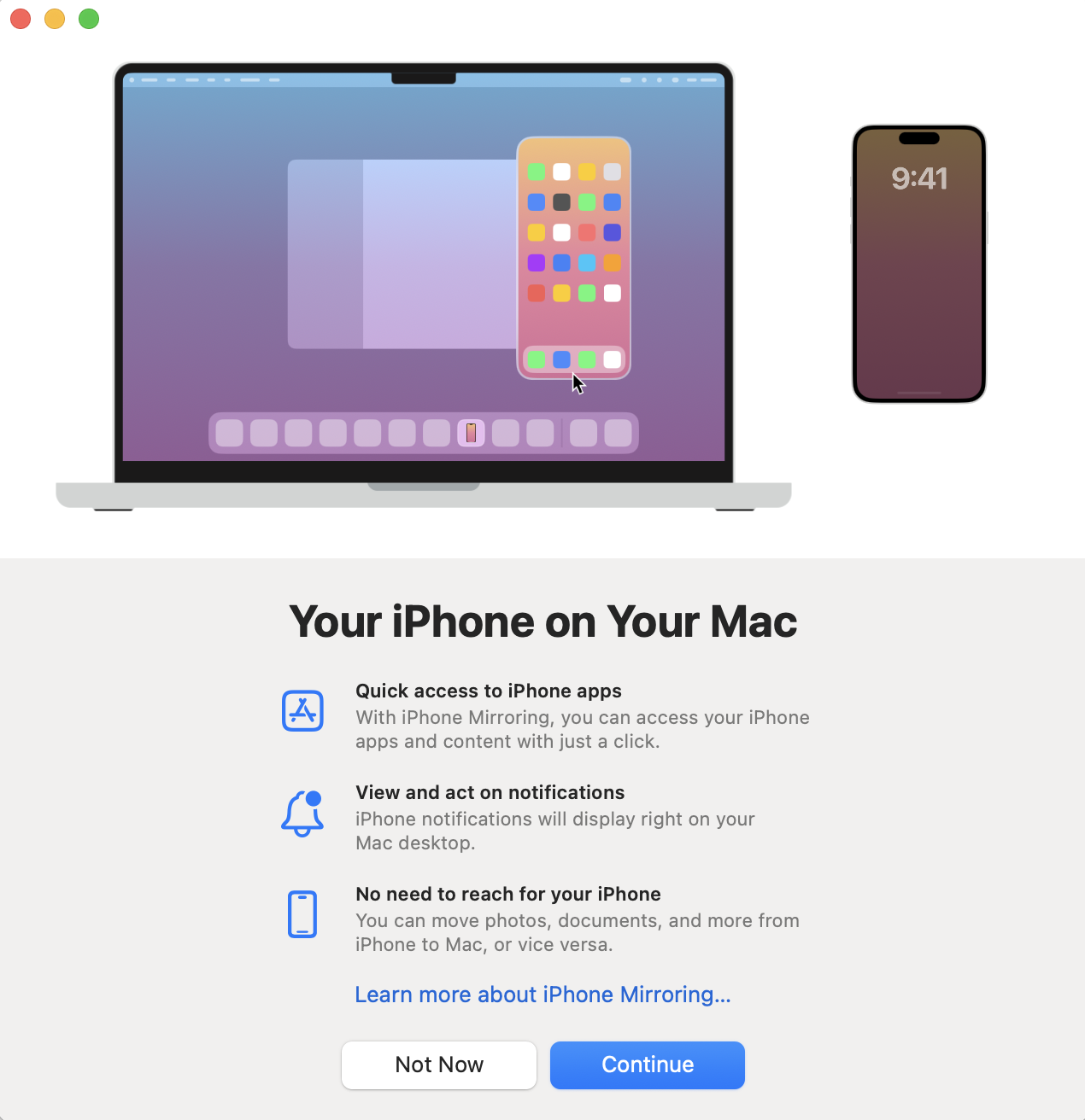

Okay. Phew! Finally got it to work. I entered Recovery Mode for MacOS and installed a fresh copy of macOS Sequoia. Then I deleted my copy of iOS 18 and downloaded a fresh copy. I then flashed that onto my iPhone 15 Pro. I also have a 3rd gen SE I keep around as a backup, so I updated that one to iOS 18 OTA. This time when I opened iPhone Mirroring,
I got this screen. But then it was picking up the wrong iPhone! I was getting prompted on the SE instead of the 15PM. I went into settings and then saw a new message:
