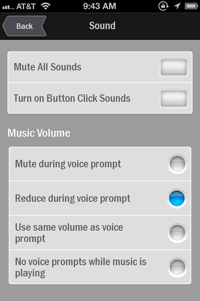

It automatically reduces the volume of the music for voice prompts. Here's a screenshot.
