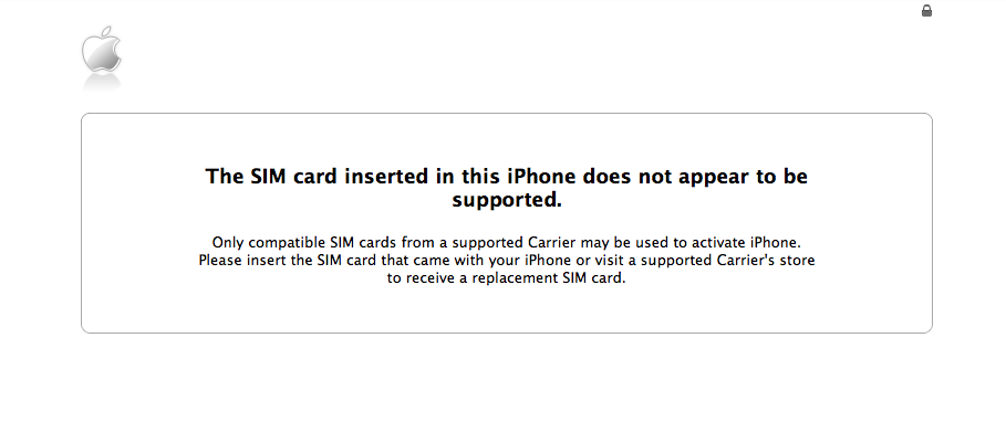

My iPhone is currently locked to o2. Its a PAYG with a contract sim card in (as I previously bought a 3G.
I put an Orange SIM card in, connected to iTunes and got the following
