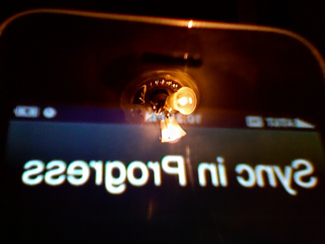

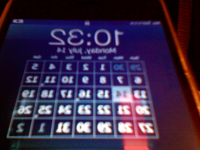

I took two pics with my camera, they are really crappy quality but you can kinda see the difference, the one on the left is for charging the one on the right is charged, if you notice the one on the right has low battery on the big icon but fully charged in the corner. This is only happening when i plug it in to the wall charger for some reason for both my 3G and 1st gen

This problem is not what I just had. Your seeing a full charge on the icon with a charge bolt in the middle. That's normal when charging.

No it is not normal, do you guys see the icon in the battery in the corner? Forget the fact that it is full, the one on the left is a lightning bolt, indicating it is charging. The one on the left is showing a plug icon in the battery which is supposed to indicate its fully charged, that is not happening with my iphones
