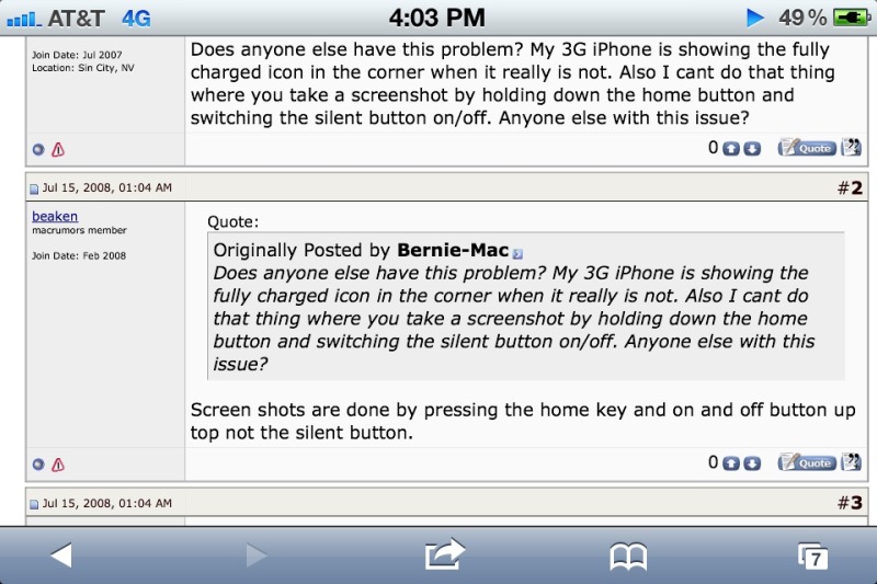

No, there are two icons in the corner, one with a lightning bolt looking thing in it indicating it is chargING and one with an plug looking thing indicating it is fully chargED
:edit: When i plug it into the wall charger I get the icon probelm but when i plug it into itunes it is fine, the same with my OG iphone with no service or anything......interesting...
On my iPhone it only displays the plug icon in the battery is when it is either:not plugged in correctly or fully charged. Also, when it is dead and when you plug it in incorrectly it will say charging then turn to black after a minute.
