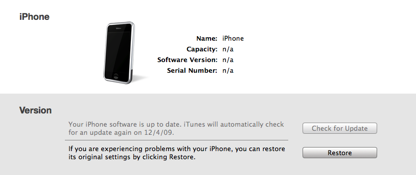

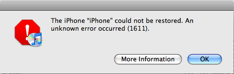

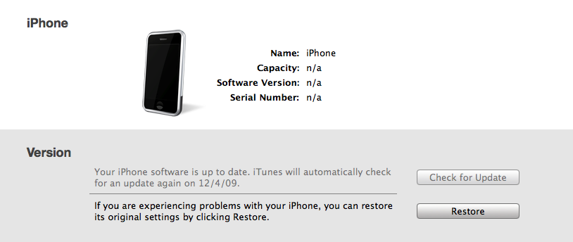

I just bought a 8gb iPhone 2g from a member on this site. This is my first iPhone so I'm not up to date with all the stuff on it. It needed a new battery.
I got it but it wouldn't turn on, just would show the charging screen with 1 red bar when connected via USB. I have since removed the battery but when I go to turn it on, it shows the itunes with USB cable on it and I open up iTunes and try to do a update and restore, it always fails.
I've been googling and trying everything I could find for the last few hours with no luck 🙁
I have the battery removed now as the one I purchased seems to be defective so I don't get the charging status screen anymore.

Not sure what you mean by you "have the battery removed," but here is a thread on the 1611 error:
https://forums.macrumors.com/threads/826074/
Perhaps one of the fixes there will work for you.
Thanks. The only real suggestion in that thread turned out didn't work for them so I guess I might as well try and see if it works for me then.
My internal battery is removed. I'm waiting to get another one now.
I now got a 1603 error now 😕

16xx Errors are USB miscommunication or mismatch errors. Easy way out, reboot computer and try again or simply change computer.
