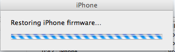

I was restoring my iPhone, and iTunes doesn't seem to want to get past this:
4w5i
It's been stuck on this for the last half an hour, and not going anywhere. It's the second time it's happened. The first time, after 30 minutes I pulled it out and it went into recovery mode, so I tried restoring again to no prevail thus far.

Okay, so I plugged it into my friends MBP (same model as mine) and it restored...
Earlier I tried eliminating error on my end by restarting my MBP but it was no help.
Very strange.

The exact same status happened to me. I updated iTunes to 9.1.1 and it was all fixed.
Yeah, I already am at 9.1.1
I might have to reinstall iTunes and give it a go. Will post the results when I do.
I restored again on my sister's computer and everything worked fine, so it's obviously got to do with my computer.
Hey I had the same problem, while beta testing 4.0 whats more so I was very worried. However, turns out you just need to uninstall itunes and some core files
If you are still unable to restore iPhone, remove iTunes by doing this:
If you are a Mac user, delete the following files:
2. /System/Library/PrivateFrameworks/DeviceLink.framework
3. /System/Library/PrivateFrameworks/MobileDevice.framework
After that, restart your Mac and install the latest version of iTunes. Repeat the normal restore again.
For Windows users, uninstall Apple Mobile Device Support and iTunes from your system, restart the computer and re-install the latest version of iTunes and try to restore again.

Ive been trying to look all over the internet about this problem and Finally I got to this thread. It seems like I started having this issue after I changed the "host" file to do a restore and sign the firmware via my SHSHs backed up on sauriks server.
Anyways a I removed whatever I changed on the host file and I am still getting the same problem(it gets stuck half way through the restore). I am a mac user and I uninstalled itunes-restarted my computer- re installed itunes and I am still getting the same problem. I guess I will try and delete those 2 files mentioned. If someone knows exactly what is happened please let me know. I am trying to restore an Iphone 3GS and an Iphone 3G both to 3.1.2 and I am getting the same problem!!
Still same problem
This is what I am stuck at..I uninstalled Itunes removed those 2 files restarted my computer and re installed Itunes and I am getting the same problem

It works
Great, it WORKS !!
nicksherb you are a savior

I have spent the entire night trying to get out of the "Restoring iPhone Software" progress bar on my 2-year-old 3G (using Mac OS X 10.6.4 and iTunes 9.2)
I had a recent backup but I still needed to solve this and complete the restore process.
All my stuff was restored down to the very last SMS.

If you're going through the fix under Mac OS X, you need to make sure iTunes is removed with a bunch of other files as well.
http://support.apple.com/kb/ht1224
In addition to that, also delete the 2 files mentioned by nicksherb.

This is great! To summarize everything. Initially tried to restore my 16gb 3G (jailbroken 3.1.3) from iTunes, but the process got hung-up at this:
4w5i
Waited at that point for 4 hours without any changes. Eventually found this thread. Decided to take a leap of faith and pulled the plug. Followed the instructions to remove itunes here plus removed the additional files listed above. Then reran the option-click restore (my phone had defaulted back into recovery mode.) Took about 20 minutes to do the restore to 4.0 and then restore my backup. Now it's resyncing. Hopefully that's the end of everything. Thanks for all of the help!
