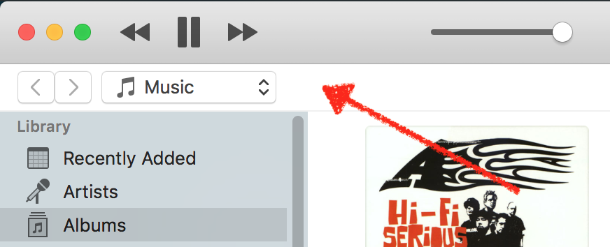

Sat here waiting for my new XS Max to be delivered, but for all morning I've been trying to back up my iPhone 7+ so I can restore the new phone from this.
However, iTunes just won't recognise that my phone is plugged in and I've tried everything I can think of, yet I still cannot see the button to go into iPhone settings on iTunes to do the backup.
Please help. This is what I've tried.
  • Rebooted 2018 13" MacBook Pro twice
  • Rebooted iPhone 7+ twice
  • Tried all 4 USB-C ports and both USB-A ports on my Kingston dongle
There must be a reason I cannot get to the phone settings on iTunes to do the backup? Is there anything else I can try?
This is where it is meant to show, right? Once it is connected? It's been a while since I've done a backup...

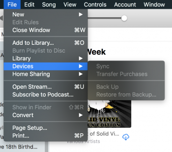

I just did this, and it popped up asking me to trust the laptop and iTunes said I need to allow it on my phone so entered my pin and then it looked like something was happening, but I still don't see the option to go into the iPhone and kick off the backup.
[doublepost=1537532223][/doublepost]
Read the steps I gave above about resetting Privacy and Security and that will allow you to trust it again. Also open up the Photos App and see if your phone is recognized.
iPhone is recognised in photos. Not in iTunes.
