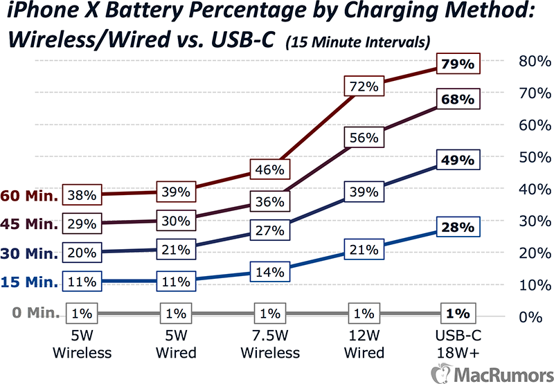

We used the same iPhone X for all tests, plugged into the same outlet. Between tests, the battery was drained to one percent, and then battery percent was checked at 15 minutes, 30 minutes, 45 minutes, and 60 minutes while charging.
For all tests, the iPhone X was placed into Airplane mode with no apps running. The display was deactivated except for the four time checks. Tests were conducted without a case on the iPhone X.
Results
The absolute fastest way to charge an iPhone 8, iPhone X, or iPhone 8 Plus is with a USB-C power adapter and an accompanying USB-C to Lightning cable. Charging with USB-C activates a "fast-charge" feature that's designed to charge the iPhone to around 50% in 30 minutes, and I saw about that level of charge in all of my USB-C tests.
5W wireless charging and 5W wired charging with the standard iPhone adapter were the slowest methods that I tested. 7.5W wireless testing was faster than 5W wireless charging, but not by much.
Click to enlarge
Charging at 12W with the iPad adapter wasn't ultimately too far off of the fast charging results at the end of an hour, making this one of the better compromises between cost and speed.

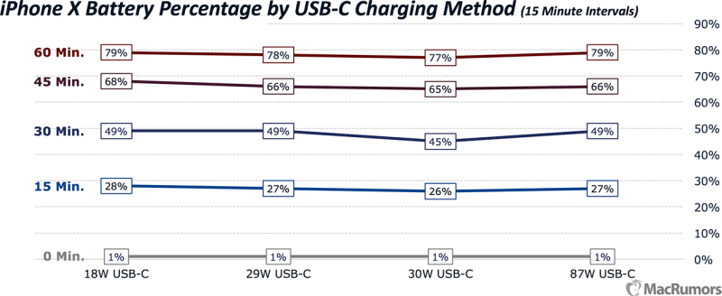

USB-C

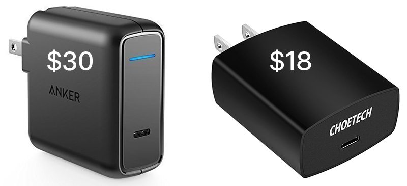

I tested both Apple's 29W and 87W USB-C chargers that come with the 12-inch MacBook and the 15-inch MacBook Pro, respectively, along with much cheaper 18W and 30W chargers from Choetech and Anker. I saw little difference in charging speeds between 18W and 87W.
Click to enlarge
At the 30 minute mark in all tests, my phone was charged to between 45 and 49%, and at 60 minutes, I reached 77 to 79% battery life. The slowest charger was the Anker 30W, but the overall difference was so small that I think it can be chalked up to random variance. My charts are using 1 charging result, but I did test many of these chargers multiple times with the same general results.

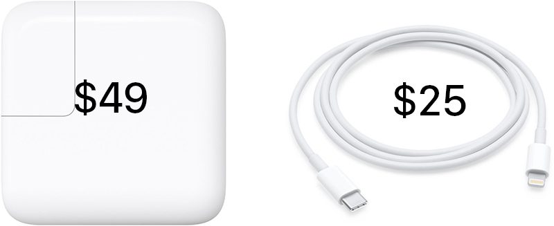

Apple's 29W MacBook charger costs $49 and the USB-C to Lightning cable costs $25, so you're looking at about $75 for this charging method, but luckily, third party USB-C power adapters work the same way and are more affordable. That 18W Choetech charger I tested, for example, is just $18, while the one from Anker is $30.
Apple's 29W USB-C power adapter and USB-C to Lightning cable​
There are cheaper non-official USB-C to Lightning cables on Amazon, but given the problems we've seen with some third-party USB-C cables, it may be best to stick with verified Apple hardware as far as the cable goes. I didn't test third-party Lightning to USB-C cables, but I wouldn't expect to see major speed differences.
Choetech's 18W USB-C power adapter and Anker's 30W USB-C power adapter​
If you go with Apple's cable and something like the 18W Choetech charger, you can get a fast charge setup for just over $40. If you want to try your luck with a non-official cable, you can get fast charging for under $30.

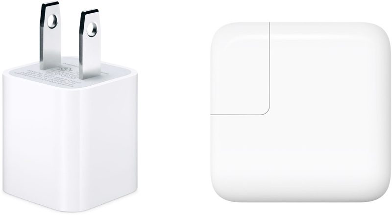

Standard iPad and iPhone Chargers
All of Apple's iPhones ship with a standard 5W power adapter and USB-A to Lightning cable, and charging with the standard setup is excruciatingly slow comparative to other charging methods. It's not faster than 7.5W wireless charging and it can't compare to charging with power adapters that put out more juice. At 30 minutes, for example, it had only charged my iPhone to 21 percent, and I only made it to 39 percent after 60 minutes.
Apple's 5W iPhone charger and 12W iPad charger
Apple's 12W iPad charger is much quicker, though, and it's affordable at $19. With the 12W iPad charger and a standard Lightning cable, I saw charging speeds that weren't too far off of what I got when charging with a USB-C power adapter. At the 30 minute mark, my iPhone charged to 39 percent, and at the 60 minute mark, I hit 72 percent.
That's not too bad for a setup that's one of the most affordable I found, and there are a lot of 12W equivalent third-party charging options on the market, including several with multiple ports and other conveniences.

That said, 7.5W wireless charging, which was activated in iOS 11.2, was faster than the standard 5W wired charging method in my testing. There's also a noticeable but slight speed difference between 5W wireless charging and 7.5W wireless charging.
Click to enlarge
I tested this difference using the 7.5W wireless charger from Belkin, which Apple sells, on both iOS 11.2 and iOS 11.1.2, which limited iPhone charging to 5W. The Belkin 5W charging result on iOS 11.1.2 is the result included in my graph.

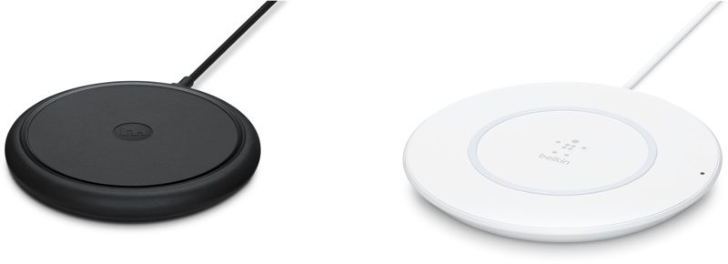

There wasn't a huge difference between 5W and 7.5W charging in my experience, but 7.5W is faster. If you're buying a wireless charger, it's worthwhile to get a 7.5W+ charger that offers faster charging for the iPhone, but which chargers are compatible with 7.5W wireless charging remains something of a mystery.
The Mophie and Belkin wireless charging docks​
We know the Belkin and Mophie chargers that Apple sells offer the faster wireless charging option, but it's not entirely clear if other higher-watt chargers from third-party manufacturers are able to charge the iPhone X, 8, and 8 Plus at higher speeds.
For a separate post on wireless charging options, we've been investigating third-party wireless chargers, and it's looking like there may be a restriction put in place by Apple to limit 7.5W charging to approved manufacturers. As an example, on the Amazon page for this charger from Choetech, which says it is 7.5W, there is this message:
We get notice from Apple engineer that current IOS only support 5w qi wireless charging currently, 7.5w wireless charging is encrypted and never released to 3rd party manufacturer.
We've heard similar information from other manufacturers, but it's all very nebulous and not something Apple has clearly outlined at this point. For that reason, if you want confirmed 7.5W wireless charging, go with the Belkin, the Mophie, or another charger that specifically states that it's compatible with Apple's 7.5W charging.
