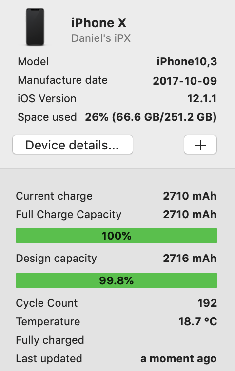

Garbage post. Apple only uses higher current for the first 50%. I've never charged my iPhone X with the 5w adapter, using only the 12w iPad and 60w USB-C charger and it's still at 100% capacity today. Perfect condition after 192 cycles.
I wouldn't call it garbage, but I too have noticed that using 4.8a 24w+ chargers seems to make no difference on the battery of my cellphones, even after 250 cycles. I keep weekly records of my battery's capacity and health via coconutBattery and have since my 6+.

@Daniel L Scary, my 512 GB Xs Max is at 66.6 GB too. lol.
