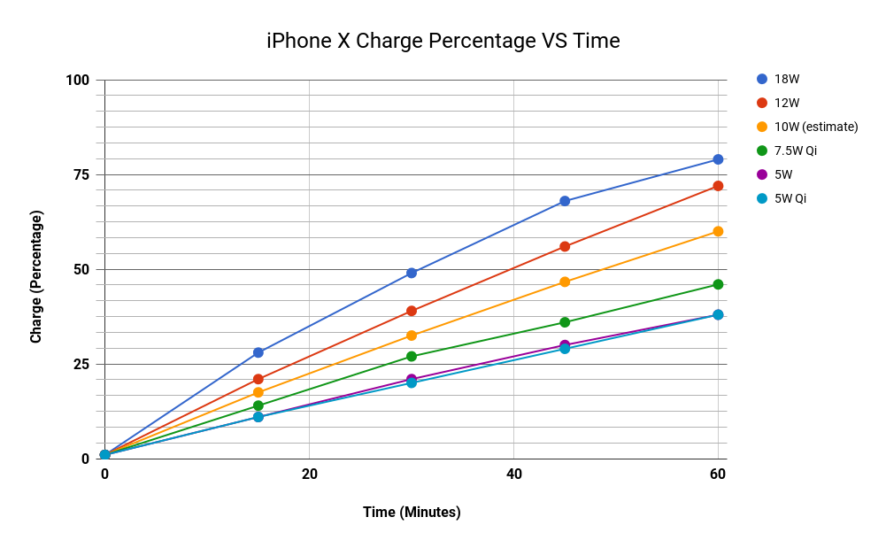

I realize I'm presenting the data here a little unconventionally, but I liked that I was able to show exact percentages while also giving an overall picture of the difference in charging speed. For anyone who wants to take my data and whip up other charts, I'm more than happy to provide it. Just let me know!

I realize I'm presenting the data here a little unconventionally, but I liked that I was able to show [...]
Well, you did show a prime example of how not to present data: never draw a line between data points that have absolutely nothing to do with each other. For example, in the first chart, what is it supposed to mean when the 60 minute line crosses the 60 % mark between 7.5 W wireless and 12 W wired? 10 W semi-wired?
Apart from that, thanks for all the work that went into the article, much appreciated!

Look at the difference between 7.5W wireless and 12W wired. Be aware that wireless loses several watts of power due to heat energy loss. So your 7.5W wireless is really only feeding about 5W of power into the phone, while the rest is lost to heat.
not sure where you are getting your info.
looking at the chart, there is barely any difference between 5W wired and wireless.
the difference between 7.5W wireless and 5W wired is much bigger.
Exactly, when they talk about the "power" of wireless charging, I'm about 95% sure they refer to the "power" being applied to the phone to charge. So while there are inefficiencies in wireless charging, the actual power going into the charging coil is the one that is not talked about. In other words, to get 7.5W on the device side, we may be putting 8W into the primary coil.

btw these graphs hurt my head.. why would you put the charger models along the x axis and time on the y..
