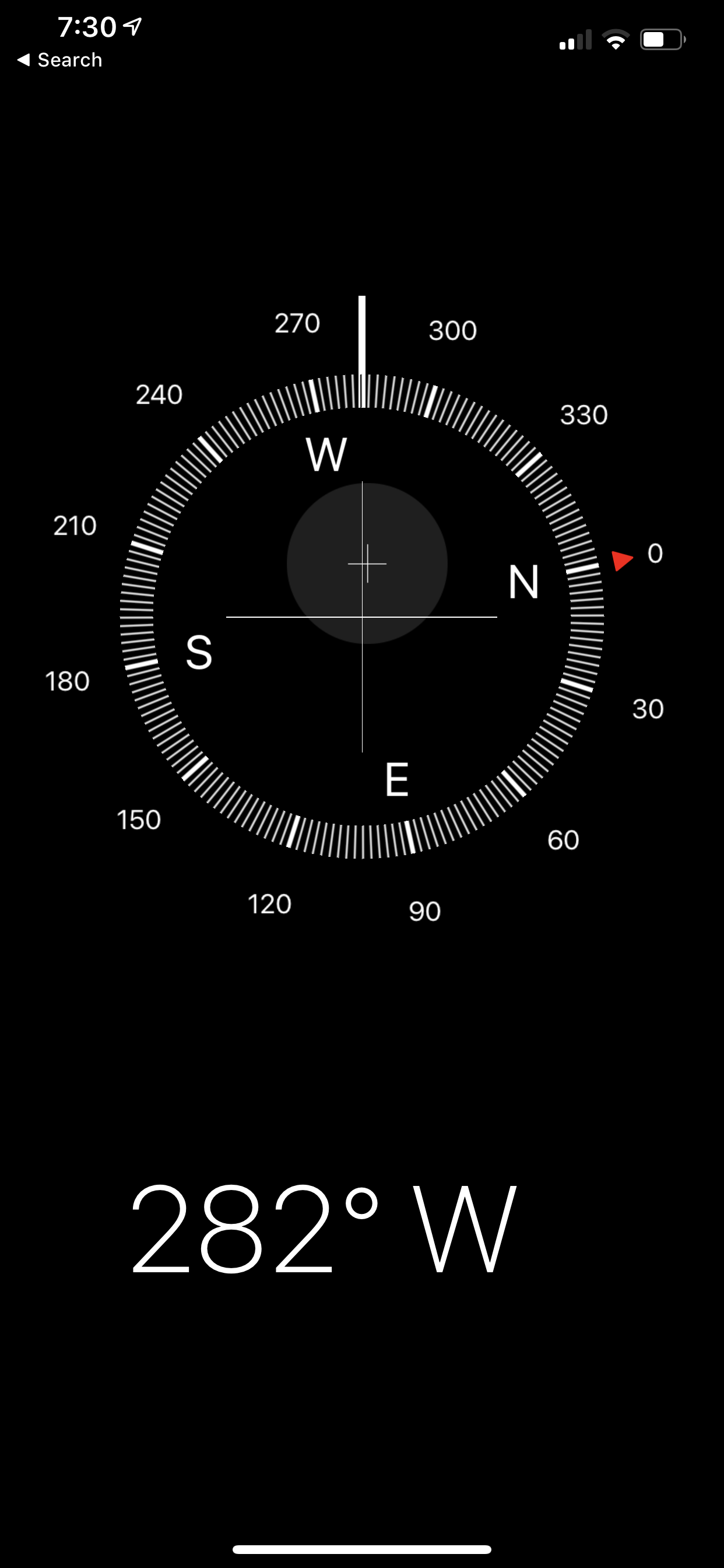

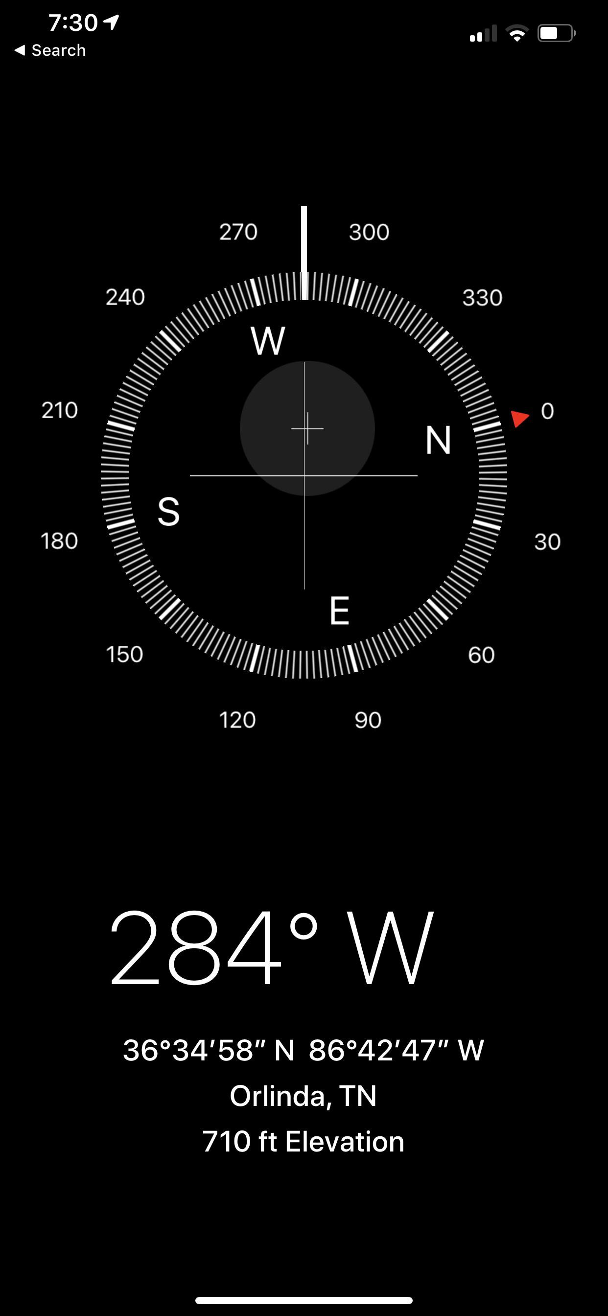

Makes no sense cause all location service does is show city name and longitude/latitude coordinates and elevation as you can see in the pics.

I know that!. And mine works just fine...
I’m just saying turning location services on shows city/coordinates. Just showing what it looks like with the location services ON and OFF lol
