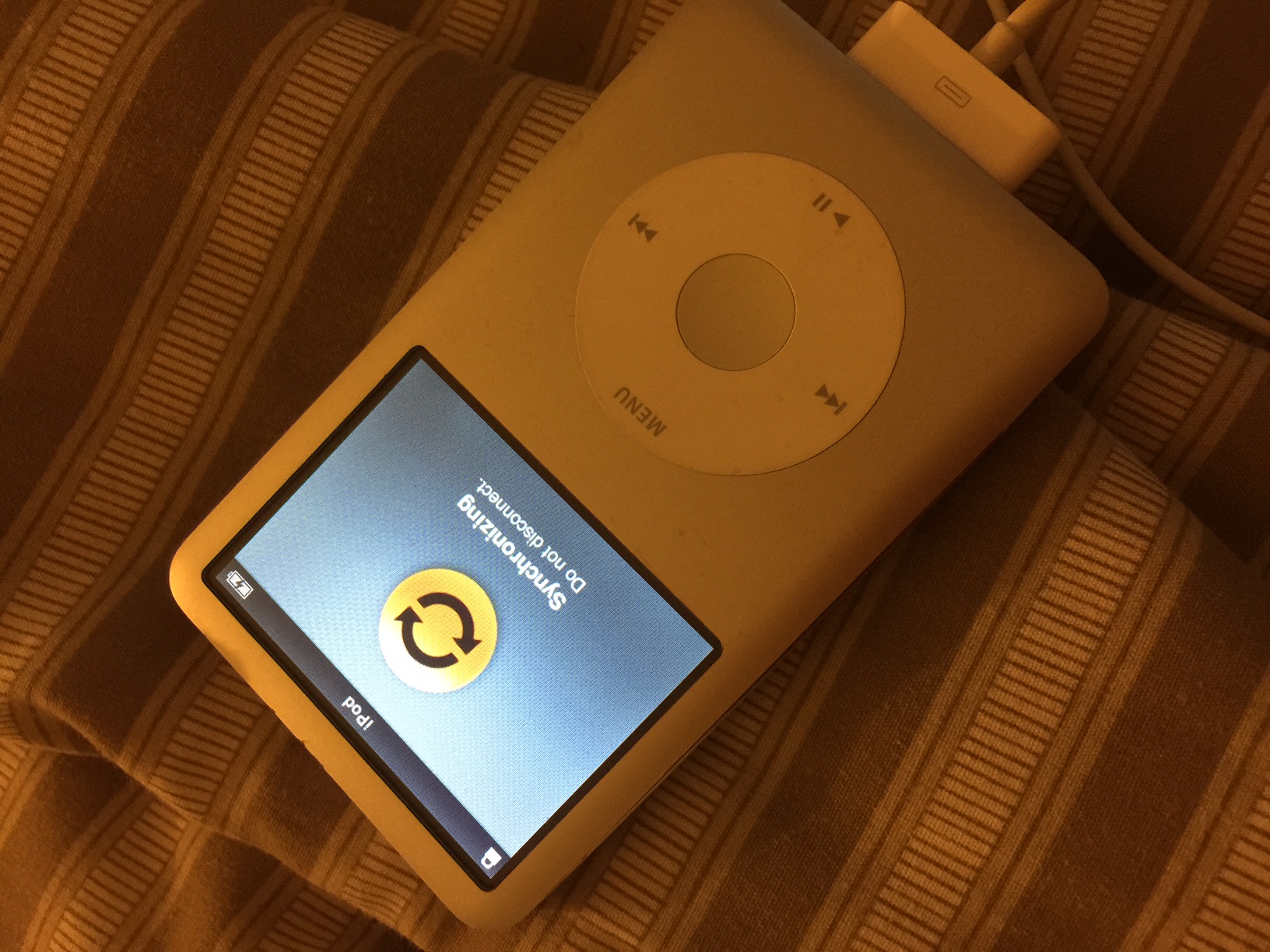

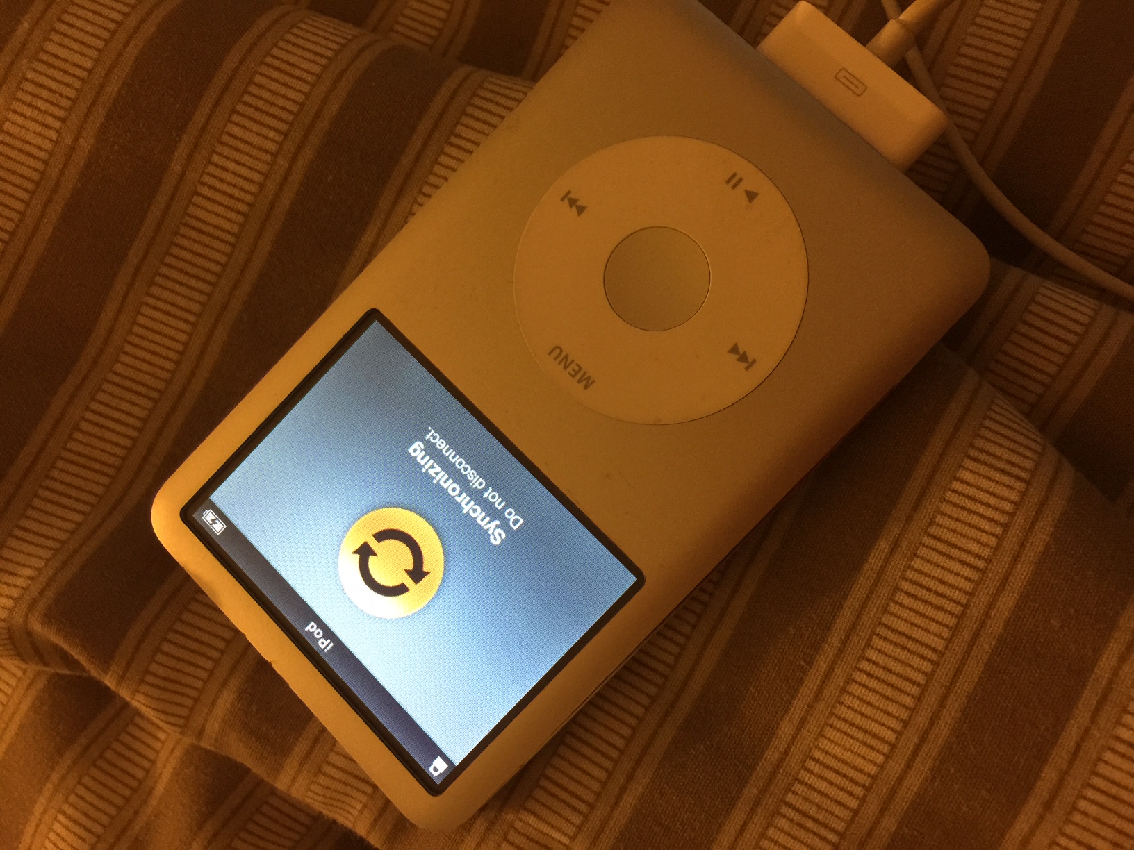

I've got sort of the same problem with my 3rd gen classic. I hadn't used it in a bit so it died, and when i went to recharge it, it went to boot up, i can here the HDD spinning, but it never boots past the apple logo and the drive just spins and spins and spins. Ive tried resetting it. and it doesn't help. I have no clue what the issue is...it was working perfectly fine the week before. 🙁 Now when i plug it in, it turns on, and the screen comes on for like 5 seconds, then it shuts off, but the drive keeps spinning.
No joke, sometimes a problem with the hard drives on these classics can be fixed by hitting it firmly on your hand or knee.
Reactions: oscar98
that's what happened with my classic. i could hear the spinning hd on and on and wouldn't get pass the apple logo. i even tried the smack it hard or slam it on a carpet type of fixing but didn't work. although i heard some people had luck with it so you could try it as a last resort. in the end i decided to just get myself an ipod nano and had been using it for awhile now. just last week i decided to get my classic a new hard drive and followed the instructions on this forum ( i got a 120GB hdd from ebay). since i am fixing my hdd i decided to get a new battery too. when it was all fixed and done i hooked it up to my computer and had an unrecognized hdd message. i unhooked and hooked it back to my computer and at the second try it recognizes my hdd. now here's what i got.......one thing to remember though when you're changing the hard drive of the classic - it's a PIA to open it. i got scratches all over and have used different tools - screw drive, knife, putty knife and in the end the one that helped me open it was a thin metal from an old floppy drive. but once you're able to open it. the upgrade is a breeze. and putting back them on is easy too. good luck.
PS - i wish i tried the SSD but they're quite expensive for me.
Since you seem to be content with 120GB of storage, you could have used an SD card with a CF to SD adapter along with Taran adapter. This way, you can save money by using a SD card with your desired size rather than an SDD. SD cards also use a lot less battery than the original HDD and the model SSD route. Just a thought for anyone reading this thread looking for a solution to their HDD failure.

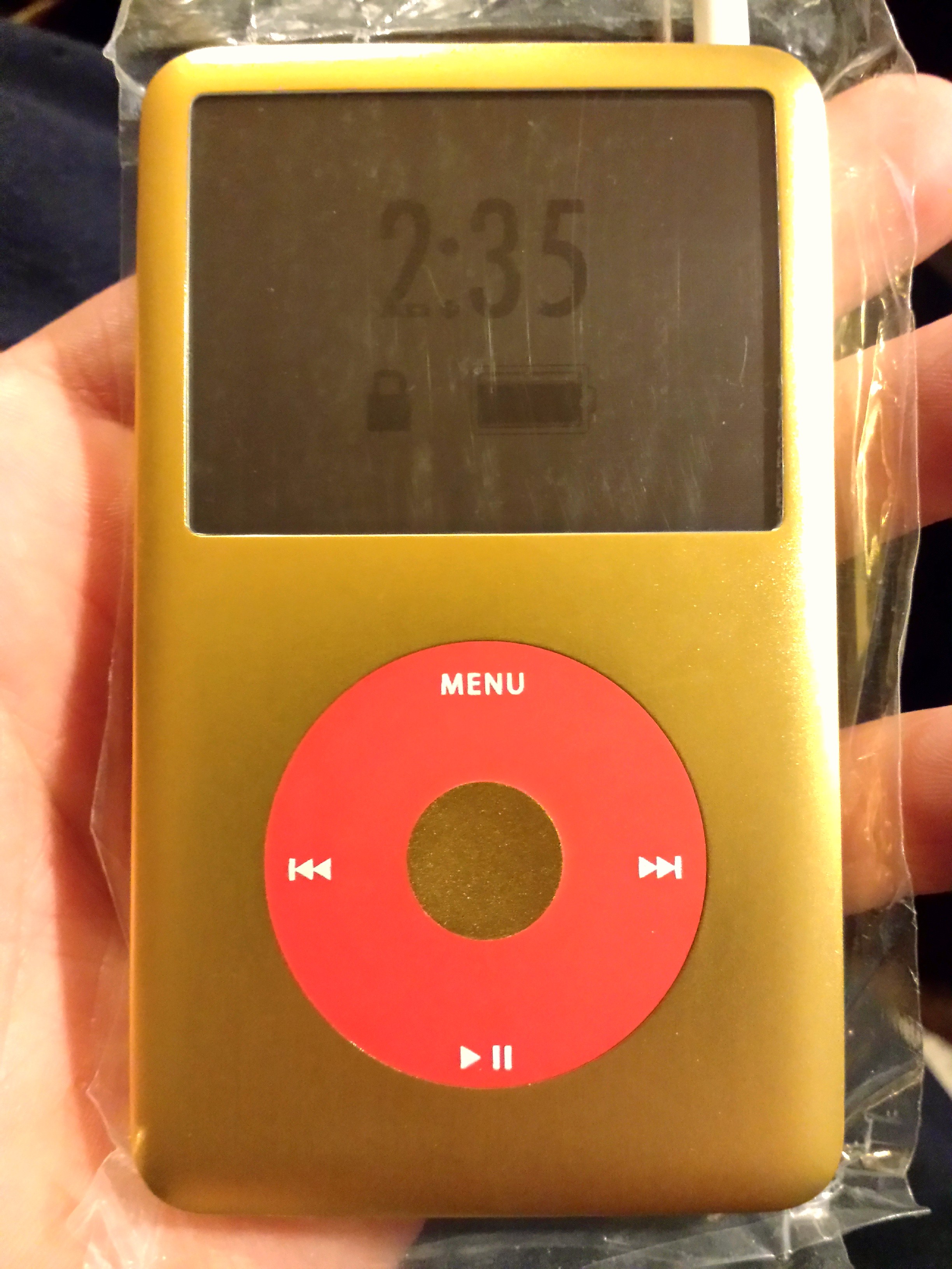

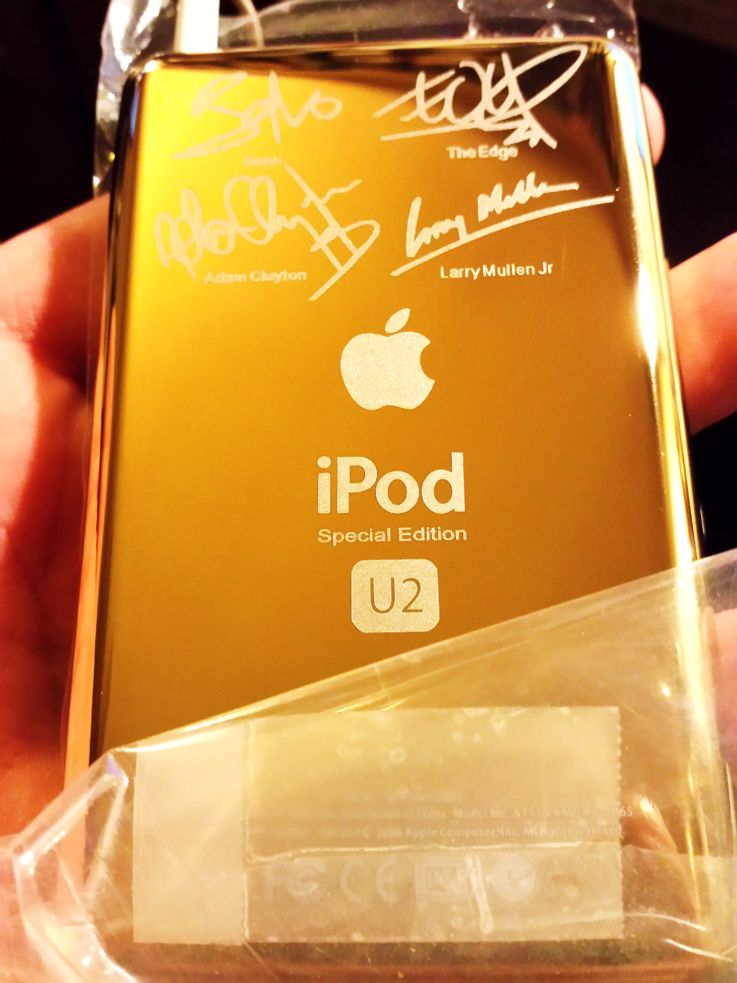

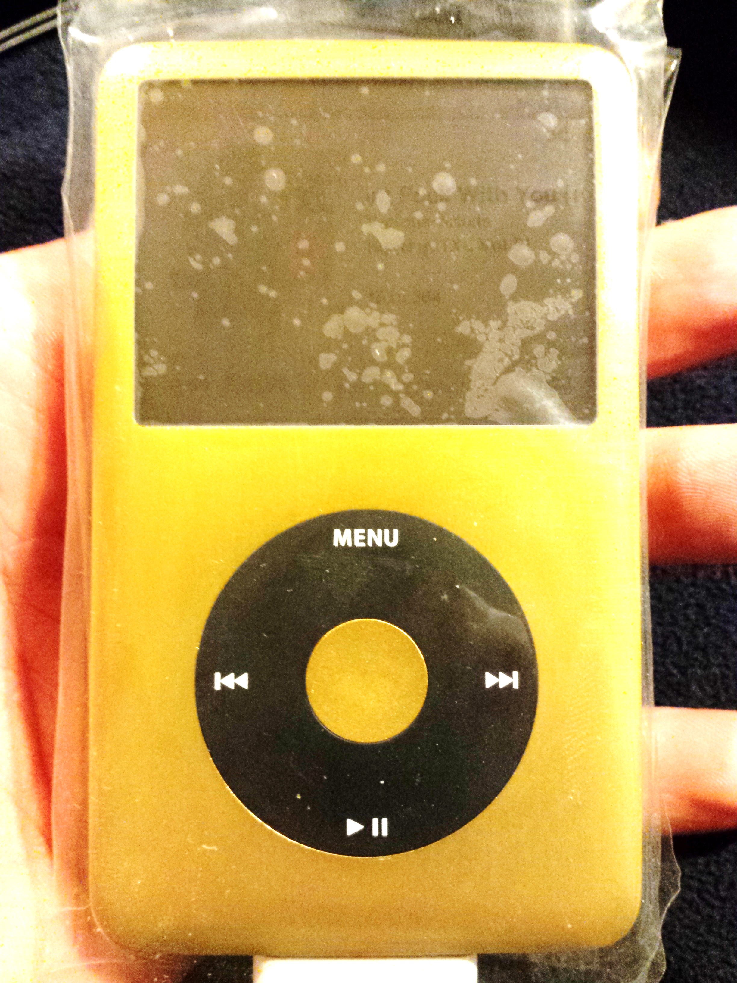

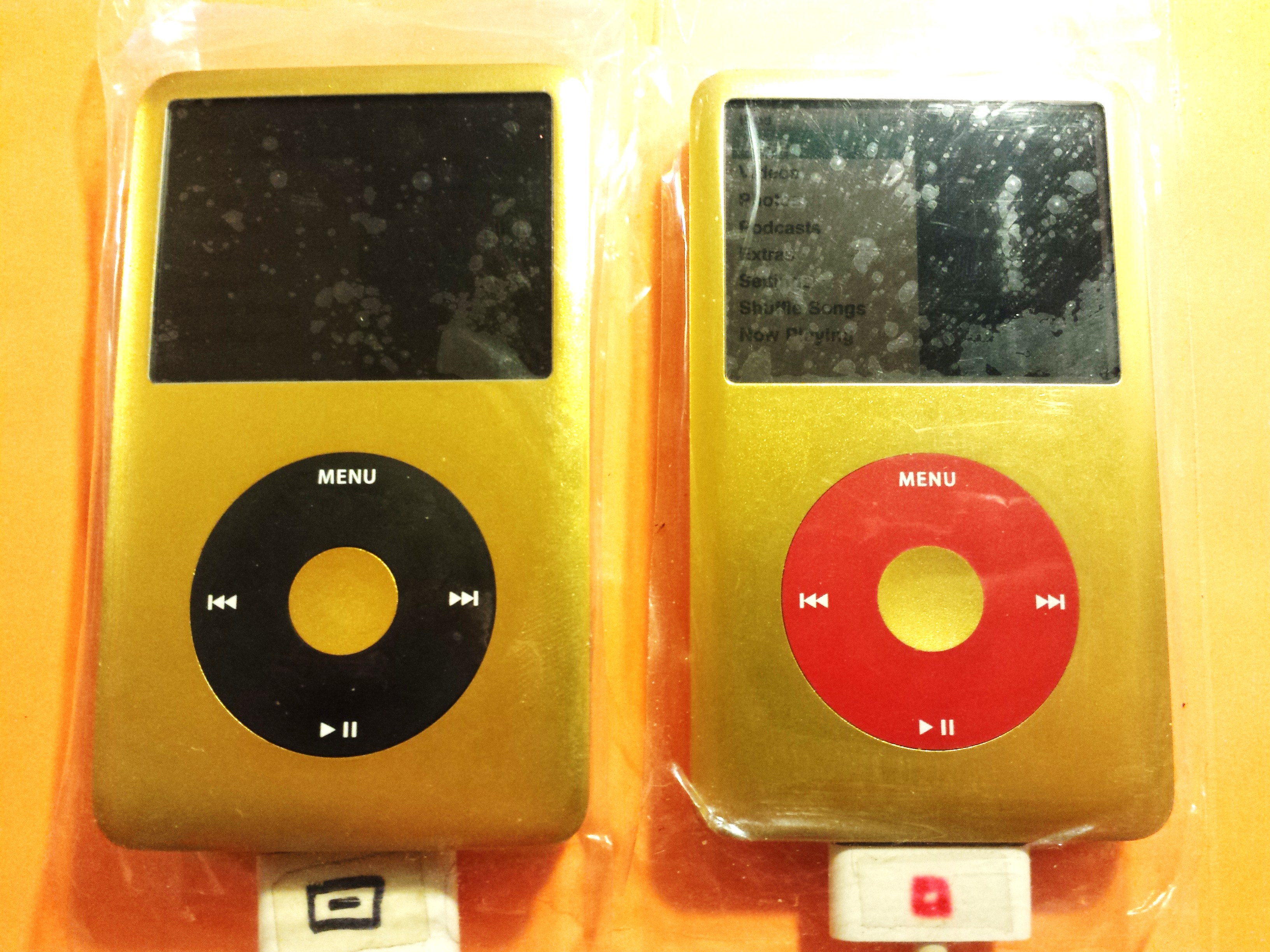

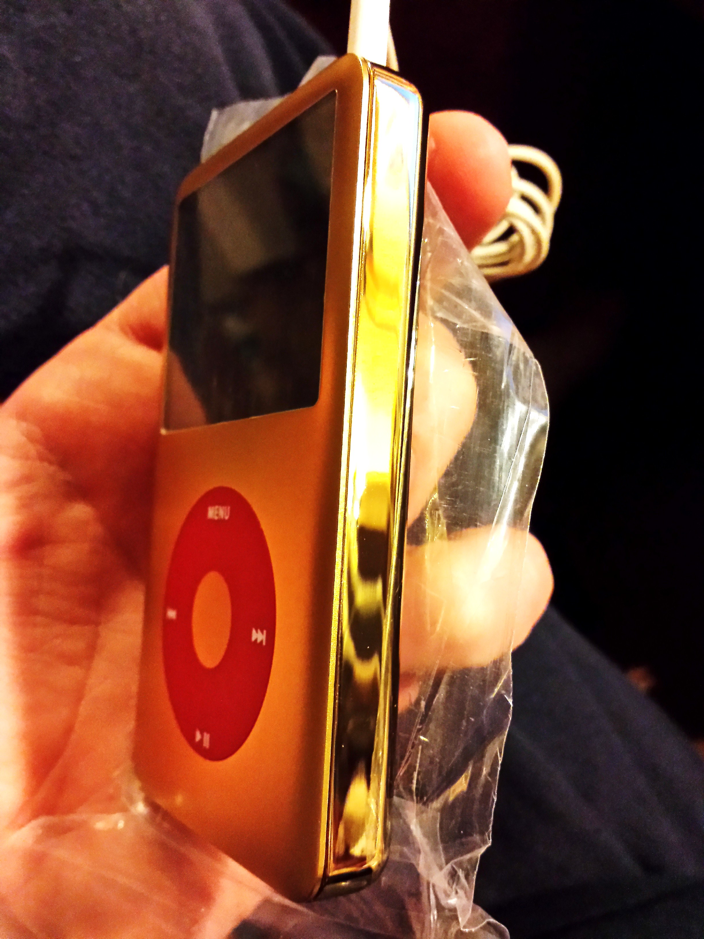

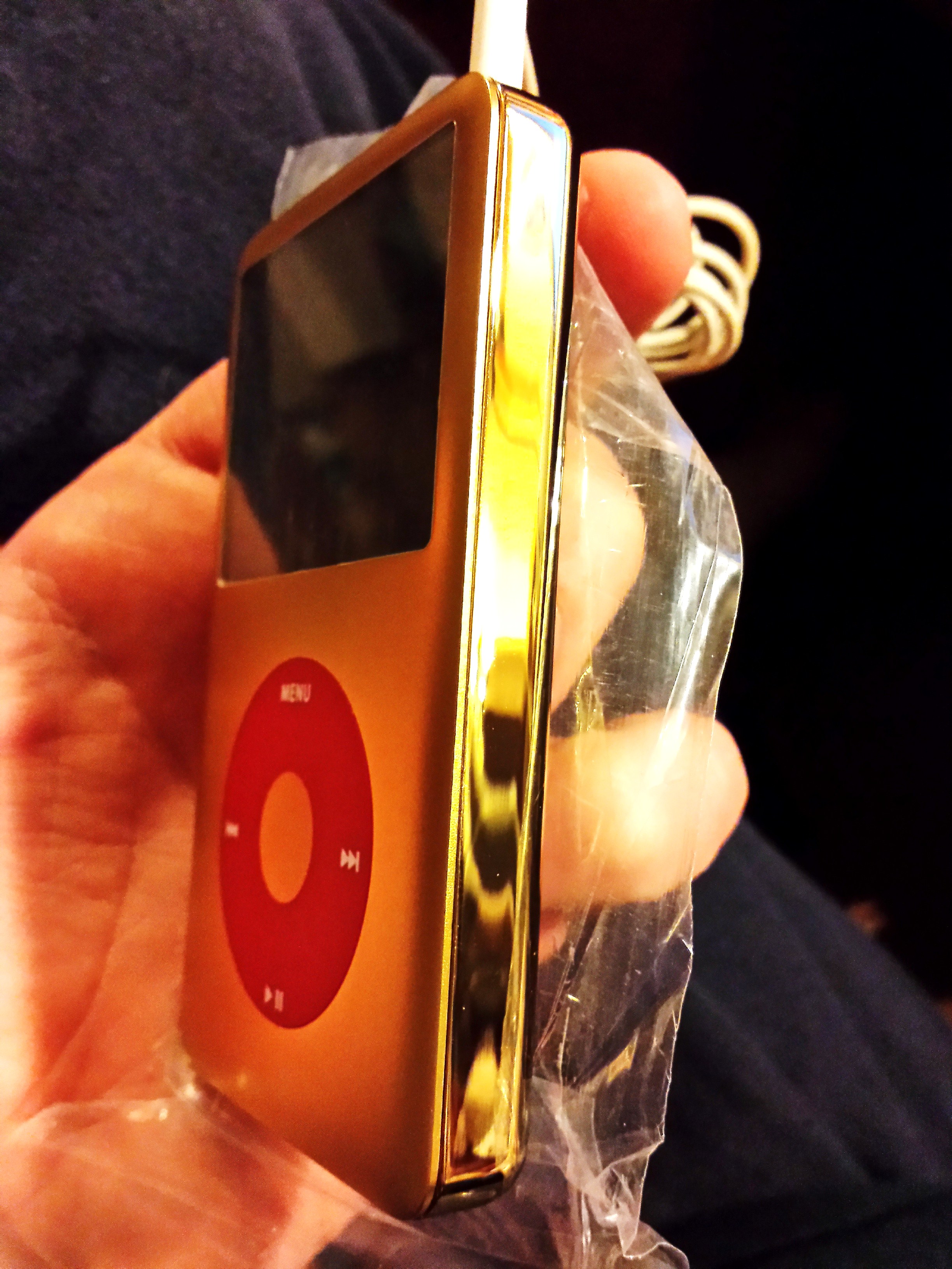

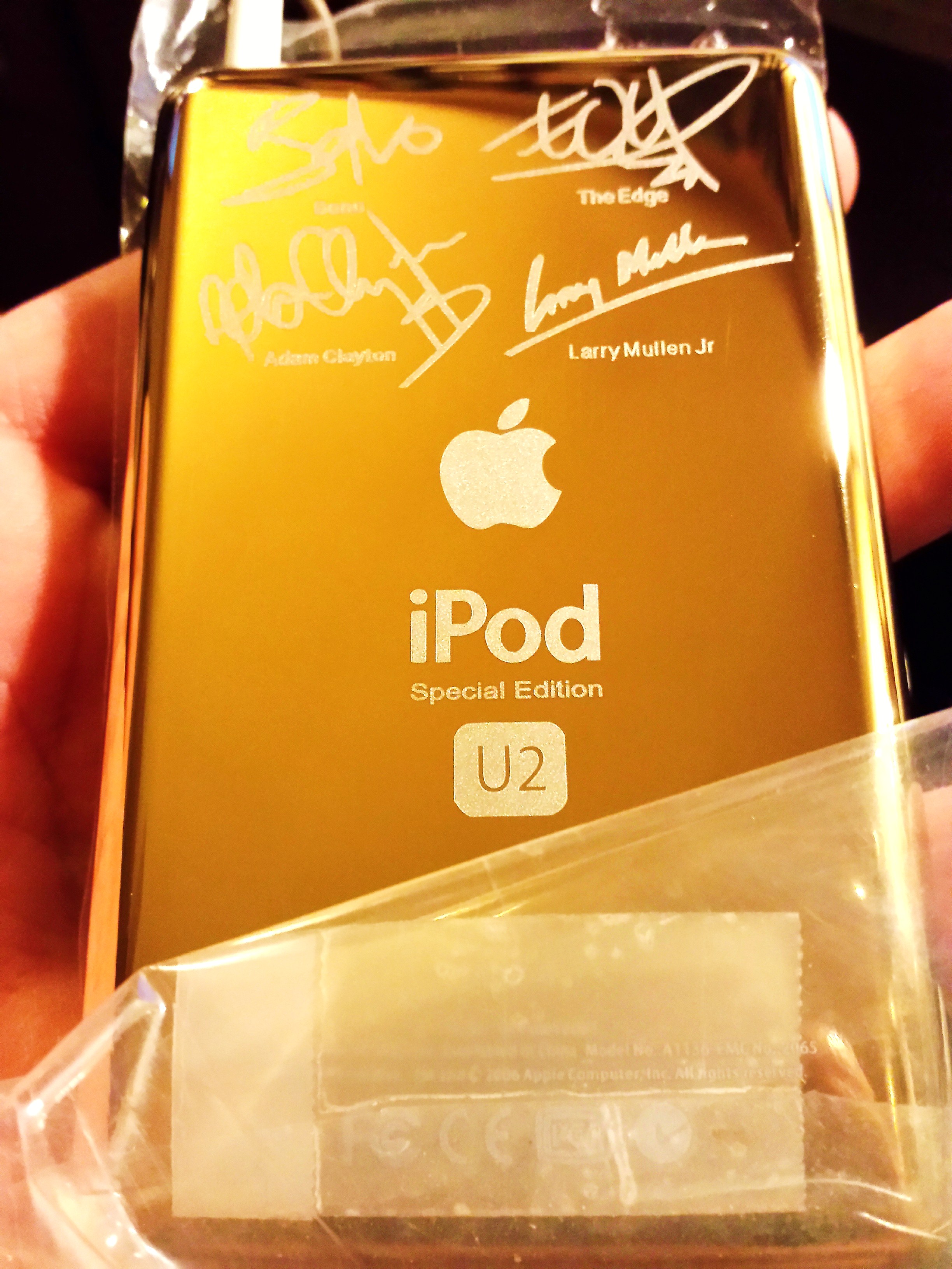

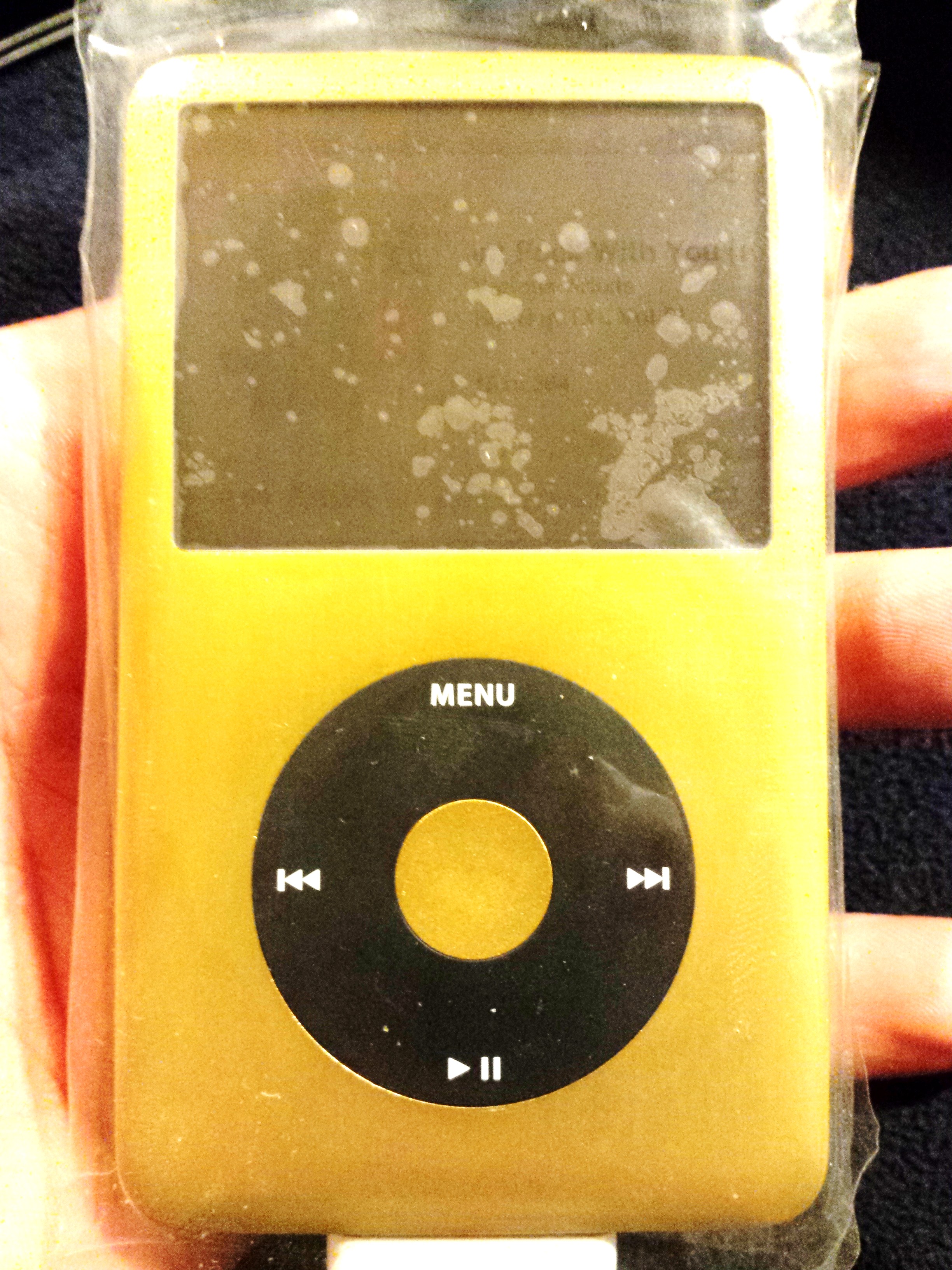

if you'd like. I posted some pics of some of the latest modded ipods I've built.
These are the "gold series" models I've done. Both of them have been modded
to a 256gb samsung 1.8" ssd (solid state drive) and a 1900mah battery.
I ran a play test on this battery with a full charge to see how long the battery
would play on one charge on around 2/3's volume. It played for over 110 hours
before battery finally died. Every part is brand new except for the motherboard
and screen. I'll reuse the screen if it's still in good working order. Let me know
what you think of em....

I do like your work, particularly the black click wheel on the iPod. I'm actually down in Cincinnati, so when I have time I'll try to make it the the Apple Store here or one of them around here. Thanks for the offer, I'll definitely keep it under consideration. Does anyone know if there is a way to slow the imminent failure? I had an 80GB Classic years ago that did the same thing. It would start skipping songs or only play half, then eventually took multiple hours to sync. Luckily i have a spare that i bought after they cancelled, but I would still like to have this current one working well.

Update: I made it out to the Apple Store Genius Bar yesterday and they came to the same hard drive conclusion. I could either ride it out until it goes further or pay he $129 repair fee. So $129 later I have a brand new classic, and the customer service along the way was great. Thanks for all the help here!
when you say brand new, did they give you a sealed in the box classic as in really 'new' and they did not just change your hard drive?
The thing is a brand new white box replacement, it hasn't even been powered on yet and it is sealed in the plastic wrapper. They do not repair iPod Classics, just issue new ones under the $129 repair price
then that's a great deal for $129. can't beat the price. i just hope when 1 of my 120GB classic HD fails, they will still have stocks. i got 2 120GB and i replaced the HDD of the other one. still a good price as i was able to buy a HDD for $35. but if i have a choice then, i would have done it a long time ago on my 1 failing hdd. didn't know they have that process. congrats on your new classic.
I have an iPod Classic, that is experiencing signs of hard drive failure similar to my old 80GB that died a while back. It is a 160GB Gen 7 Classic and upon the least sync to add 4 new songs and to include a new playlist, it will play 2/3 of one song, skips one, and the other 2 play as normal. On the new playlist, it will skip certain songs all together. So i have a couple questions. 1, Am I correct that this is hard drive failure? 2, Is there anything I can do to have the Apple Store near me repair/ replace it? I understand they won't repair it, but is there an out of warranty replacement option that I can use? I would prefer to pay to have it repaired for their white refurb box ones rather than do it myself just yet. Thanks for the help!
Yeah, Apple will still do the swaps for a "new" 160GB one; doesn't matter which gen of classic you have. Though, I'd give thought to trying to mod it with flash storage; those hard drives really suck.
