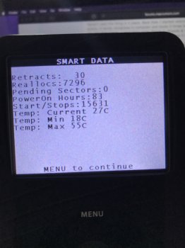

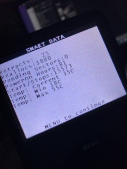

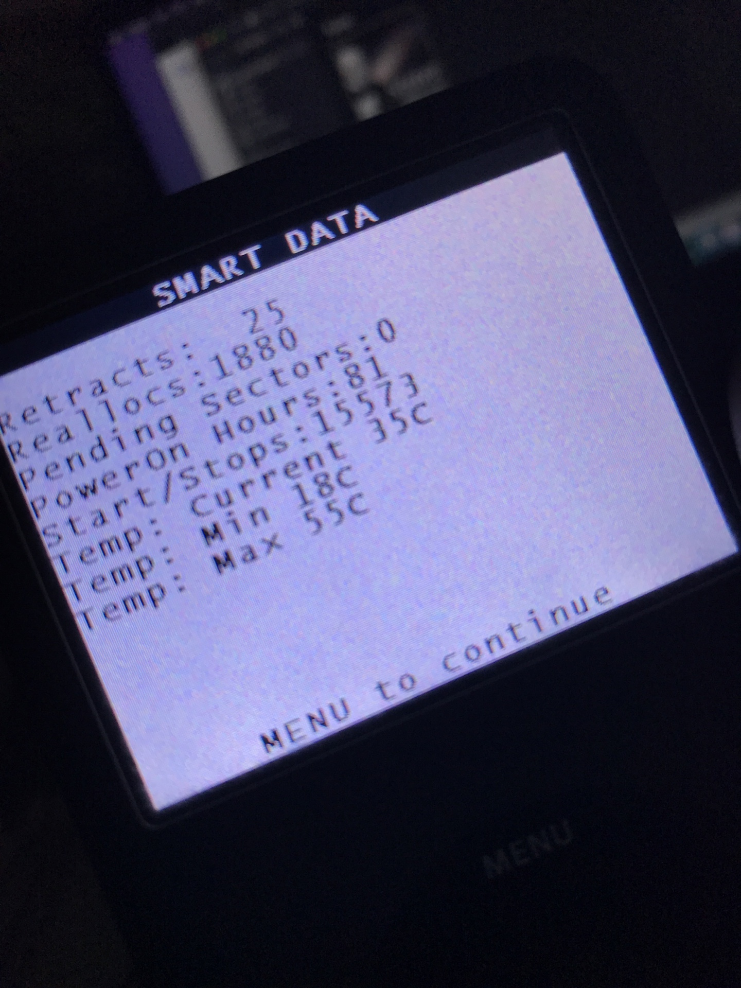

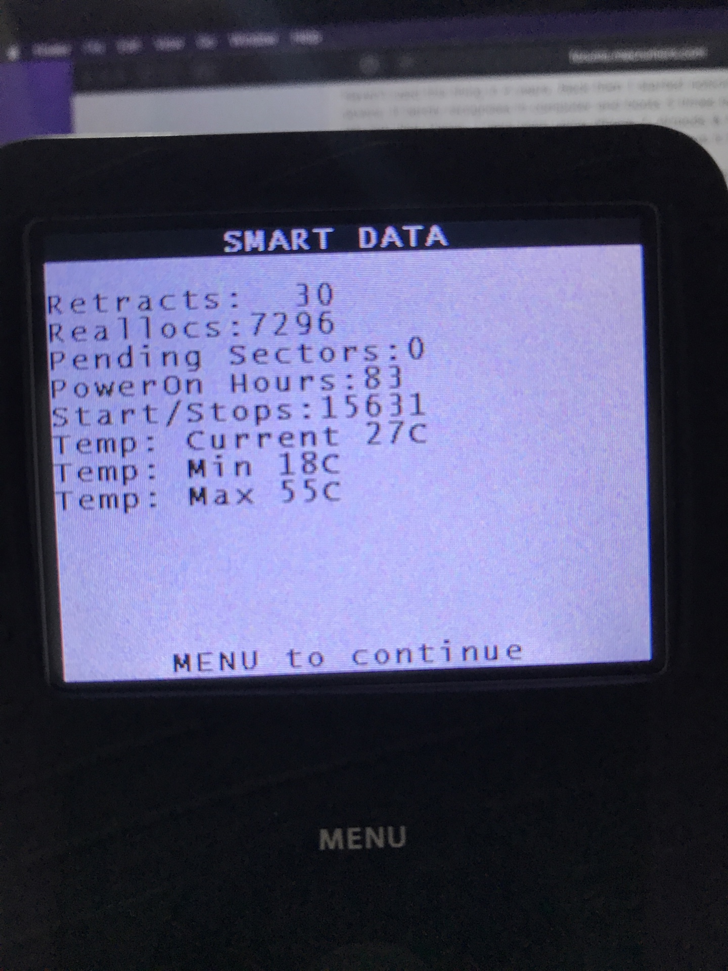

Haven't used this thing in 4 years. Back then I started noticing some HDD related issues & now it seems way more severe. It barely recognises in computer and boots 5 times before gettingg to home screen. It's very bad. It's a 160G last Gen iPod Classic. I have been using iPhone 7, Airpods & Macbook Pro for past few years & don't necessarily want to go back to using the iPod fully. But I would love to have it fixed only if I can do that cheap.
Any suggestions as to what I should do to repair or sell would be appreciated. Thank you.
I'd chuck the old hard drive and replace it with an iFlash adapter plus an SD card. Check them out here: https://www.iflash.xyz/
The only thing to be wary of is that the iPod classic is a little tricky to get open, as it has metal clips on the back case that hold the faceplate on. But once you get the iFlash in you'll wind up with a more reliable and power efficient iPod in the end!
