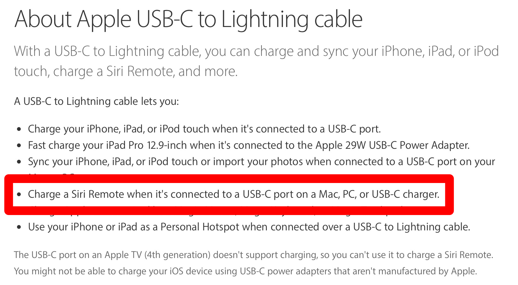

To further illustrate your point, using a 29W adapter to charge something as tiny as a Siri Remote is kosher in Apple's book... talk about overkill! 😀
Oh yeah, forgot about that. Nutters 😀
