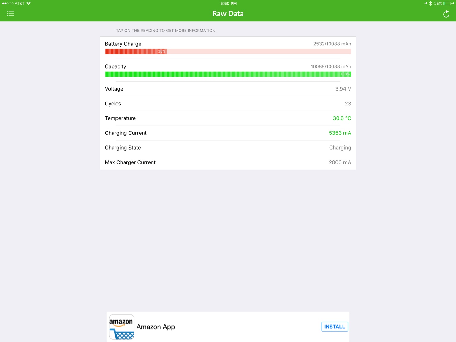

There is an app called Battery Life that shows charging current in mA, and I'm no electrician but if you know the charging voltage (I think it's 14.5V on the 29W USB-C charger?) you could do P = IV to work out the charging wattage?

EDIT: Apparently the Google 60W USB-C charger only supports 5V/12V/20V over 3 Amps. The fast charging requires 14.5V and 2A. @masotime: Does that mean that the iPad will take 12V and up to 2.41A to make up for the lower voltage, or will it fall back to 5V (and therefore charge slowly)?
Unfortunately it depends on how the iPad negotiates with the charger to set the voltage / current. Actually now that I see @Southern Dad's screenshot, I'm pretty confused. The iPad Pro isn't supposed to charge at a high current, so I'm not sure what's going on now with how it charges. Possibly the app itself is able to read the charging power and is erroneously dividing it by 5, since 5.3A * 5V = 26.5W, which makes sense if it is charging using the fast charger.
