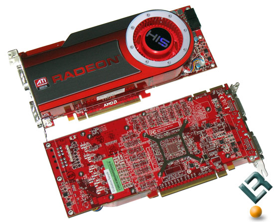

Exactly. Any 4870 which looks like below (notice AMD logo on PCB, not all red PCB are reference):
will be immune to all updates (present and future).
Reference cards (or very close to) flashed with untouched OEM Apple ROM are safe.
XFX HD4870, HD-487A-ZHDC.
