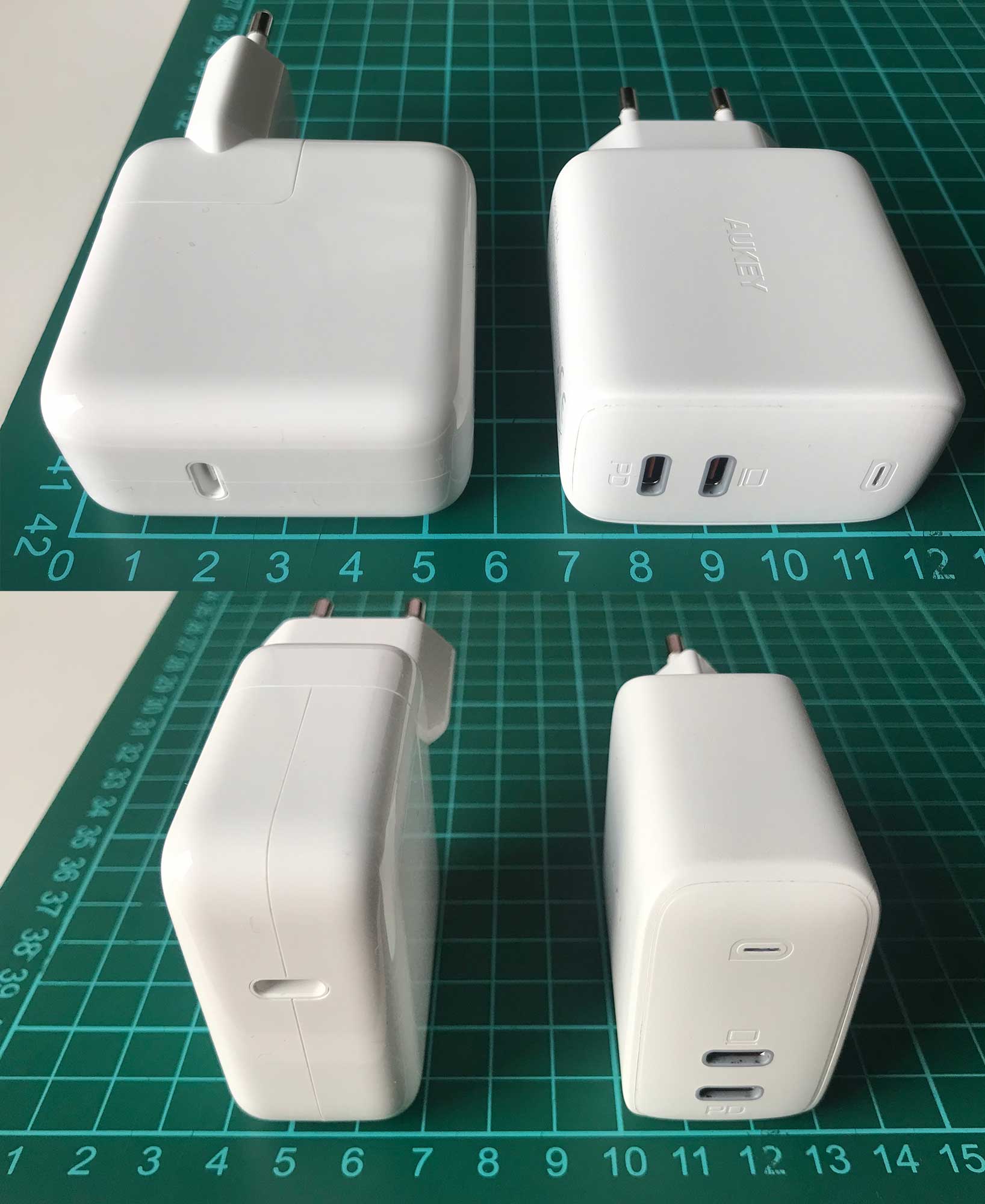

It’s not like the supplied USB-PD 30 Watt charger is large by any means. I do have this 65 Watt GaN charger for comparison, which is slightly smaller.
I have to ask to why you would use a slower charger?
You want a slower charger because it's like a third of the size of the supplied MacBook charger. Look at the size of your iPhone charger, it's about that size which is much more convenient to carry around if you are on the go.

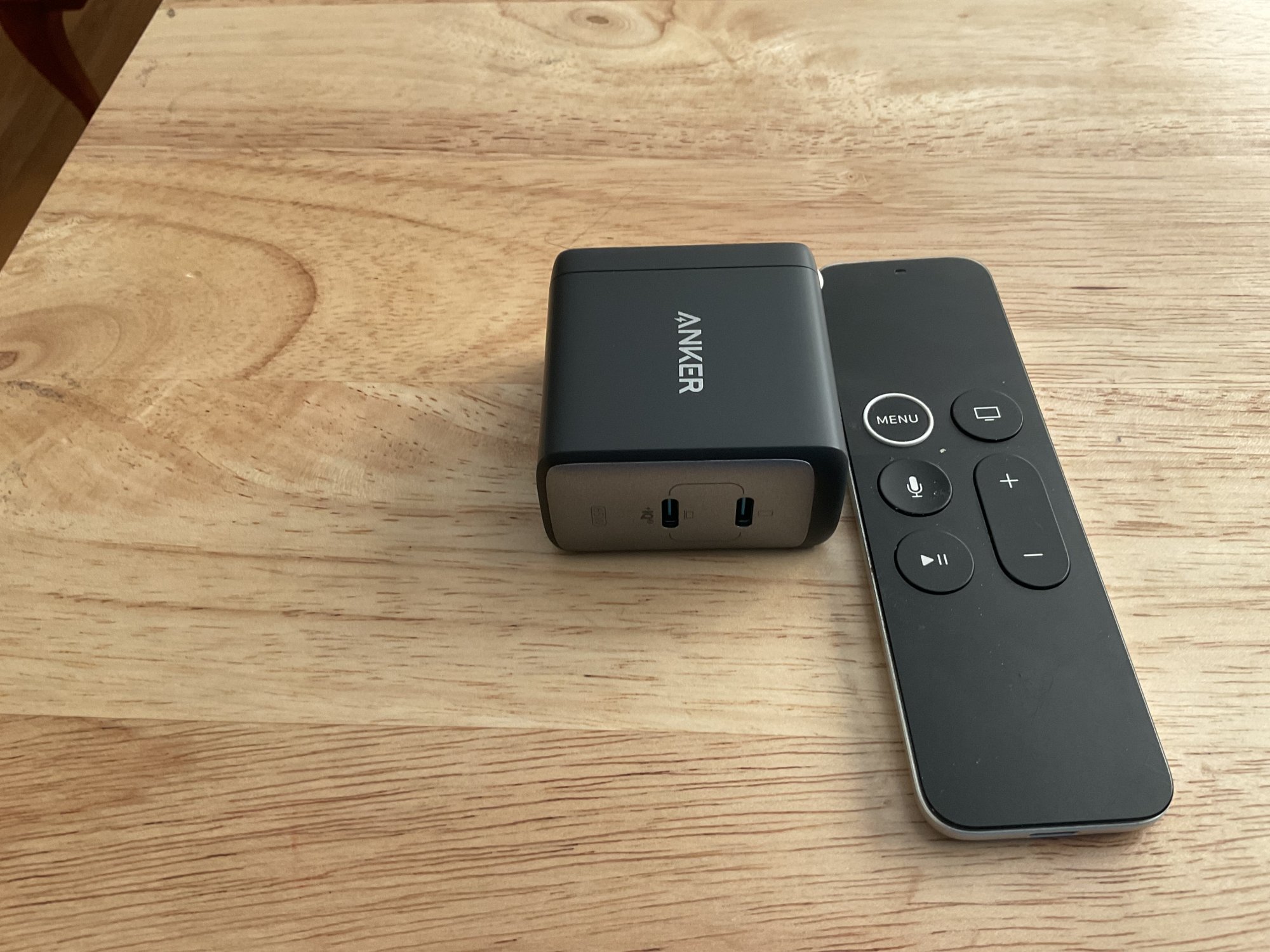

I don’t carry the OEM power brick when I travel(ed?). I use a small GaN charger about the size of a phone charger and charge the phone and laptop from that.
