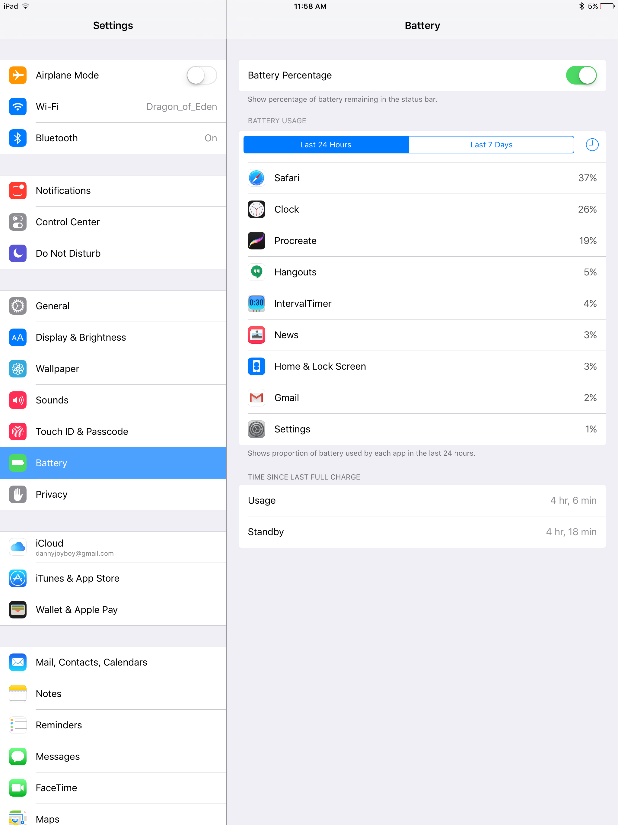

i live and work in bright environments. anything less than 100% brightness is difficult to see. today i killed my ipad pro 12.9 battery in a little over 4 hours, just using the timer for my workout, and a little light duty web surfing. is this normal? anyone else use this thing during the day? it also gets pretty warm. im wondering if mine is defective. i get roughly 8-9 just surfing at night on lower light levels.
this is a little frustrating, especially since it takes roughly 5 hours to charge this thing.
thanks for any input

Good news, I ran a looping video test overnight, using the information on apples website on battery life testing. I got 10 hours at 50% brightness. Just like it's supposed to be.
The bad news is you will only get 4 hours if you are in a bright environment like me. My house has southern exposure and lots of Windows. I run auto brightness and I'm still only getting roughly 4 hours. Obviously some of you are exaggerating about your new toys Getting 10 hours on max brightness.
