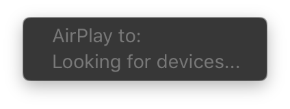

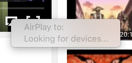

I am able to use AirPlay to stream music and videos from iTunes to my Raspberry Pi. However, it doesn't work from anywhere else. All I get is:
Is this due to the fact that I'm not using an AppleTV or is it a limitation of our Mac Pros or is it an El Capitan issue?
Thanks in advance.

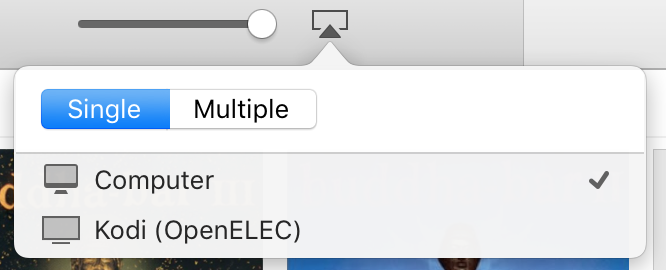

Again, AirPlay works fine with iTunes:

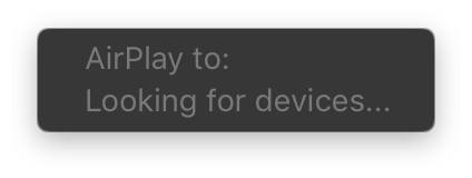

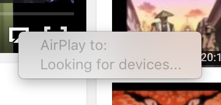

Thanks in advance.

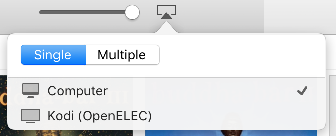

I want to know why AirPlay works in iTunes but not for QuickTime or for YouTube in Safari.
I'm not trying to do AirPlay mirroring. I'm just trying to AirPlay from QuickTime and Safari.
For example, if I open an MP3 file with QuickTime, I only get "Looking for devices..."
I don't have airplay buttons in either of those apps that I can see?
EDIT: I see it's a new feature in El Cap, that'll be why I don't see it!
Hold Option and hit the speaker icon and choose your airplay device.
Airplay always works (Audio) except for video on cMPs.
That's changing the audio output of my Mac to AirPlay. That's not what I'm trying to do.
When I play music in iTunes, I can choose to have the songs played through AirPlay directly from iTunes. All other sounds continue to use my regular audio output device.
So, songs can be heard from the speakers connected via AirPlay and Mac system sounds etc will continue to play through my computer's speakers.
In QuickTime and when watching videos from within Safari, there's an option to play through AirPlay, however, (at least for me) it only stays at "Looking for device..." and never actually finds a device. Meanwhile, iTunes finds the AirPlay perfectly fine.
