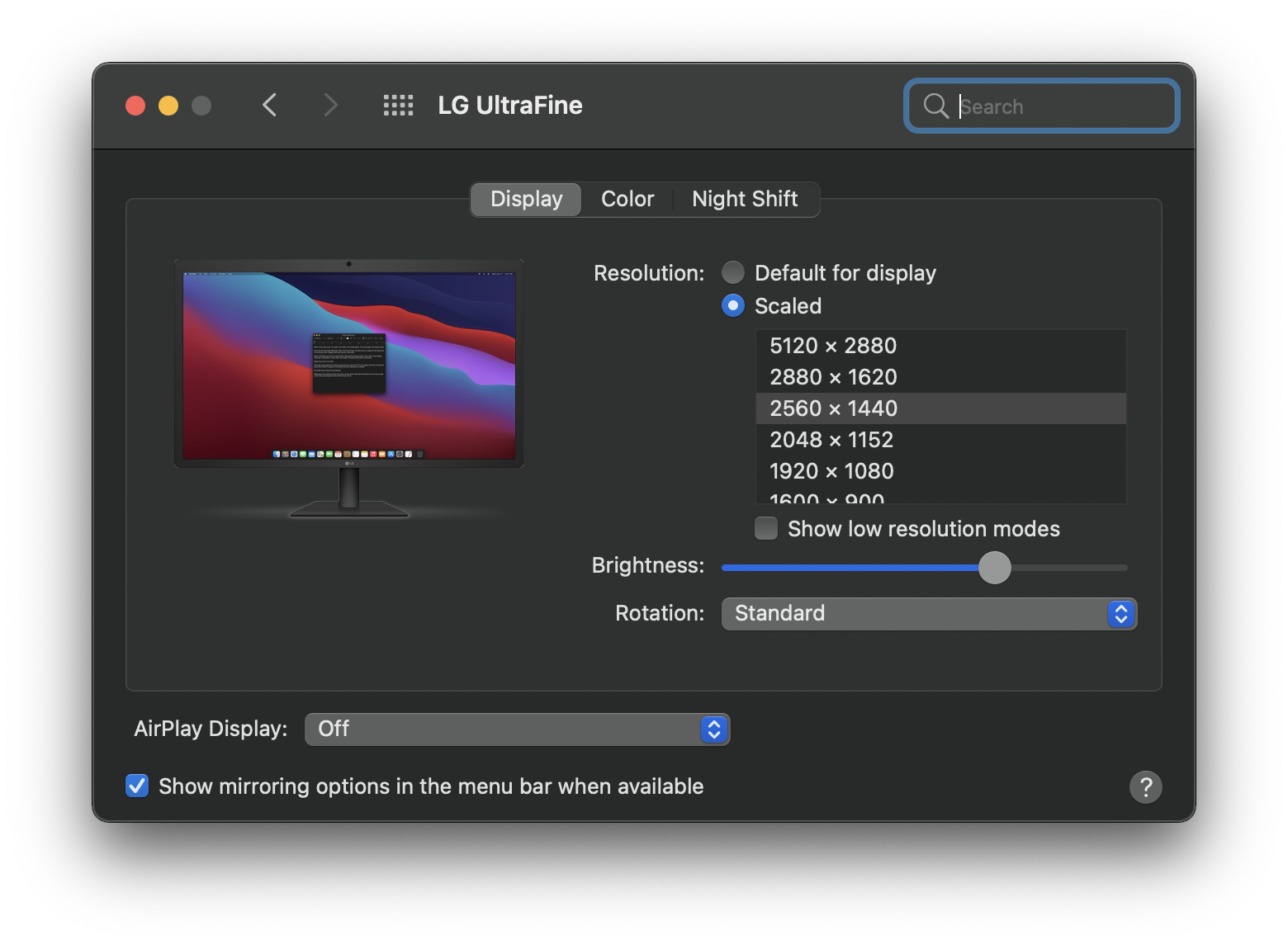

Which resolution do you run it at? Can you screenshot the scaled options? I no longer have 3200x1800 as a scaled option.
If you hold the option key while clicking on Scaled what resolutions do you have available?
Thanks!
Thanks!
3200x1800 appears to be gone, but I run at "looks like 2560x1440" (hi-dpi).
Reactions: itsphilgeorge
That would require a frame buffer of 6400x3600 and the M1 can't apparently make one above 6016 pixels.
So the 6K really is a hard limit.

The issue is around the availability of scaled resolutions. If you connect your Macbook 16" to either display you will notice there are more Scaled resolutions to choose from than you get using the M1 Mac Mini. For some of us, who used the other scaled resolutions, this has effected workflow.

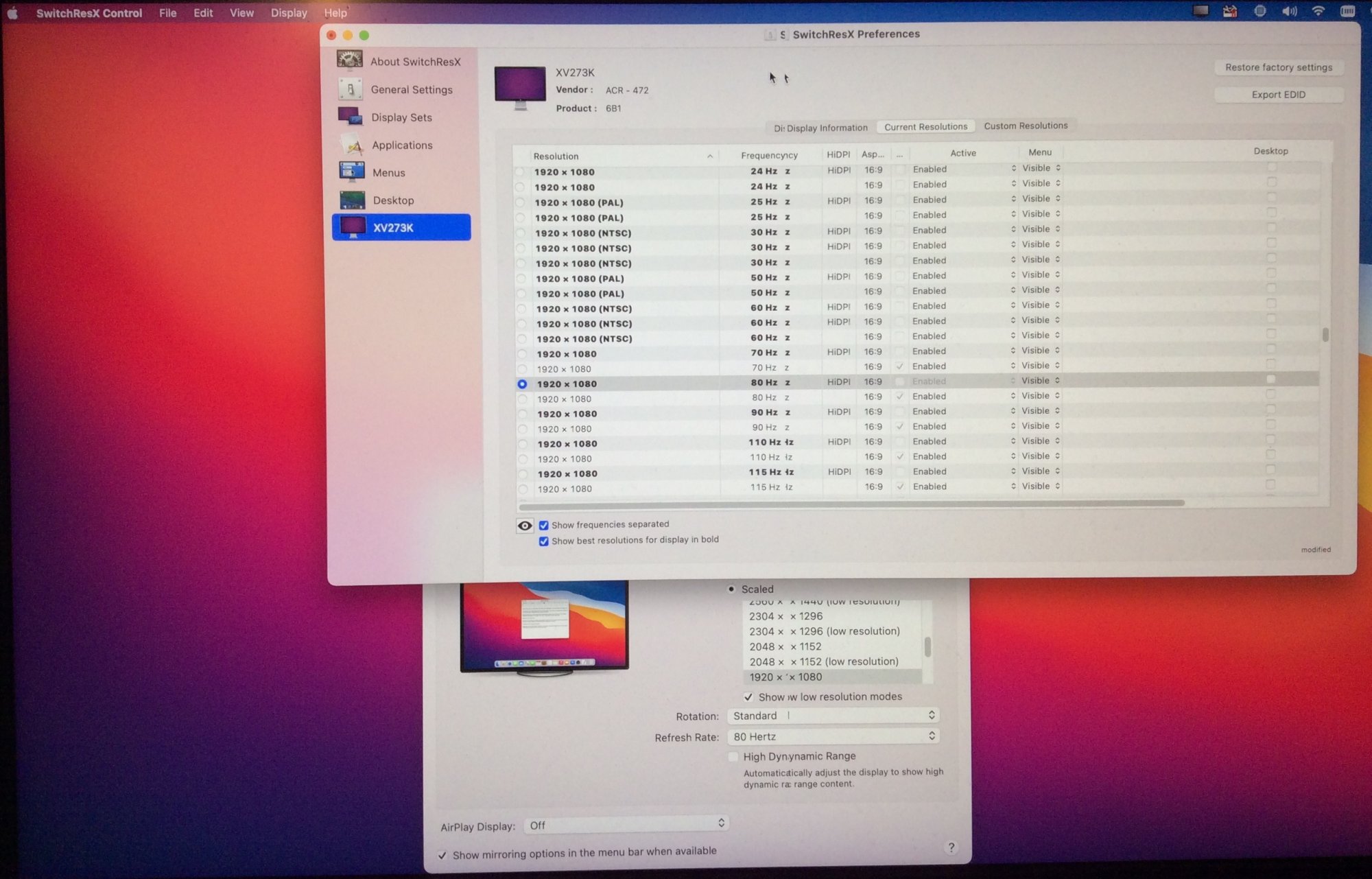

I've got pixel shifting on my Mac mini 2018 with W5700 eGPU in Big Sur when I do 4K 80Hz or higher refresh rate. It's a horizontal shift to the left of the left half of the display such that the middle 16 or 32 pixels is duplicated. The problem does not occur in Catalina.
In the picture, you can see the Apple menu is shifted to the left and there's a column of duplicated pixels in the middle.
