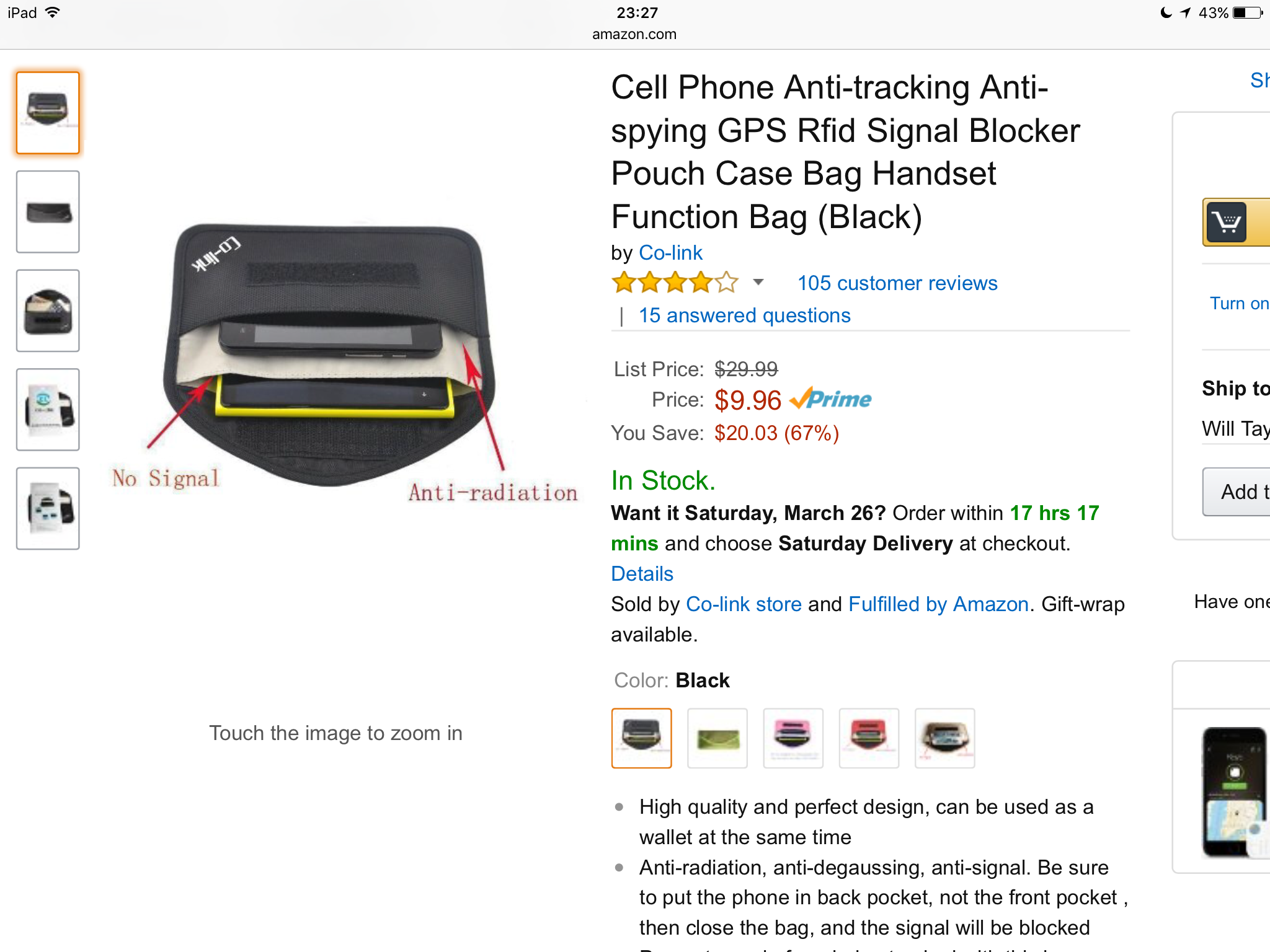

Could have anything to do with a recent purchase of a male, European carry-all?
http://www.amazon.com/Anti-tracking-Anti-spying-Blocker-Handset-Function/dp/B00ITR3KCQ
Couldn't you just turn it completely off and get same results as the pouch.
Anyone turning the phone off, please send me $6.96 as I just saved you three dollars over the pouch.
but how can you be sure that there isnt any activity althought you have turned it off?
for a 9dollars you dont need to look stupid and walking wearing a tin foil hat outside.
