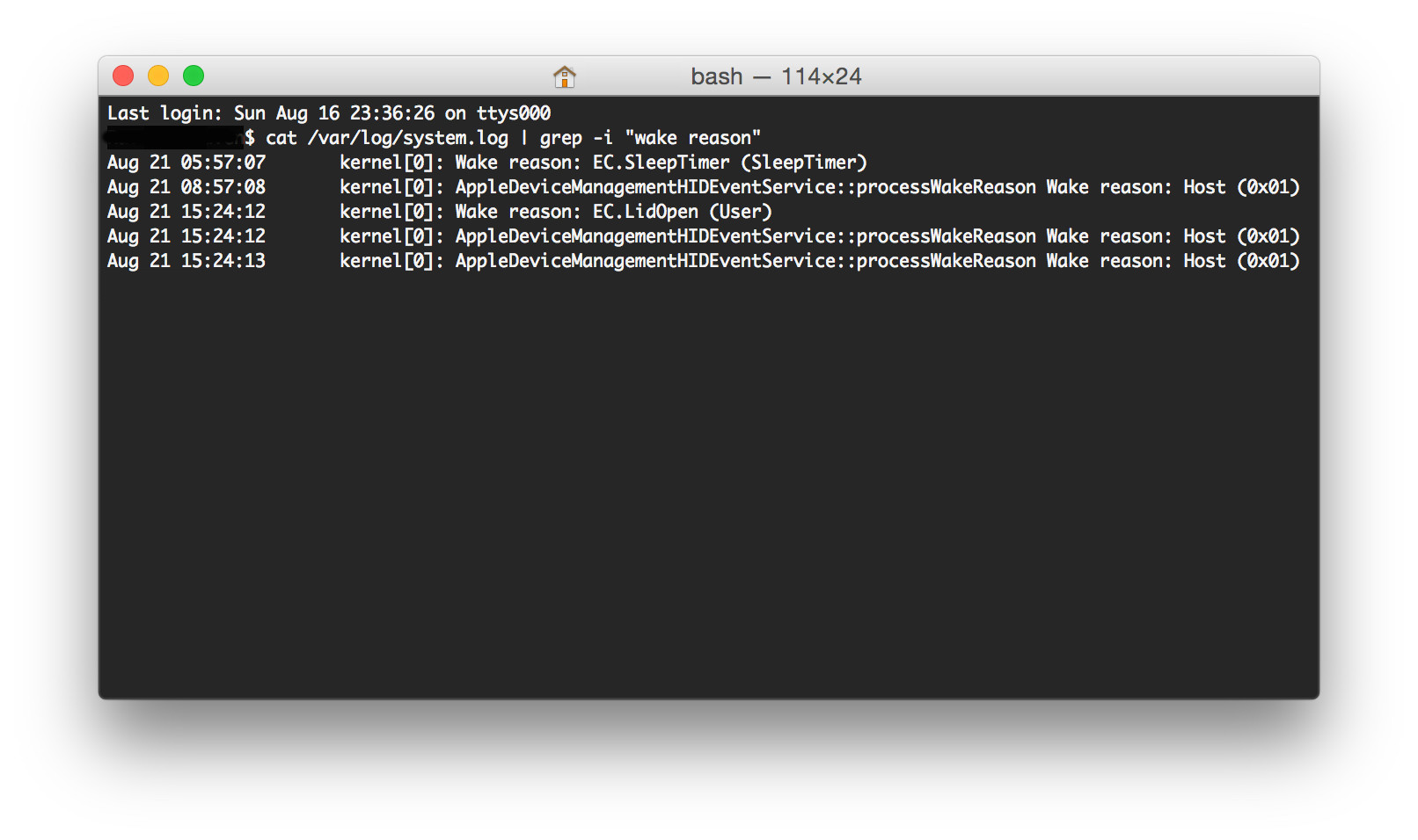

Leave it to sleep overnight and then run this command in Terminal, if the issue persists. OS X does perform tasks when the user is offline.
cat /var/log/system.log | grep -i "wake reason"

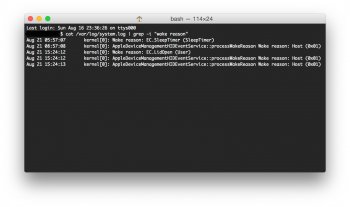

I't says its waking up like 10-15 times during the night, the most common being ARPT (network).
I've attached it below.
Nothing unusual other than the frequency, leave it to connect and see if that will help to resolve.

How do I make my mac not sleep? I've changed loads in the Energy Saver preferences yet after 30mins or so the screen still locks and i need to enter my password again. Also, what does EC.SleepTimer mean in terminal? That seems to cause my mac to wake up more than network reasons now.
Select do not sleep in preferences, the display will turn off, however the system will remain powered up. EC.SleepTimer is part of the Sleep preferences and can cause some users Mac`s to prematurely wake up to change system sleeps states. The system should transit to a deeper level, clearly yours is not. Rather more a vicious circle as it`s being woken prior to fully hibernating with the timers resetting, likely by network access and or an application that will prevent the system sleeping.

Did you check the "wake ups" as that will help to narrow down the occurrences.
As you can see my rMB rarely wakes, barring shifting "sleep states" and occasional OS requests. Admittedly "Wake ups" plague many peoples Mac`s and are never straight forward to diagnose. If the wake up`s are related to the Network turning off WiFi is a workaround, same applies for Bluetooth devices. Other options include forcing the Notebook to fully hibernate far sooner than Apples default of 3 hours, which can work, equally it does not resolve the root cause for obvious reason.
