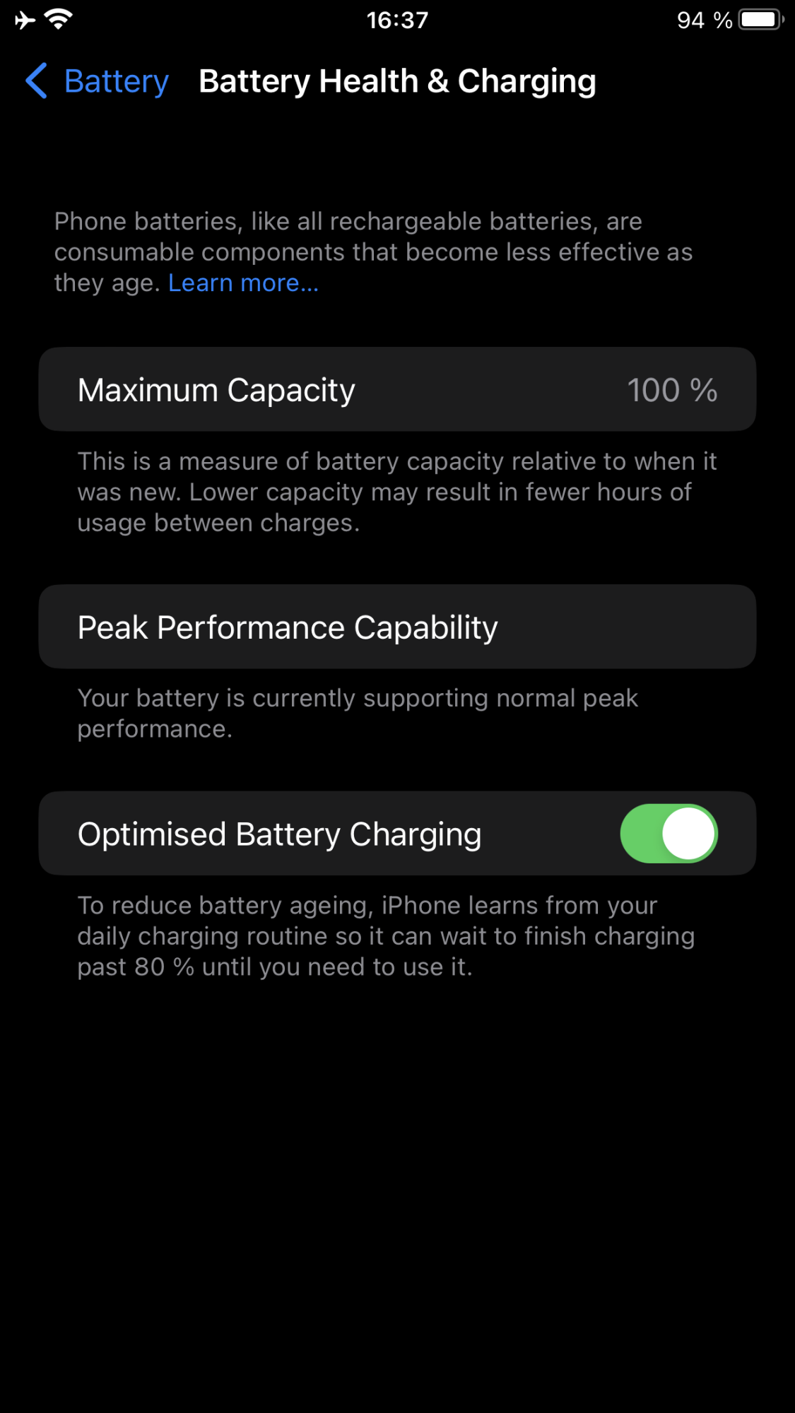

Me personally? Starting from the iphone 15 (IIRC), you have a battery setting option to limit the charge % from 80% to 100%. It's trivial to adjust this setting to suit your needs (ie see my example above)...
But I appreciate some people just want their phones 100% charged every time it's removed from the charger. If that's what they want, all good by me...

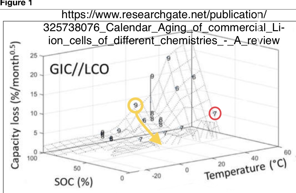

If you believe the credible/corroborating battery research, time spent at high state of charge is more harmful then high heat. Eg, 100% charge at room temp will degrade the battery faster than 75% charge at 60c/140f.
Also, is it ‘micro-managing’ if all I do is plug-in once/day at bedtime time and let a shortcut automation/smartplug handle my charge just before I wake? Here’s my 5.5yo XR on original battery. (Note: I have a usually efficient usage pattern of mostly lite apps, wifi, and efficiency-tuned settings.)
