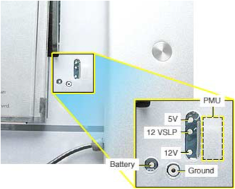

Test the existing battery, if you like - it needs to be more than 3.5 volts.

The later iMac G4 (known as USB 2.0 models, and can upgrade ram to 2 GB) have a battery test point on the bottom, without opening the case, just remove the metal cover.
page153image6278208
Black meter lead to Ground, and red lead to "Battery". Again, a good battery will be 3.5 Volts or higher.
(I suspect that your battery will be way low, and you might not measure anything at that point. And, that makes the decision easy, time to replace the battery!)
