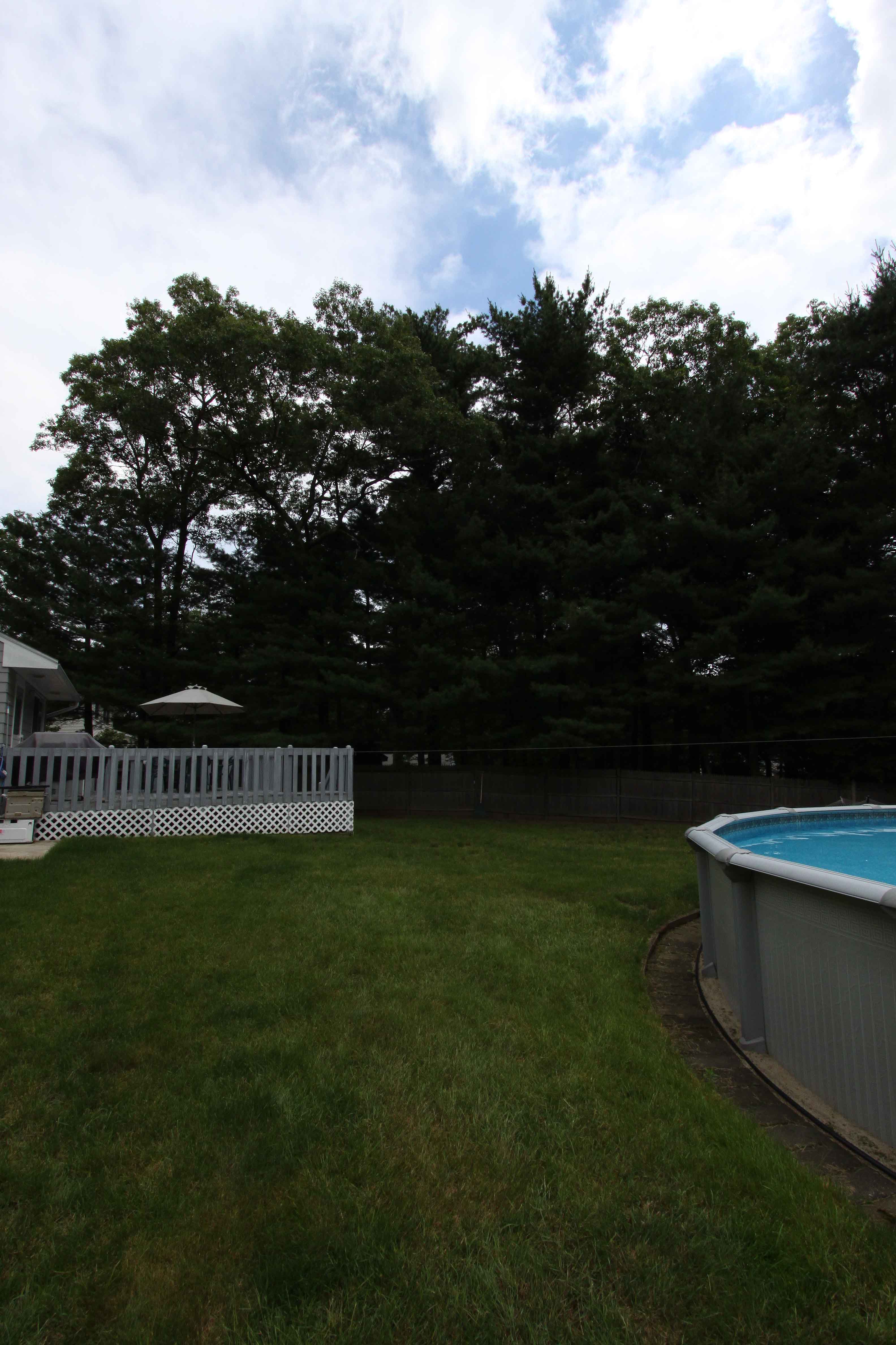

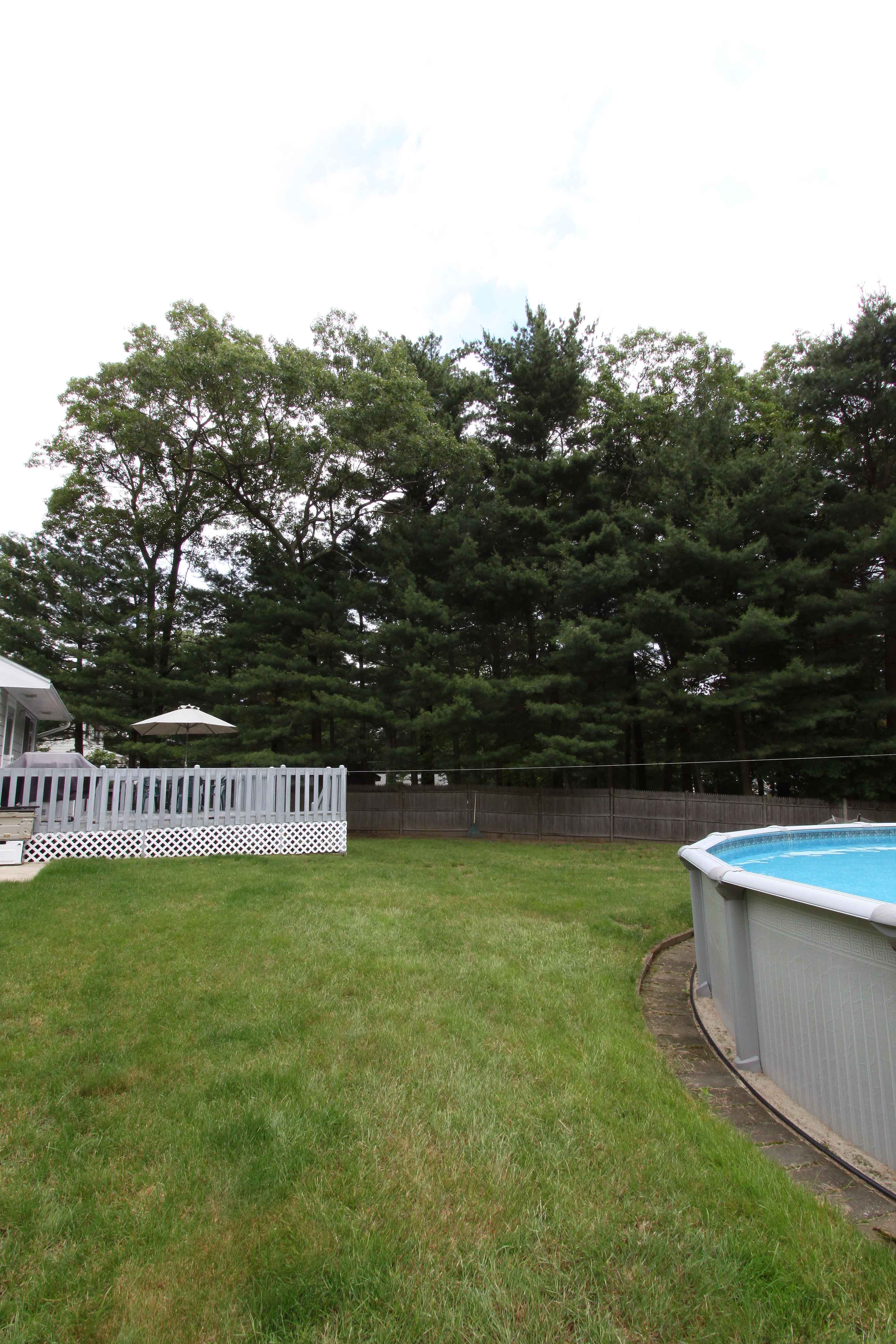

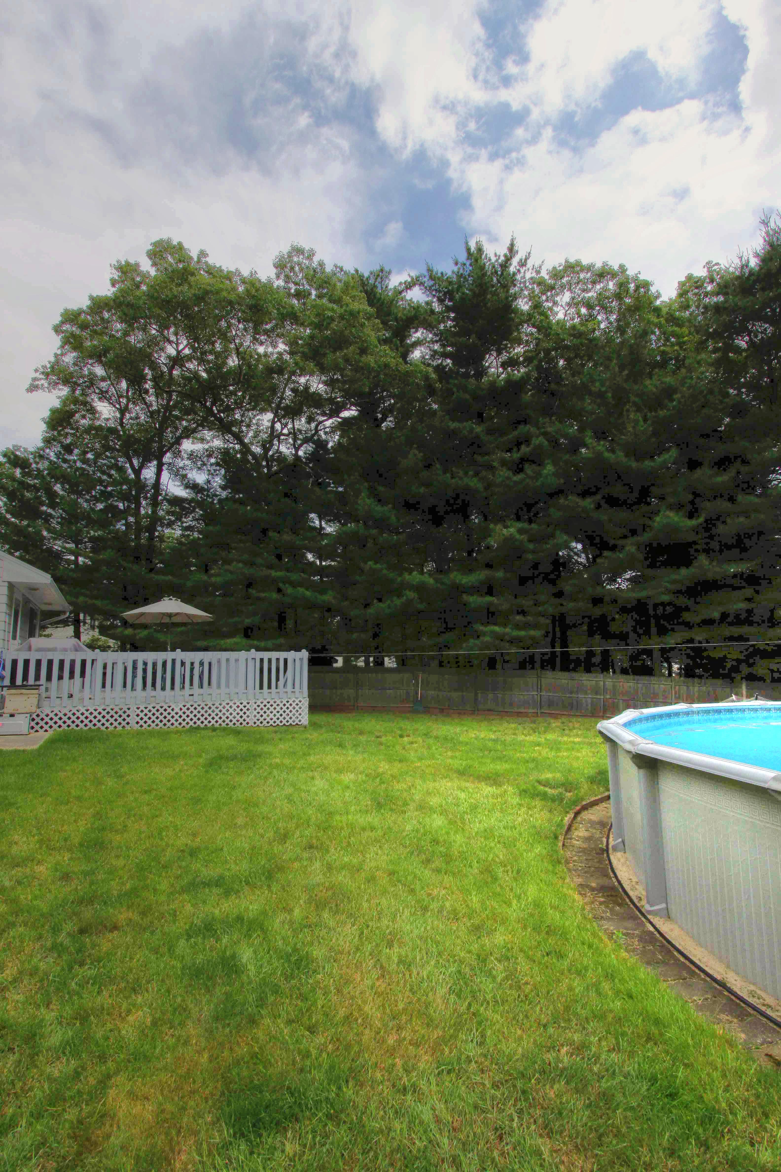

Here are some sample shots I took in M+evaluative metering mode @ auto ISO (400).
#1 - 1/100s @f/14
#2 - 1/320s @f/14
#3 - same shot (#2) after boosting exposure in the lower 4/5th using Ligthroom's Adjustment Brush
As you can see, the bright (albeit mostly cloudy) sky in the first shot is blown out, a big white blob! The sky/cloud details are resolved quite well in the second shot, but the foreground is clearly underexposed. I was able to correct this quite easily by boosting foreground exposure using Lightroom's Adjustment Brush. The converse was not true: I could not regain highlights/shadows in the first shot by reducing exposure in the top part.
The moral of the story is: it is better to base your exposure on the brightest part of your shot, since you can always fix the underexposed parts later. I suspect this is true of any lens, but it is definitely true when it comes to my 10-22.

Yup, now you're getting it. You need to expose for the brightest area of the scene. If you aren't already, shoot in RAW, that way all the data that the image sensor can capture is still in the file & can be boosted.
Programs like Photomatix can also be used in post processing to blend multiple exposures to achive maximum dynamic range.
Like so...
This is just a quick & dirty example from a single jpg, it can be done much better from multiple exposures of a raw file.
Not if the shadow areas are more important than the highlight areas. Recovered shadows can look dreadful. Sometimes you have to sacrifice parts of the scene, sometimes that can add to image, other times it won't.
BTW You had room to do another exposure between the two you did [1/200th at f14] and the highlights may have been OK in that one too and the foreground less dark. if you really want to retain highlights, expose so they are nearly overexposed and you can also use fill in flash [depending on subject] to brighten up foreground. This is why you see people using flashguns in very bright sunshine.
But the problem in first few shots was as several people pointed out, they were way overexposed. A simply way to get a good baseline exposure is to take reading off palm of your hand [in same light as scene] and add a stop extra. So if hand reading says 1/500th at f8, shoot at 1/500th at f5.6 or 1/250th at f8 or any other variation of that exposure. You may have to tweak the fudge factor depending on your camera's metering and your own hand colour, but try that as a starting point. It was 2/3rds extra on my Olympus film cameras for example and 1 stop on my Canon DSLRs.
It has nothing whatsoever to do with the lens you are using.
P does not mean Professional.
As others have mentioned, the sky is very bright and the black bus is very dark. You can't have both things exposed perfectly in the same photo. In this case your camera decided to properly expose the bus at the expense of the sky.

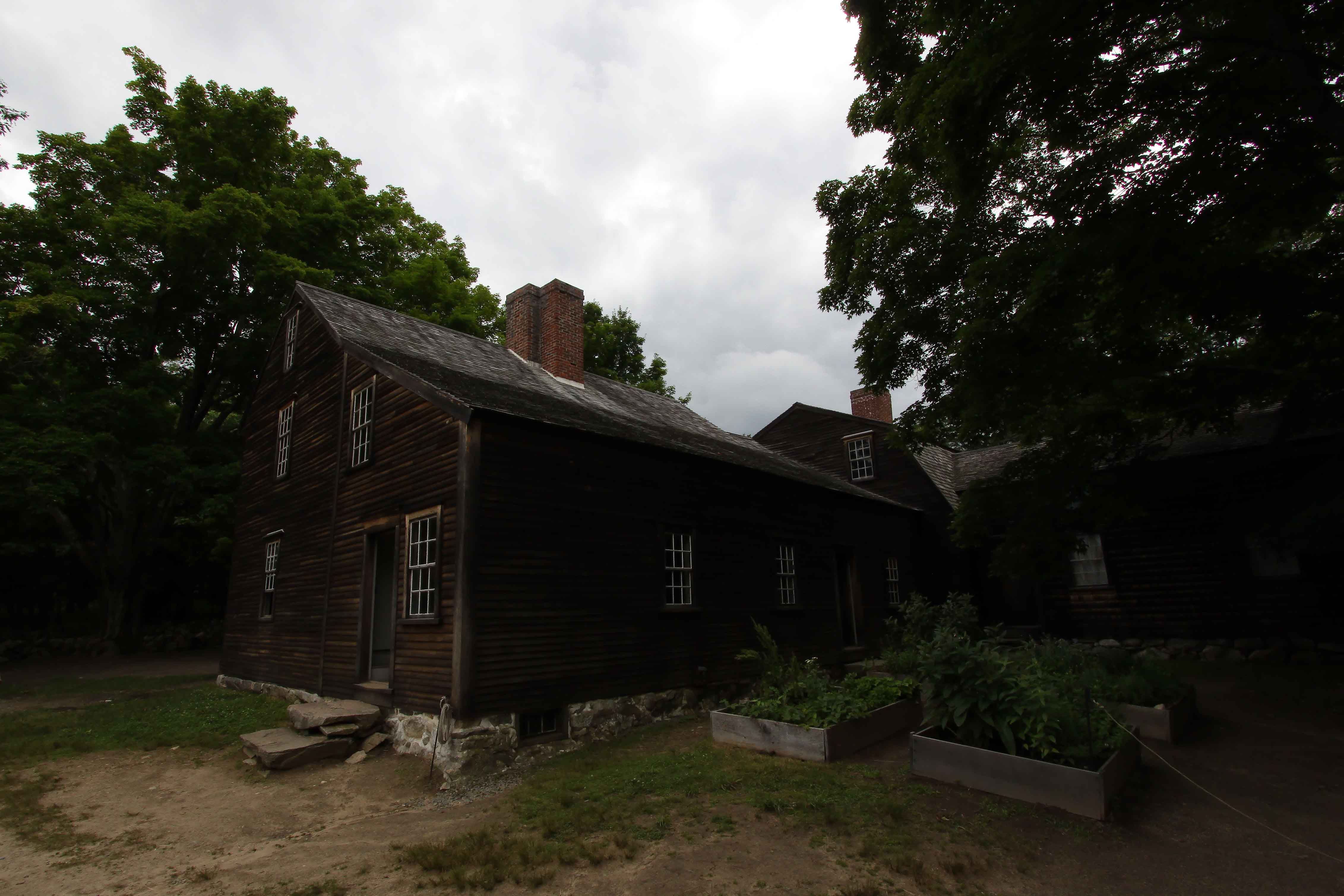

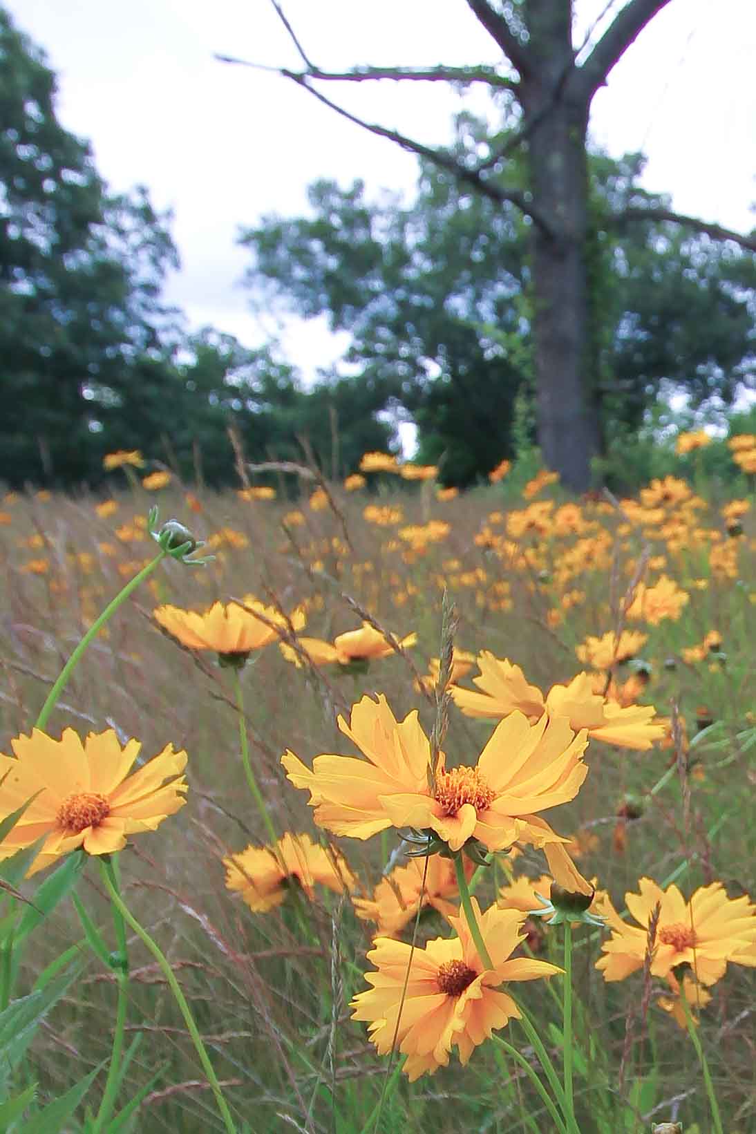

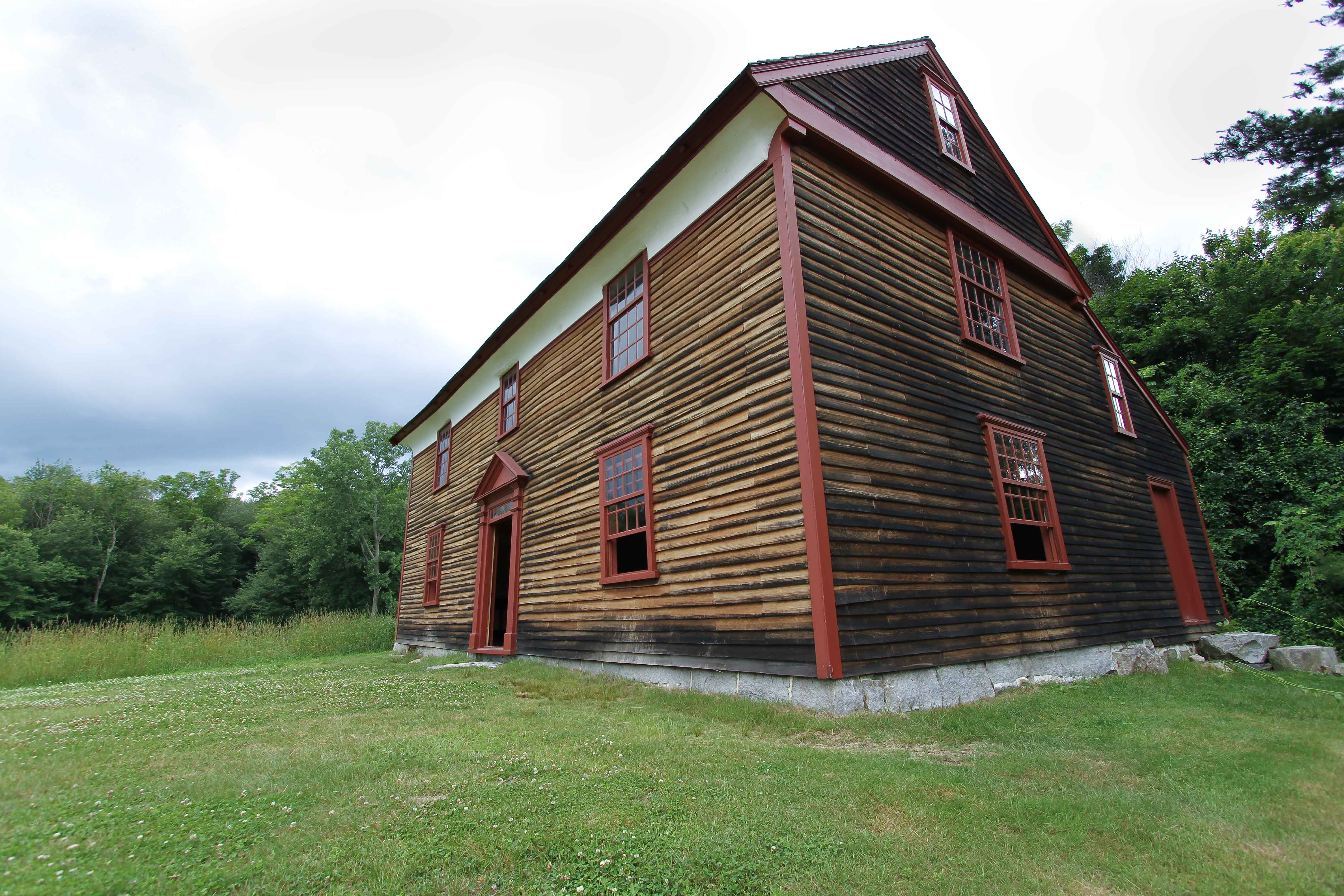

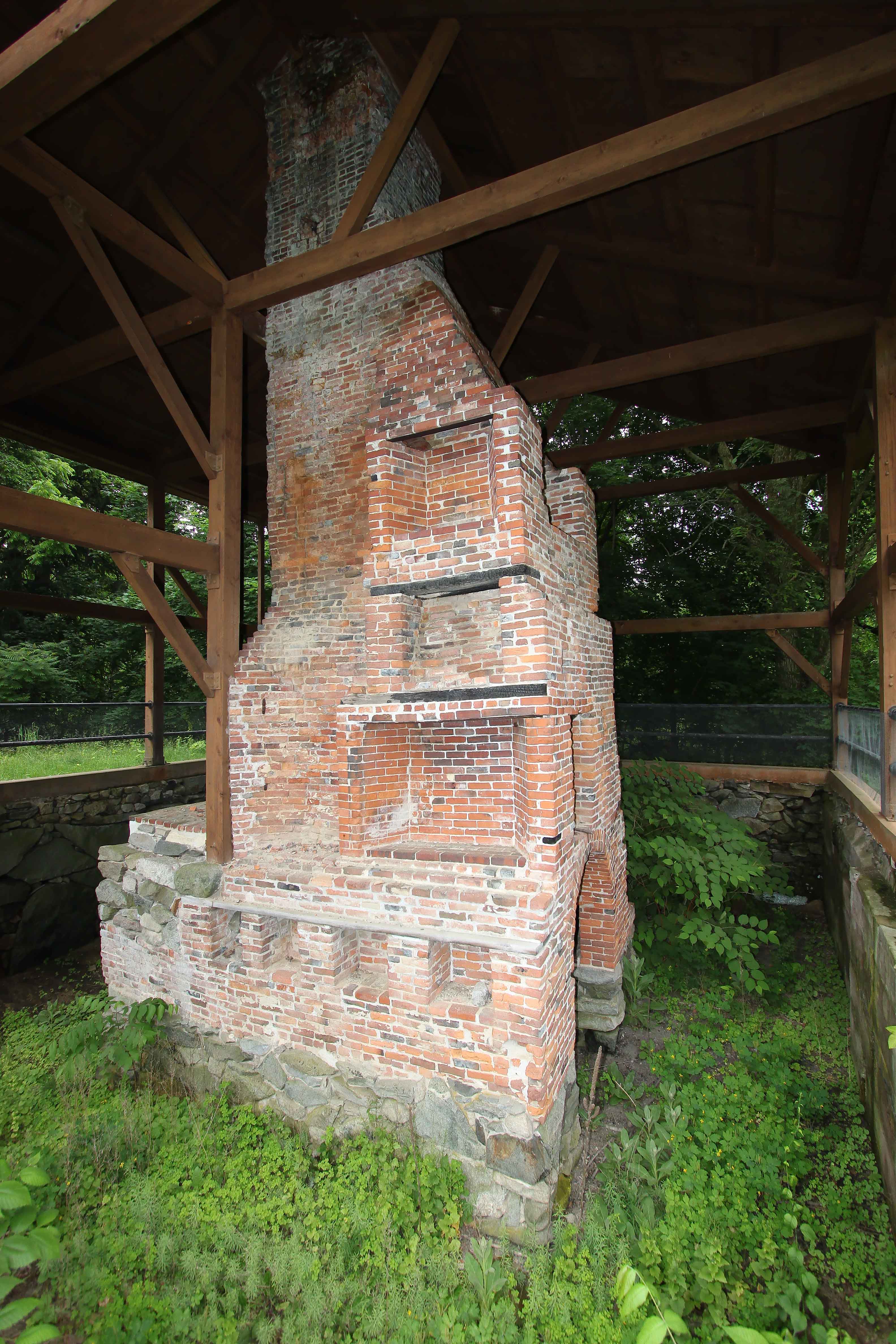

Here are a few more shots I took with my 10-22 today (all hand held). The first two pix are the same shot, the only difference being that I boosted #2's foreground exposure in Lightroom. Not the sharpest pic, I know, but a good save nonetheless, I think.
The other's are my money shots for today. The chimney (all that remains of the house that surrounded it) is about 30' tall, and I was standing no more than 10' in front of it -- amazing! The last one illustrates the great DOF this lens has (esp. when you consider this was shot at f /5.6 in a low light setting).
I've decided I'm going to keep my 10-22. It being so wide (i.e.,the probability of getting very bright and very dark components in the same shot go up exponentially) has taught me to appreciate the freedom afforded by the M mode. Also, the fact that I can save most of my prized shots in Lightroom, even when they are not perfectly exposed throughout, has reduced my misgivings about sticking with the 10-22. I realize I will use this lens for less than 20% of my shots, but I also know that I would be getting it in the next few months anyway, so I might as well keep it and get the 50-100 keepers that I otherwise would not be able to get on my upcoming summer vacation. In the meantime I'll keep saving for the 17-55 :)

I don't thing there is anything wrong with the lens. The problem is that there is too much light on the sky reflected toward the lens. You should always avoid framing your photos when the sun (sunlight) is a such sharp angle to the lens.
As others have stated, there is nothing wrong with your lens, try a graduated filter or try shooting under different lighting conditions. The camera cannot possibly properly expose both a sunny midday sky and a the building which is partially shaded.
