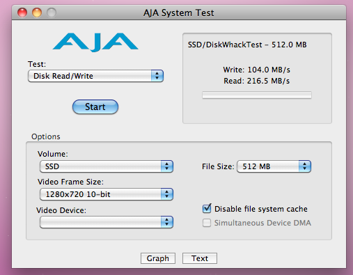

I have an Intel 120GB 510 series in my MBP. I know this is a Sata 3 drive and my comp only has Sata 2, but I should still have higher speeds.
Im not averaging the top 200mb/s speeds its states I should have. Link to Intel's page.
Should I do a wipe and re-install? Would that even help?
Thanks

That's a little slow. Not terribly slow, but a little slow. That SSD will be seriously throttled back by your SATA connection. The write speeds are more alarming than the read speeds. Have you tinkered with the AJA settings to see if they values change?

And yes, I tried many combinations on AJA, and I still get the same

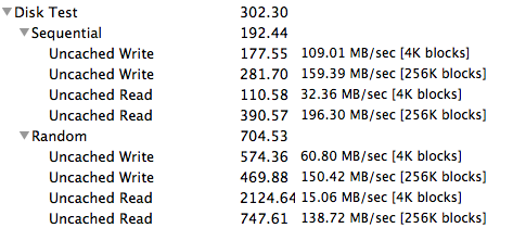

If not you would need to use a different benchmark. Try XBench for another free one.
xBench Disk Test. Im not really sure what all of those stats mean, but I do see all speeds under 200
