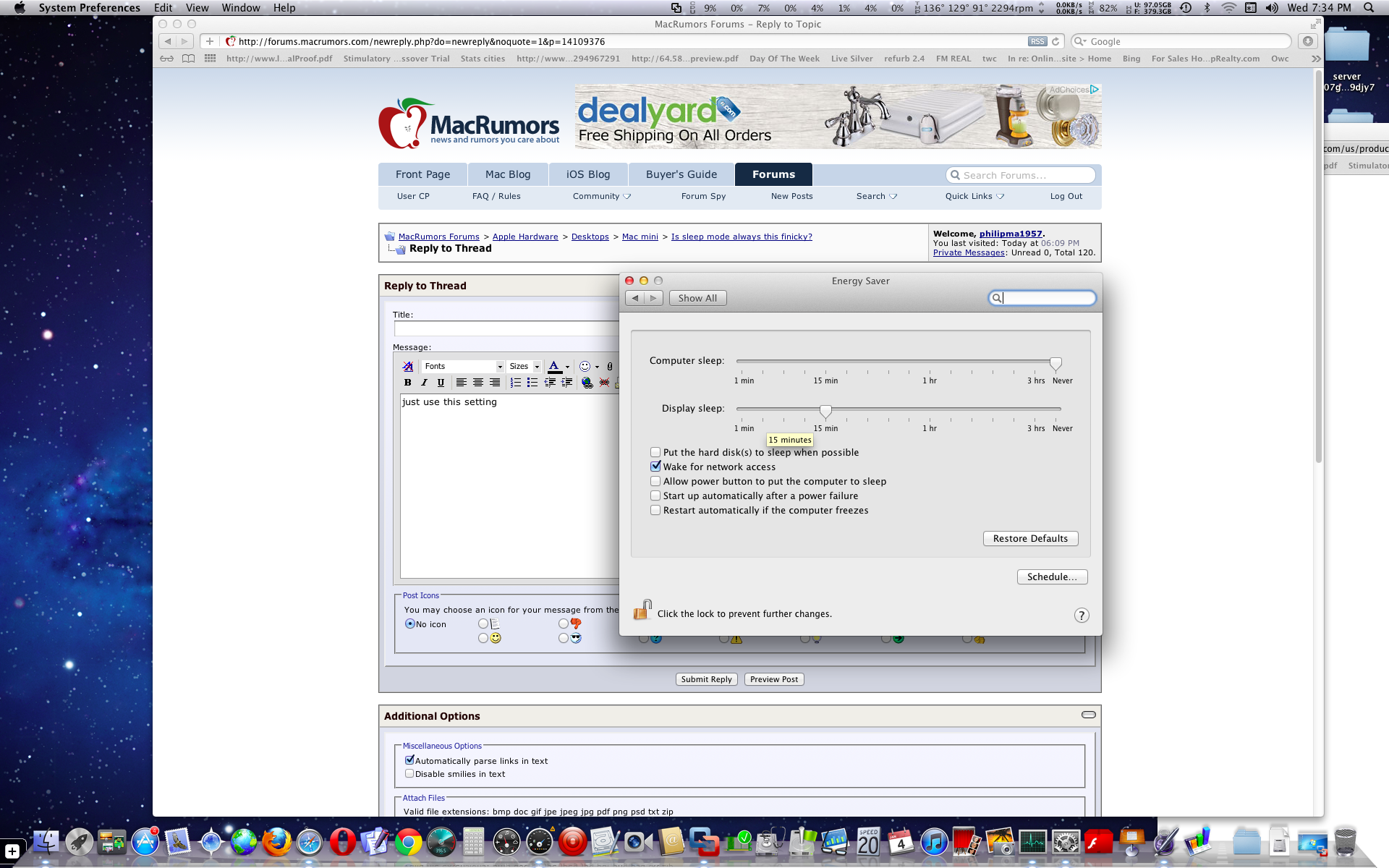

just use this setting. you save less then 75 cents a month if you put it to sleep .
Yeah that's how I have it sent now (no computer sleep, display sleep after an hour or so).

If you are setting your mac-mini to not sleep then I can't see the point of having "Wake for Network access" turned on.
Disabled "put hard drive to sleep" and "computer to sleep", only issue left is putting the display to sleep, which I'd like to retain if the monitor didn't go off like a strobe light every time the MM wakes it up from sleep. It should just work, grrrrr. In the meantime I've just instructed my parents to shut off the monitor when they're not using it for a while until I can figure this out.
