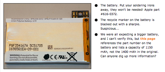

I just read this off of iFixit's site and it seems the 3G iPhone battery is lower in mAh than the original iPhone. 1150 as opposed to 1400. The battery pack is also supposedly smaller than the original's
*cough*
I was the one who pointed iFixit (and through them, everyone else) to the 1150 mAh battery with that part number.
No one still knows if that's correct.
More interestingly, someone else has pointed out that the part number for the original iPhone's battery, relates to a 1280 mAh battery, not the 1400 mAh that was first spread around everywhere as "fact".
1280 down to 1150 would be a much smaller difference.
(If ArsTechnica and the other pseudo-scientific sites were real, they'd take out the batteries and do some actual amp-hour analysis on them.)

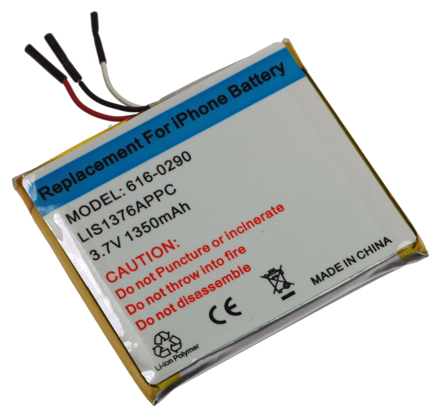

Interesting...i wonder why the numbers are different. Here on iFixit's site their replacement battery for the original iPhone is 1350 mAh. It also looks the one Apple ships out(Pic 1)

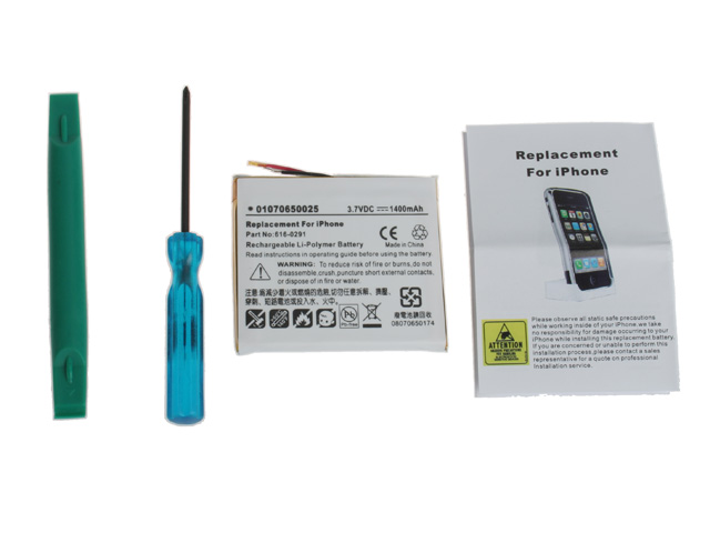

Another site called iPaq repair & parts says it offers a 1400mAh replacement battery and their battery also looks very much like the one that Apple ships out (Pic 2)

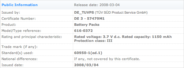

Brando also claim to have 1400 mAh replacements (which is clearly marked at the top right of their battery (Pic 3)
Finally iPod Juice claims to have a 1400mAh batter for BOTH the original iPhone & iPhone 3G. (Pic 4)
Hard to tell which is the real thing with all the discrepancies
