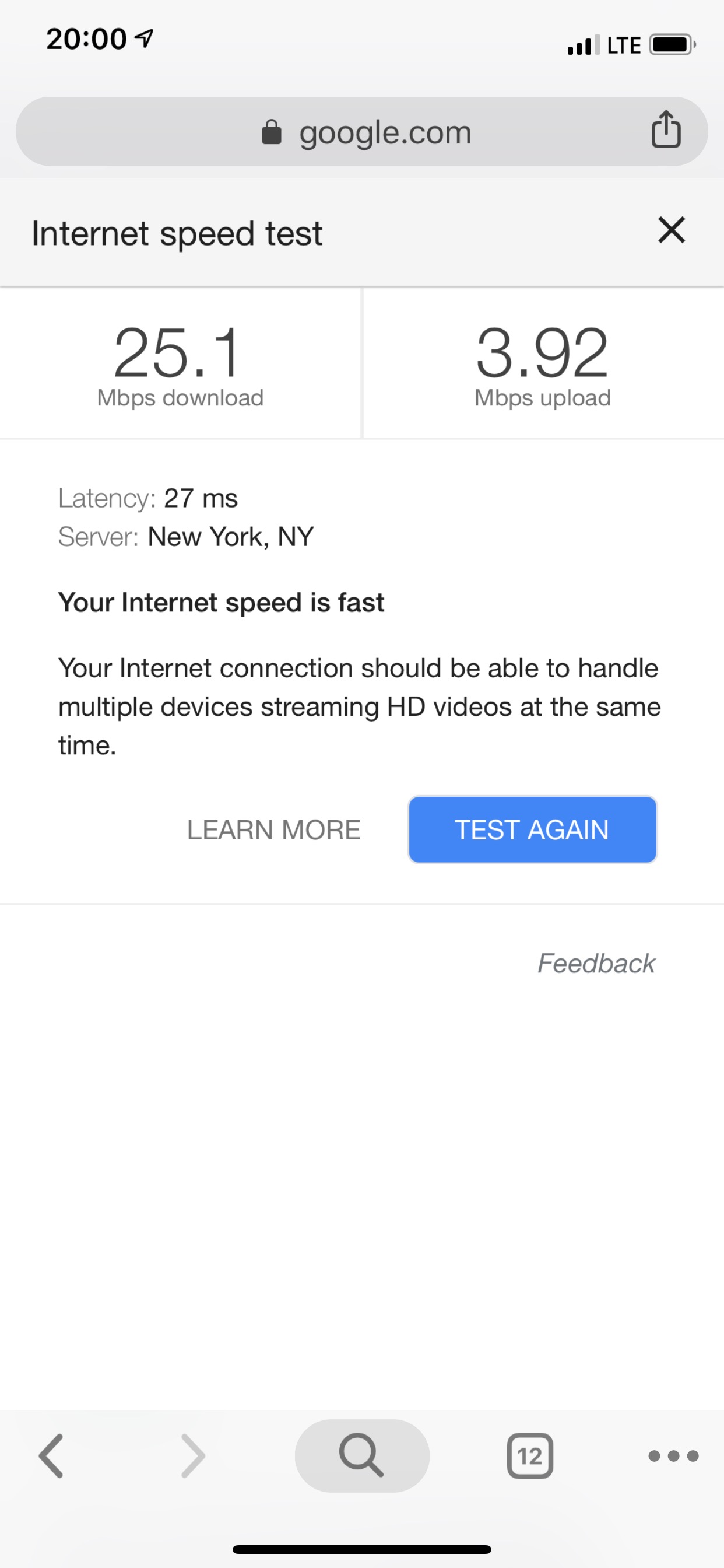

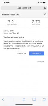

Did a test today where I literally stood next to my friend who also has a XS Max 256GB (even same color) on AT&T (same carrier) and did several speed tests (we had the exact same number of bars...and did it without cases to control for signal variability). He got 25mbps download every time and I got 3mbps every time. I also max out at 3mpbs download for LTE every single time I run a speed test no matter the location or level of signal.
This is also my second XS Max 256GB that has maxed out at around 3mbps for download on LTE for every speed test no matter location or signal level.
That’s interesting. Connected to same server?
Yes...I just posted screenshots above.
Different plans? Post vs prepaid?
Both prepaid, but I have a legacy unlimited plan that has carried over from the Cingular days. My last several generations of iPhones all had excellent LTE speeds (and my iPhone 8 Plus on the same plan was blazing fast...40-60 mbps 2 weeks ago before upgrade/trade-in), so I don’t think it’s a plan thing.
