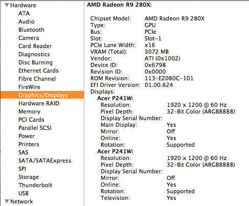

Okay, I flipped the switch and it booted up as you said and says HD 7xxx and if I go to "PCI Cards" it says "There was an error while gathering PCI card information." So, that's good news? Is there a step now to test the firmware?
Btw... here's more info on that:
I have the same performance as before. Also, I didn't mention this but in addition to the tearing, the video looks really bad while playing, not smooth, you see rough edges on everything. It looks beautiful on a still frame though.

Device ID 6798 is there, it's ONLY for the video part of your card, not audio.

I see now the device ID is different on the video section, thanks.
