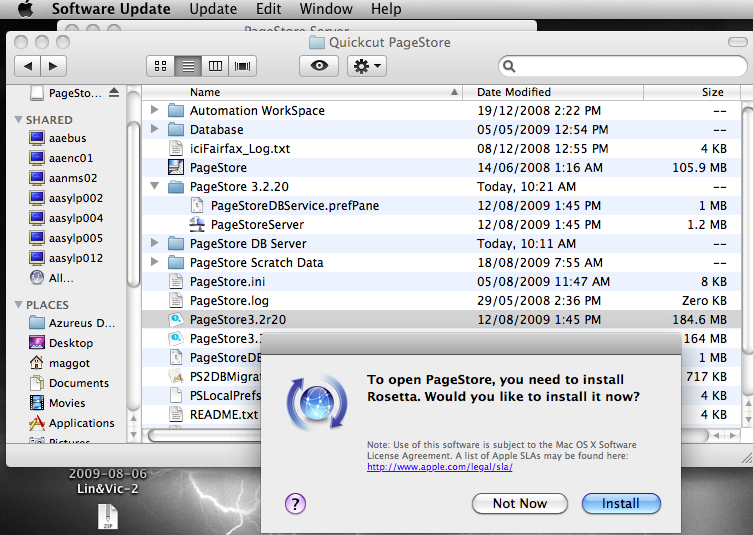

Actually this procedure does work. I have tested it and for anyone wondering why someone mite need to get rid of Rossetta, I have to remove it as Im testing software that is supposed to be rossetta free. If I have Rossetta already installed I cannot confirm this fact properly 😀

I highly doubt your issues are related to Rosetta. Despite this, give this a shot:
1. Open Finder
2. CMD + Shift + G
3. Type in: /usr/libexec/oah
4. You have now arrived at the files you need to delete.
5. Don't worry about the InstallHistory.plist
Translate doesn't show up in your search because by default Finder ignores system files. You would need to include system files in order for it to show up in a Finder search.

Am I right that Rosetta only installs those 2 files in this directory?
To disable Rosetta, simply run the following command in Terminal:
sudo sysctl -w kern.exec.archhandler.powerpc=/usr/libexec/oah/RosettaNonGrata
To re-enable Rosetta after it's been disabled, just run the following command in Terminal:
sudo sysctl -w kern.exec.archhandler.powerpc=/usr/libexec/oah/translate
These commands set a system environment variable that tells the system which program to run when you try to launch a non-native app: to ask you to install Rosetta, or to run it using Rosetta.
