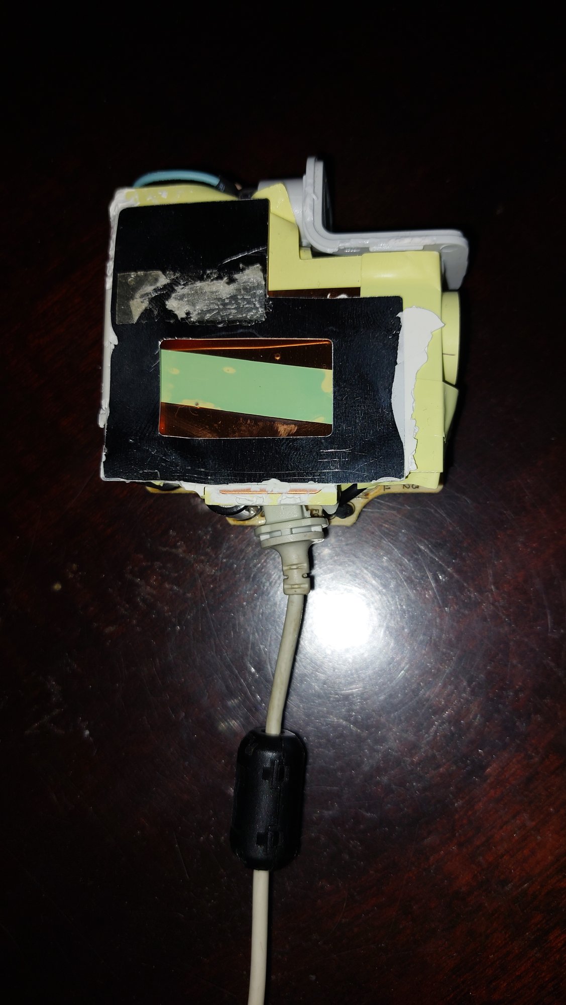

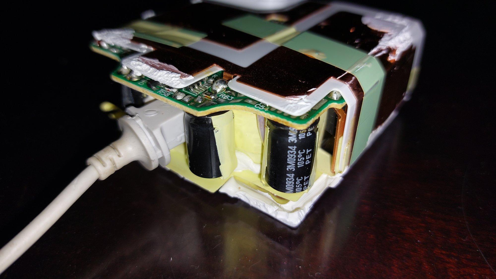

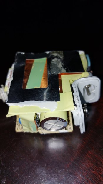

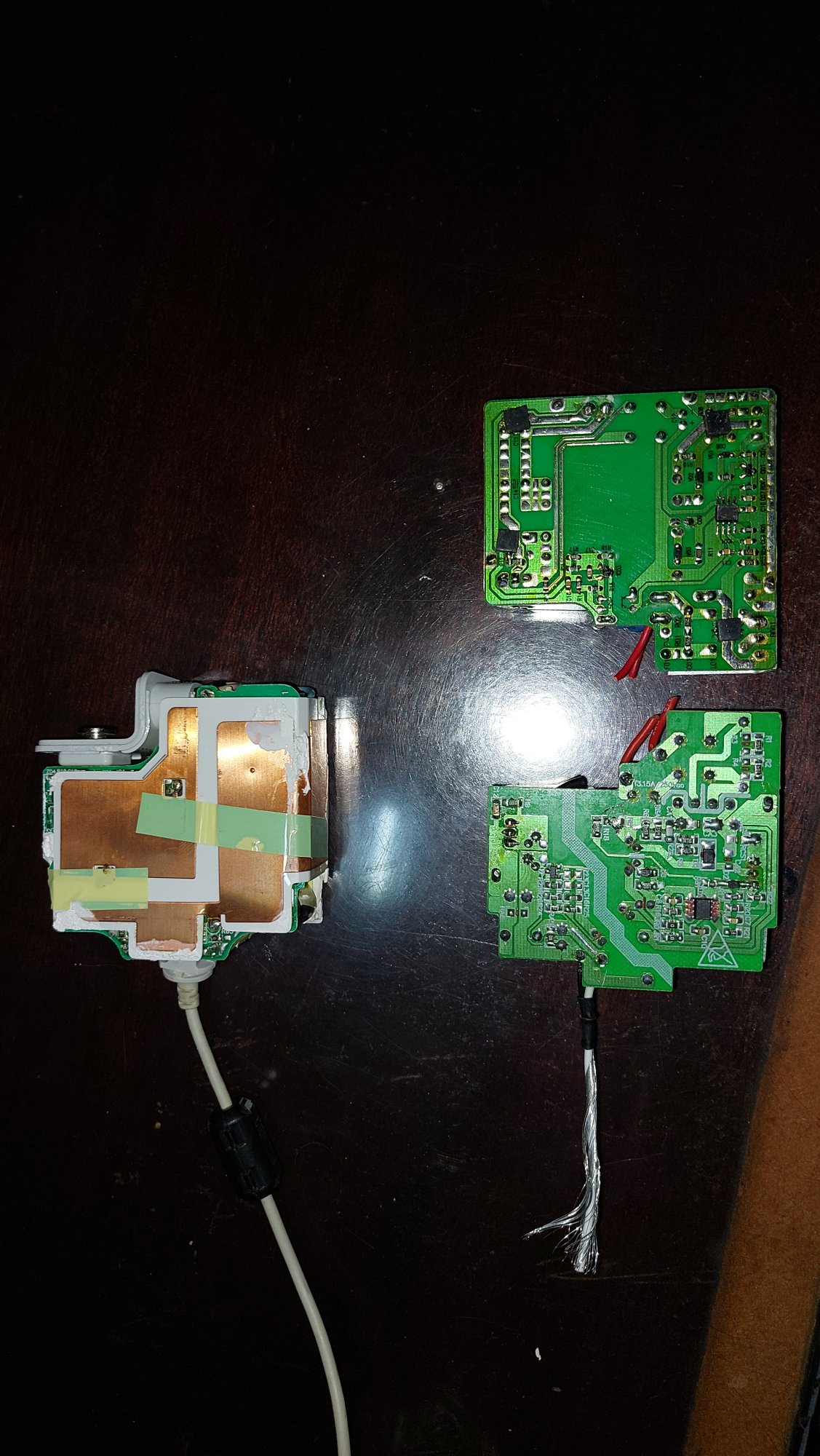

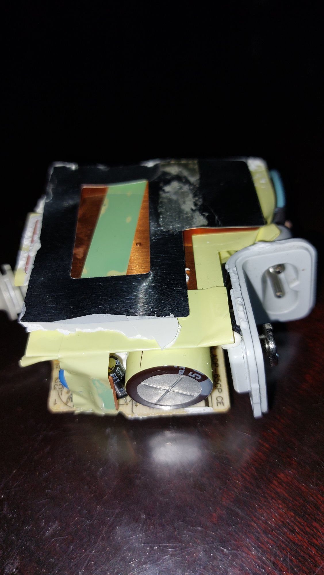

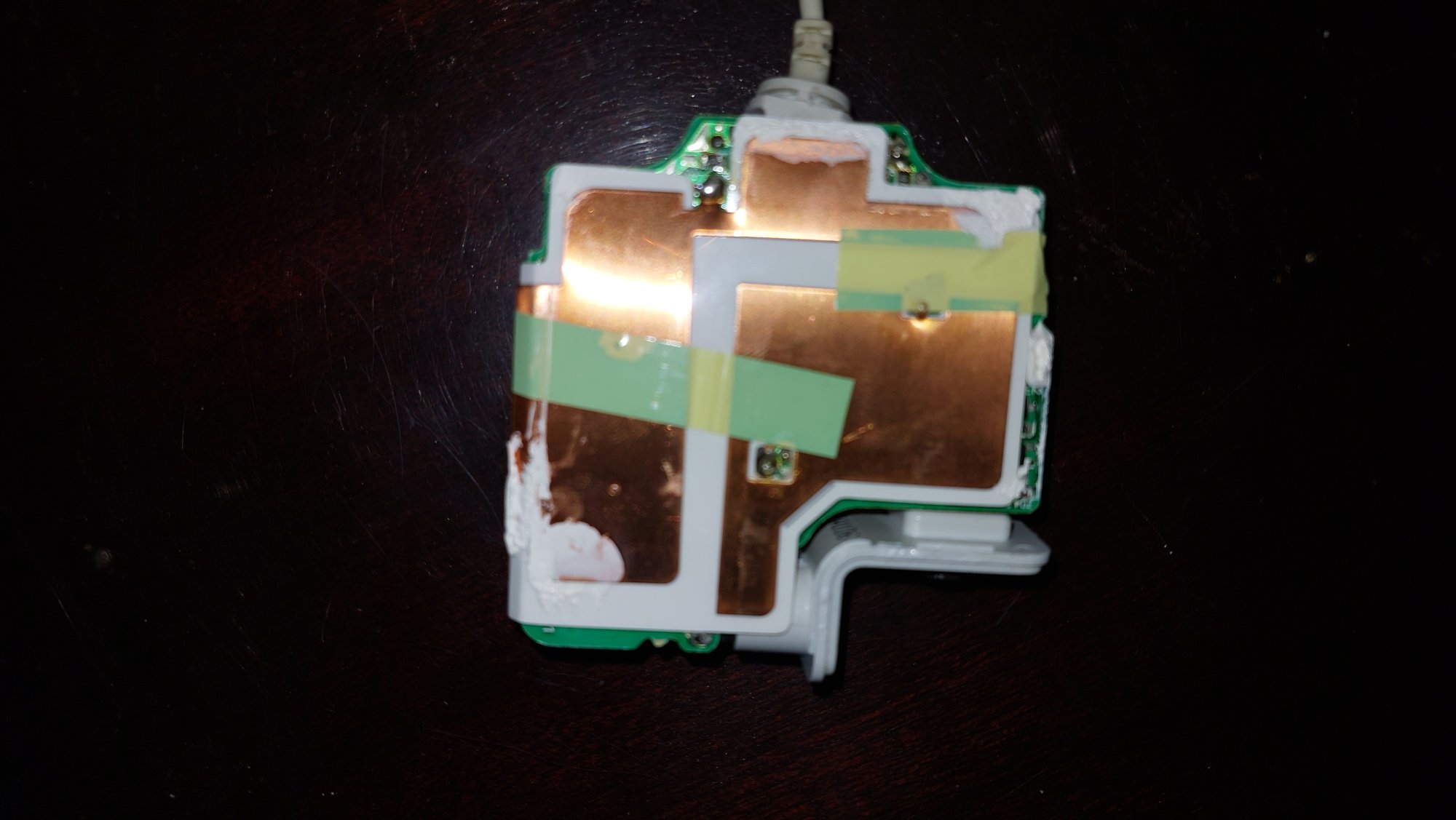

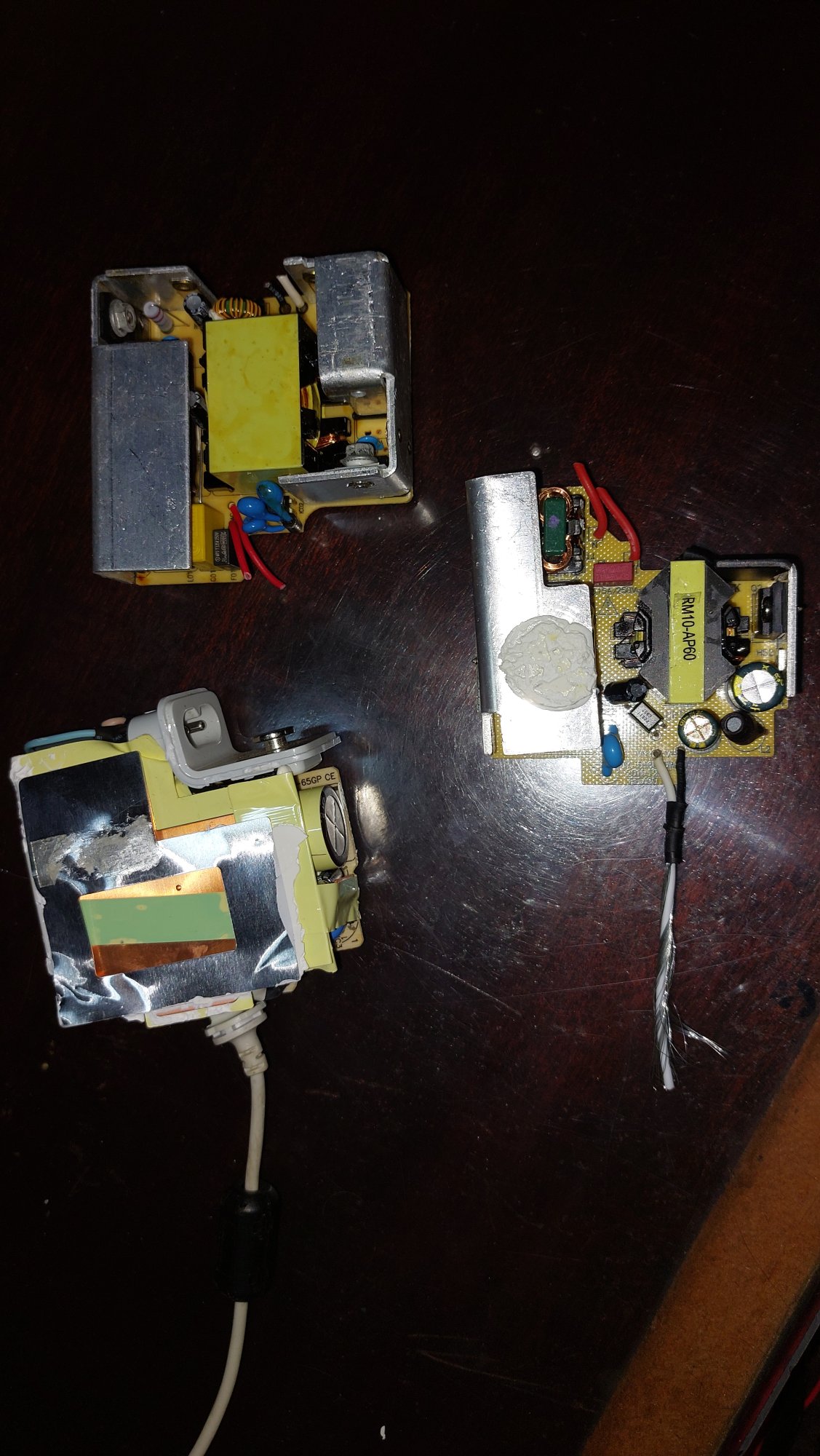

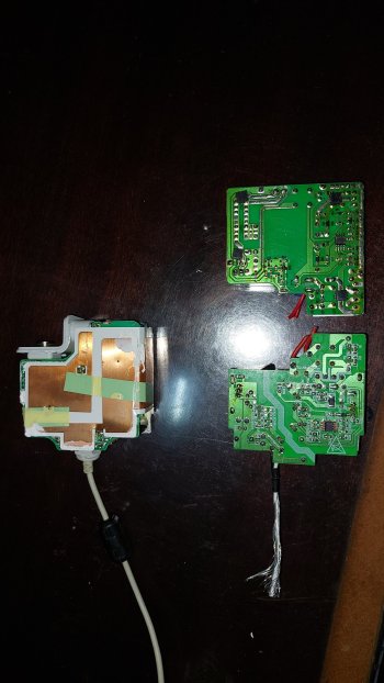

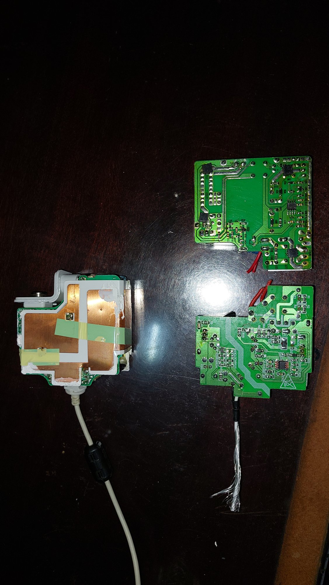

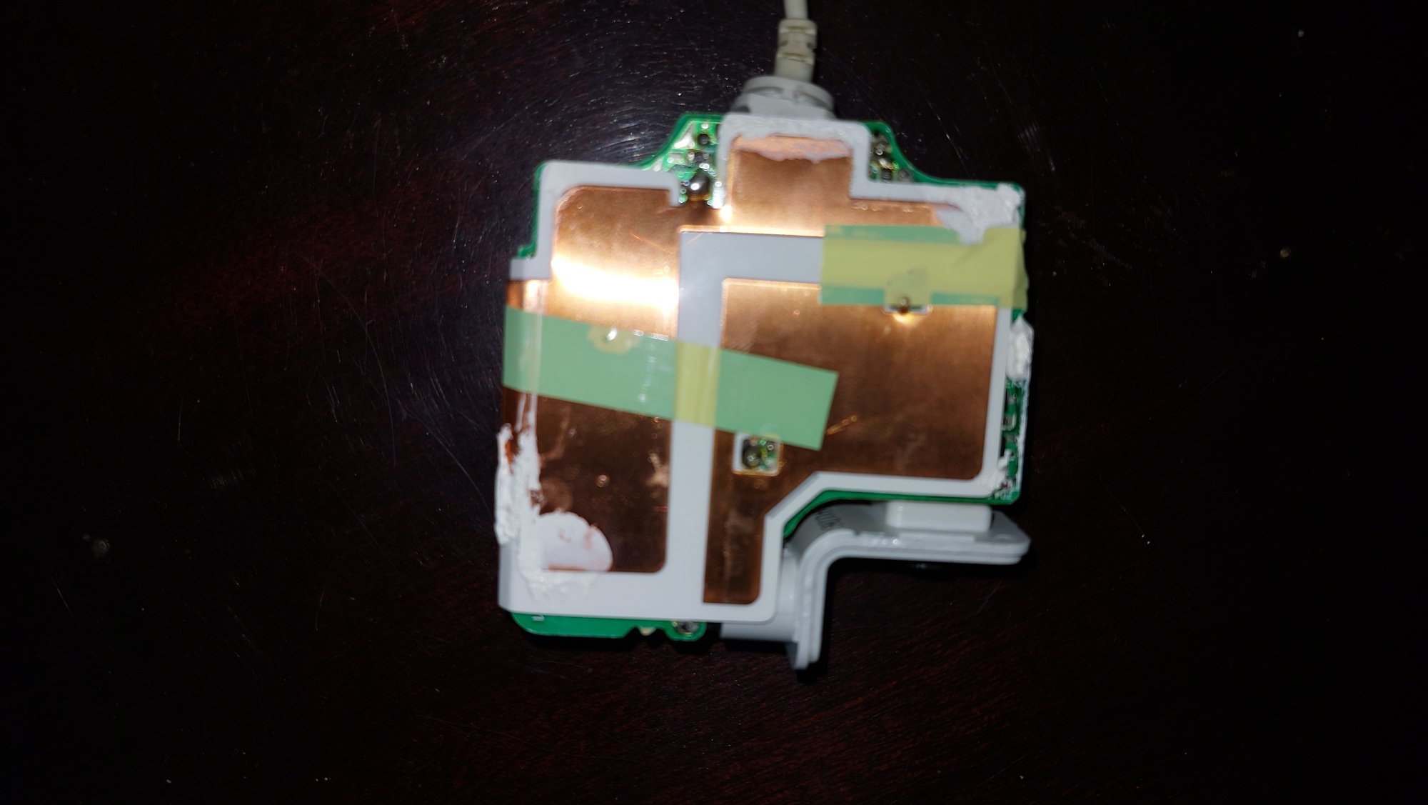

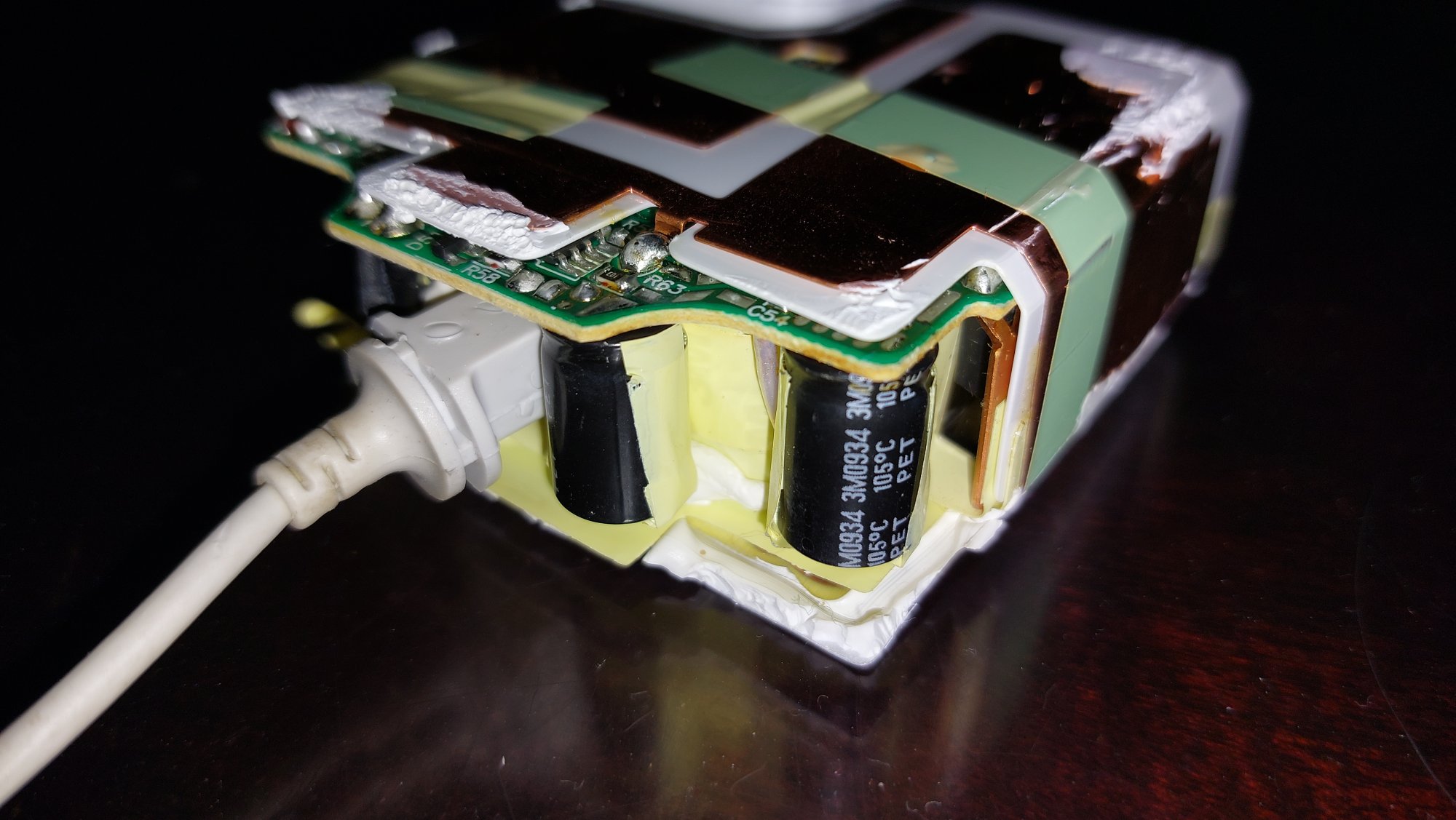

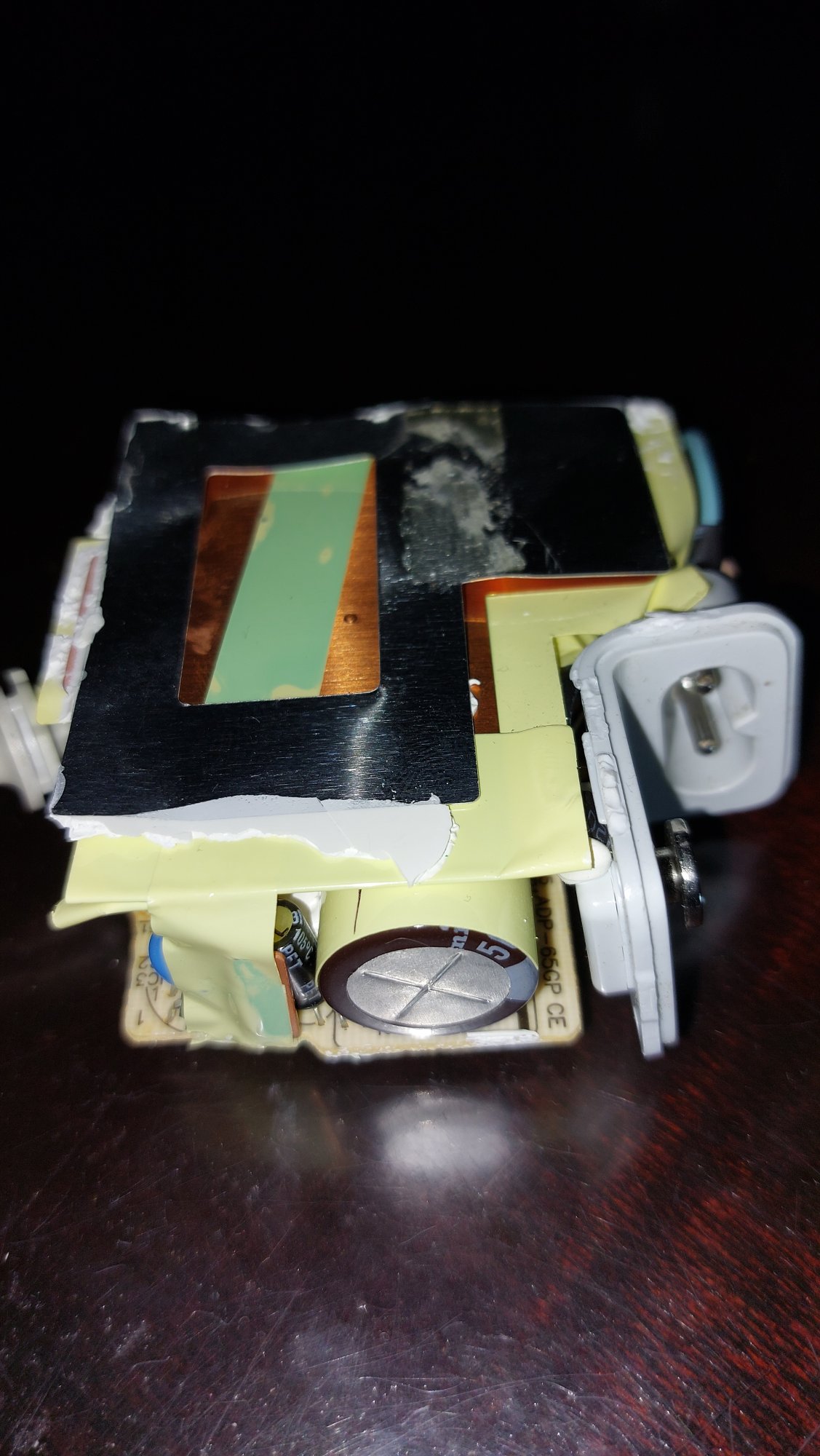

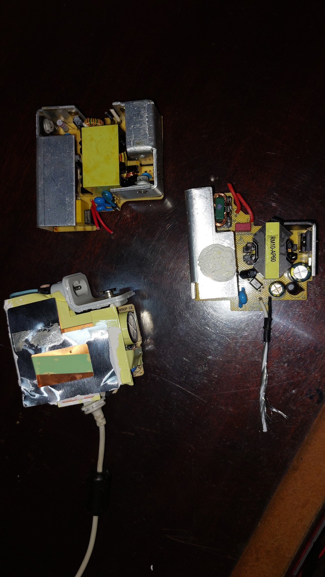

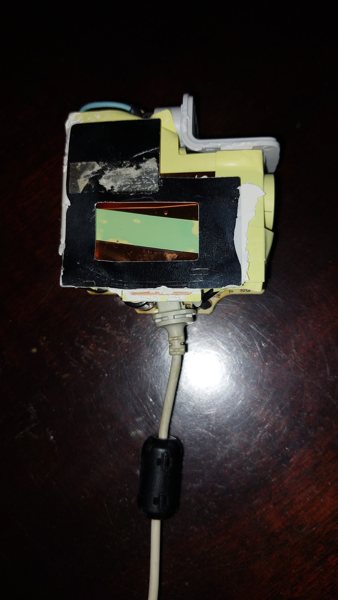

I decided to break it open and see what's inside. It was very easy to open compared to the 2 fake magsafe chargers I opened. It appears to be well constructed, it is grounded and shielded. The shielding is soldered to ground points on the circuit board so I cannot easily remove it to get a better look at the components on the board. I do not have a known genuine adapter to break open and compare but I would not be surprised if this is a genuine adapter that somehow missed the stamp on one side or if it was made on the same line after hours. If it is a truly aftermarket power supply they at least put effort into making a decent one. I took some pictures including a comparison between the PowerBook adapter and the fake magsafe chargers, the PowerBook charger being the only one with it's cord still attached. The casing is basically undamaged so I will glue this adapter back together and keep using it.
I’ve cracked several MagSafe chargers open before, and, while I don’t have pictures of them, I agree that yours looks very consistent with the Apple layout and is likely genuine.
Reactions: aurora72
Not much else to add except that in my experience dealing with counterfeit 60w MagSafe adapters, the tell-tale signs for me are the wonky (e.g. raggedy/faded) font used for the writing (though on some units I've encountered, the printing is very convincing), and the less than razor-sharp tolerances on the seams of the plastic. Most of the ones I've used don't have an indented Apple logo on the side, with the exception of a few that were trying *really hard* to fool customers.
The other tell-tale sign for me is the weight of the adapter itself; genuine MagSafe adapters, especially the old, big chonky 85w units were really heavy, no doubt due to the additional transformer and other components inside. Even the better quality counterfeit adapters felt suspiciously light.

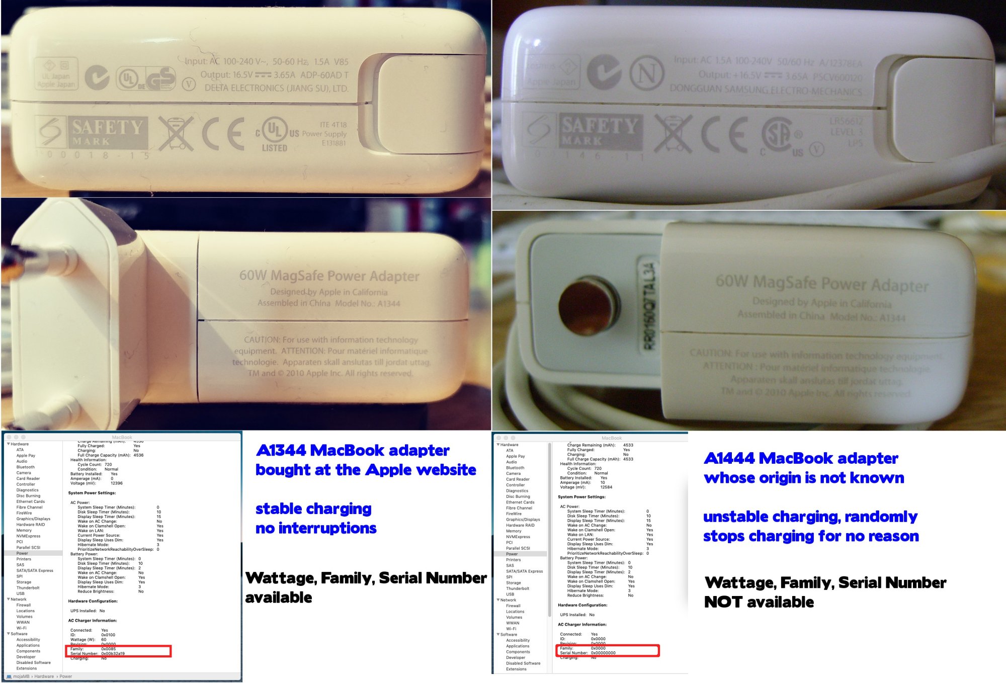

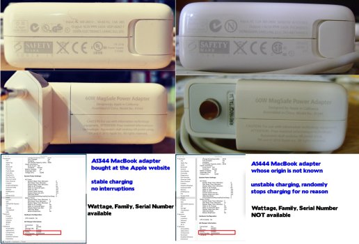

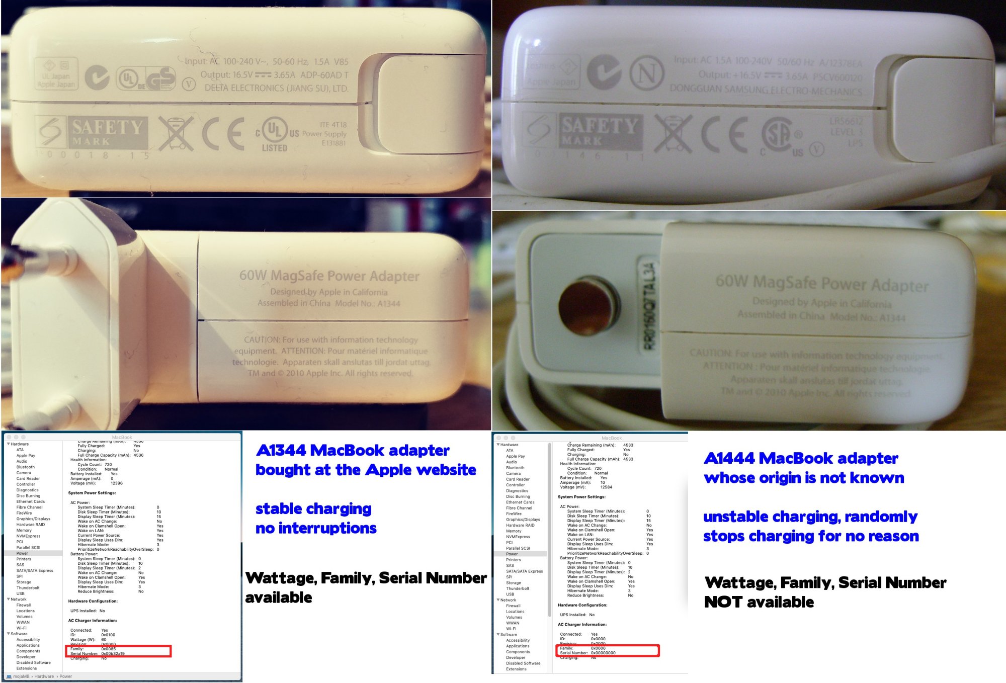

Several days ago I've bought a A1344 adapter at the Apple's website in Turkey by paying a hefty sum of money, about $97 and here is a comparison with the suspicious A1344 adapter I used previously.
The authentic adapter displays serial number on the System Preferences > Power > AC Charger Information whereas the suspicious one doesn't.
Ther serial number for the right MagSafe adapter is, literally, in view on the middle frame. And that comports with a routine Apple serial number syntax. “RR” is the same factory which also produced, at the very least, the yo-yo power adapters for the PowerBooks and iBooks of 1999–2001.
So the adapter with the serial number beginning with "RR" is an authentic one? If so, why does it display no serial number on System Preferences > Power > AC Charger Information ?
The “serial number” you’re referring to in System Profiler is a hexadecimal number whose base-10 value would still not correspond to an alphanumeric serial number mandated for Apple-related products. This isn’t to say that the presence of a hexadecimal serial is meaningless, but it is to say that that imprint may not be one used by Apple, but rather, optionally, by whichever vendor is manufacturing the power supply. That is: some may use that for internal tracking and some may not.

I still think the one shown at right, without the duckhead adapter, is legitimate, given the serial syntax beginning with RR.

The “AC Charger Information” section of the System Profiler information comes from the 1-Wire EEPROM/switch in the end of the MagSafe cable. The fact that it’s missing means that either that part is dead or the center pin isn’t quite making contact with the socket. Without that charger identification, I think a MacBook will still charge but not as quickly.
As @rampancy mentioned, Ken Shirrif has good write-ups on MagSafe chargers, including about this 1-Wire chip and what it does.
I’d be curious to know if the LED lights up on that charger when plugged into a MacBook; given that the EEPROM and the LED switch are in the same component it would be interesting if one were to work but not the other.
