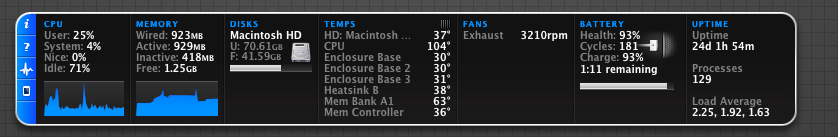

I've been running Fold@Home on my new MacBook Pro (bought it in May) which maxes my quad-core processor out. After running it for about twenty seconds, my CPU temps go up to 100C (I'm using iStat Menus). If I stop "folding" and do nothing (idle), my temps drop down VERY quickly to around 60 C.
My question is this: why do the fans cool my processor so efficiently when I'm idle, but seem to maintain the temperature at 100C while computing? Are the fans the only reason my temperature doesn't rise above 100C, or is my os limiting my processors in order to stabilize the temperature?
