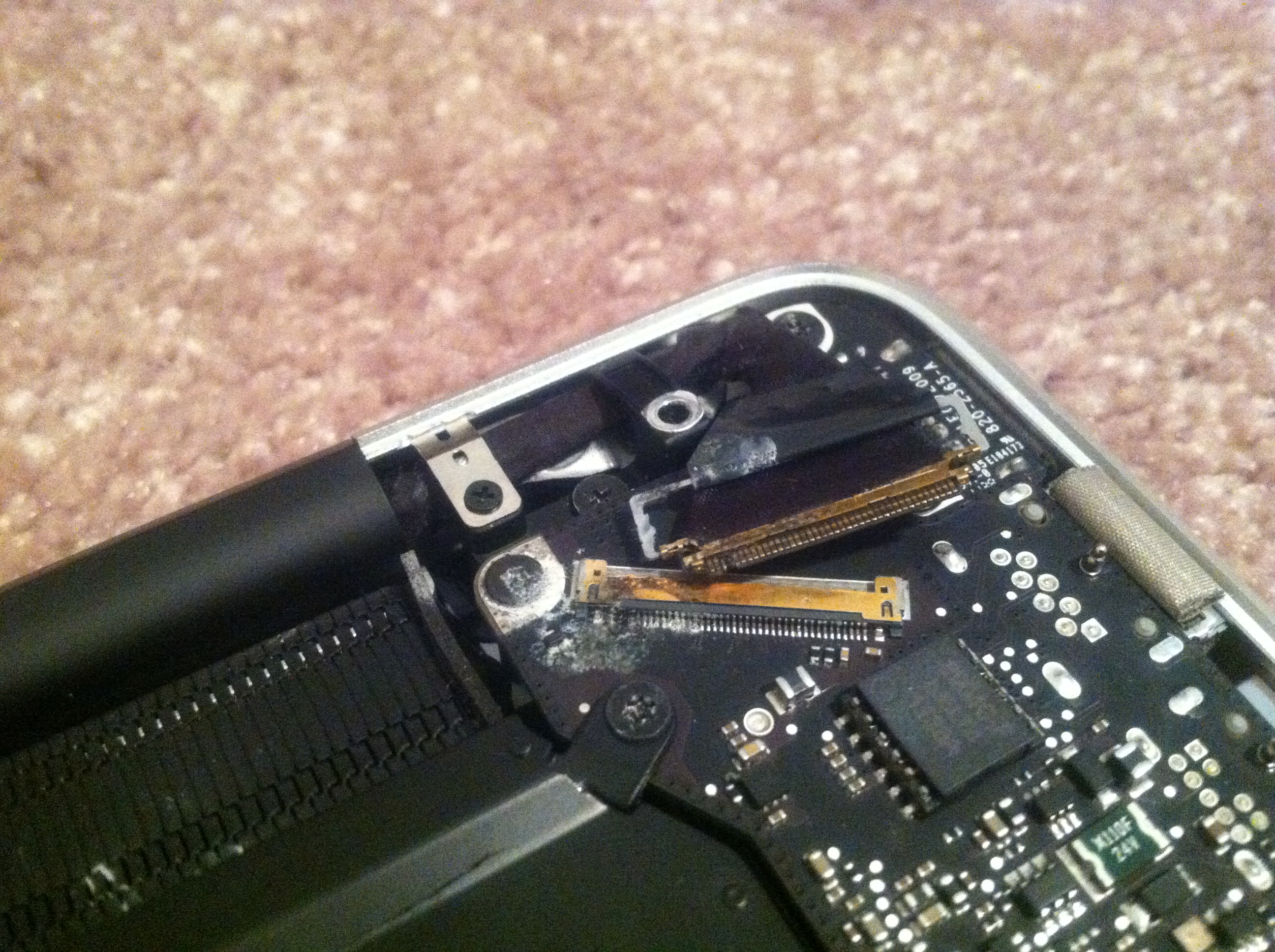

Had a house warming party last night and had music streaming through ATV. Someone came up to my office to change music and apparently spilled a Corona all over my desk, which in turn got in the gap at the bottom of the display of my MBP. I didn't know about it until someone told me my screen wasn't working. Computer still seems fine, but I turned it off right away. Took it apart today to find this... with hardly any other trace of liquid in there...
Will cleaning that do any good or is it shot?

I think cleaning it might work - but it might be hard to clean the part where the pins make contact with the connector without messing up the pins.
I'm going to run to radio shack in a bit to pick up some cleaner... here's the info I have thus far
When I attempted to turn it off and back on last night, without knowing it was wet, the drive would boot (HDD would fire up) sleep light would come on, and the backlit keys would come on, no screen activity.
Makes sense when I take it apart and see this.
As far as cleaning, can I use a little 0000 steel wool or anything to help, or will that be a terrible idea? I'm new to this, never had something like this happen, but I have HOPE!

No, you're likely to scratch away a component or some of the etching on the board and make the problem worse. I wouldn't really use anything abrasive at all, just some good electronics cleaner and a cloth to wipe it off.

I would use non-residue electronics cleaner, tooth brush, cotton swabs, and finish off with a blast of compressed air in a can.
that is the display connector, so it would boot but the display wont light up.

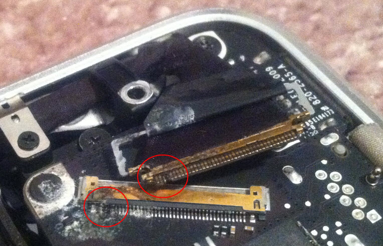

but seeing the bottom left at the logic board connector it looks fried. i'm afraid you have to change the logic board..... there is no other way around it....
Unless its just an artifact of the photo, but but it sure looks like you've shorted and vaporized at least a couple pins on the connector and the PCB pins on the receptacle.

No to the Steel Wool, or any other 'tool' that would shed conductive bits as you used it.. If it IS Beer or a Soda or any sugary liquids, then a Water-Dampened (I know seems counter intuitive with Liquid Sensors, but it is true!!) fine-bristled toothbrush will remove ANY remaining dried liquid residue faster and better than any sprays.. ** I work in the Pro Audio Industry and regularly have had to do such things with VERY expensive items.. ** Just clean a bit and remove any loosened pieces of dried-poop by rubbing bristles on a clean damp rag.. Go Slow..
Clean and re-damped the brush as it looks like needed, and repeat until nothing comes off as you work.. Slowly.. Then proceed with some Contact Cleaner: CAIG is a great company, and their cleaners are sold in many larger music stores, as well as Electronic Service Shops across North America.. Just tell someone you are cleaning Gold Contacts.. Again you can Spray Lightly and Brush Gently to work it in.. ** GOLD is a very soft metal, and is very thinly applied, so Play Nice!!
You may resurrect it, wouldn't be surprised, but this is The Only Way I am quite sure to proceed.. That being said, all the items in that area appear to be Surface Mount Technology and attacking a repair on it without the proper Hot Air Soldering Station would be impossible.. Good Luck!!

Cleaned the area shown in the picture, forgot to take a current state photo, but 99% of the noticeable gunk came off. Hooked everything back up and turned it on. Could hear the drive working, keyboard lights up, nothing else. I reset the PRAM and VRAM, heard the two chimes, still nothing on the screen.
When I first hooked everything back up, and hit the button, I swear I saw the faintest flicker in the screen, but that may have just been my hopes.
Now, the next issue is that I have to get a different external display adapter to make sure this thing is still working. I can get a cheap one from Best Buy and hook it up. How do you suggest I go about mirroring the external display? Or can I just close the lid and it will default to the external? Is there a shortcut maybe?
That thing is toast

If you close the lid when you have a monitor/USB keyboard + mouse plugged in, it should disable the internal display. I take it you don't have any house insurance then?
