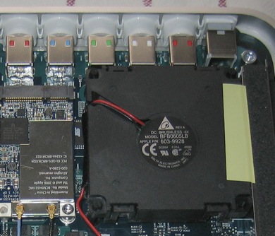

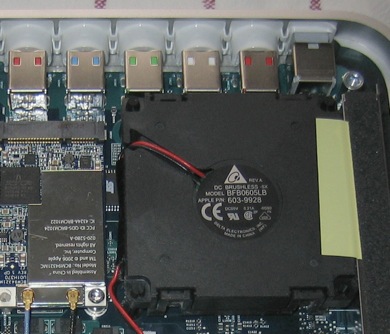

It actually does have a fan on the CPU. Totally silent - can't hear anything from outside the enclosure.

define well vented. I have mine between my DVD player and DVR but have plenty of space above it. it has1 about 1 inch clearance on either side.
So it has a fan, but absolutely no vents to allow that airflow to escape the device.
Yep - vents too. They are along the edges of the bottom, and allow air to flow between the edge of the bottom and top case. There's a space between the edge of the bottom and the top cover. Sorta hard to picture from the image, but you can see the slots along the left and right sides of the cover.

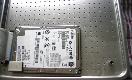

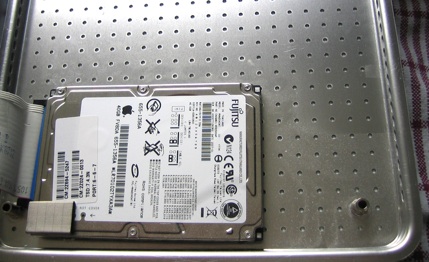

(the two images I posted are of my own :apple:tv, when I had it open to upgrade the drive from the 40GB to 160GB last June. Ran fine until last week when the 160GB started to make "interesting" sounds. So, EARLY Tuesday morning, I installed a new 250GB WD drive - in anticipation of the now-delayed update. Still have to get RMA for the 160GB, but the :apple:tv's ready to go.)

The bottom grill of the AppleTV has holes for some heat dissipation, but you'll notice the drive is attached directly to the grill and the grill is attached directly to the aluminum casing.
