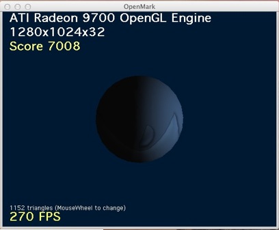

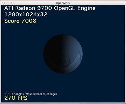

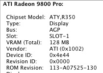

Something odd I just noticed, my Video card is reported as an ATI 9800 pro which it is, but OpenMark thinks it is an ATI 9700.
Is this normal behaviour?

Looking at your Device ID I suspect thats a PC 9700 thats been flashed with a 9800 ROM if you can post a Picture of the card it will confirm my suspicions (it will most likely have a black heatsink if its a R9700) dont be alarmed tho... flashing PC 9700s with a Modified Mac 9800 ROM is the way your meant to flash the card since the Mac 9700 ROM has issues with PC cards (the fact it cant be reduced and the PC card is VGA DVI and not DVI DVI)
It does in fact have the black heatsink, I goggled pictures of a 9700 and 9800 pro, and my card resembles the 9700 alright.
Reactions: LightBulbFun
Yeah Thats what I figured... if anyones wondering The Radeon 9700 is the second fastest card you can fit into a cube (requires a VRM move IRC tho) the Fastest Cube card is a very rare R9800 pro that was made on a R9700 PCB.... (off topic but this is my 250th post Heh)

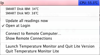

Temperature Monitor
finds and reports 3 temperatures, CPU-board, and two HDDs.
Right now in my room, no AC and approx 75 degrees F the MDD idles and pretty much stays around 55 degrees C. Thats just doing every day stuff like email, we surfing youtube videos etc.
Interesting, thanks for the info. That's higher than I would've guessed. I wonder if fresh thermal compound would help any? How hot does the CPU get with power fractal? Maybe it's not worth a test.
