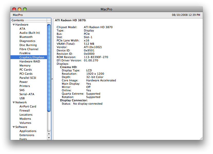

Could you do guys do me a favor post your ROM and EFI revisions from System Profiler? I'm wondering if I have an older or different revision of the card. I've attached a screenshot of my System Profiler info.
