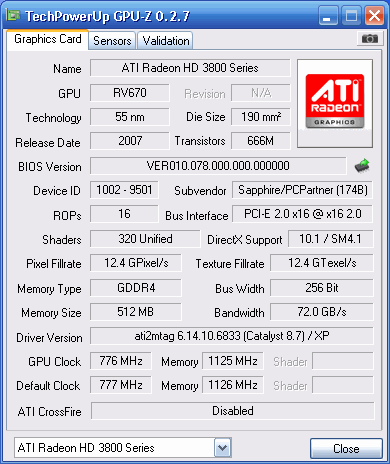

Here's a screenshot of GPU-Z running on my system, for those that may be interested:
