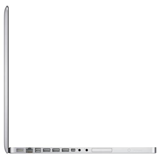

Could someone please explain how the MacBook Pro can get any thinner? Unless they remove the Ethernet port, that is the main reason why it can't get any thinner because that port cannot shrink. That little sliver of space below it is used for the battery.

That IS a lot of ports... The Air only has like 2 on each side.
So, they'll either keep the same form, or they'll make it an Air and make you buy adapters.
It makes you wonder if they make something like the MacBook Air but include a small rectangular Thunderbolt adapter on the side that includes Ethernet and USB.
I wonder how people would feel about that...
Also, like the current Air's, they could make it non-uniform thickness.
If you put the ethernet all the way in the back, and then tapered the thing down to almost nothing, you could easily save 1/2 to 1/3 the volume.
Or, with thunderbolt being what it is, make a TB adapter that gives you Ethernet/FW800/USB, and have 2 ports on the side, like a current MBA.
They can definitely shave of something off the lid. There are lots of notebooks out there including the air with thinner lids.
Currently the hd bay has 12.5mm space. If you limit that to the minimum you can remove 2.5 mm add 2 mm of the lid. You you'd be at 2cm instead of 2.5 and that isn't yet limited by the optical bay thickness.
Removing the optical bay frees up space for battery, bigger cooling fins, fans bigger in diameter to make up for thinness. Or more logicbay space.
If they limit HDDs to 7mm you could make it even smaller but I doubt that is feasable because even without the optical bay there would be enough space left for a big enough battery to power a "powerful" notebook for a long enough time.
Also shrinking the cooling fins to that height would probably not work and making them deeper doesn't help all that much usually because it kills air pressure.
I think 5mm thinner is realistic everything else not so much. It is not dependent on the optical bay thickness but only freed up space.

There are lots of ways to make the current 15" MBP thinner. Remove the opitical drive, remove the ethernet port, and distribute the rest of the ports on the left and right side of the keyboard. Limit hard drive size to 9.5mm. Move the hard drive/battery under the keyboard. The shape will probably be a wedge shape like the current MBA.
Move the NIC and FW800 to the back left and right sides and then you can shrink from there, making the thickest point only as big as a NIC port.
Then you just organize the ports by size going down the side. That lets you still get a wedge shape and keep the ports while also still being slimmer.

They could always remove that pointless round part at the bottom and make the bottom lid flush with the case. If they wanted to make it even thinner, they could just remove uncommonly used ports and make adapters.
