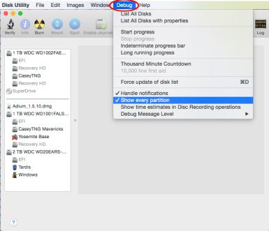

I have another idea that may work. Boot normally then run this in Terminal to enable debug mode for Disk Utility. Then start Disk Utility and see if you can remove the recovery partition completely, then resize the main volume to take over the free space.

Used that command but i don't see recovery HD in disk utility :\

Just did that. Nop. Still doesn't work
Hmmm... after running the command can you see this Debug menu in Disk Utility?
